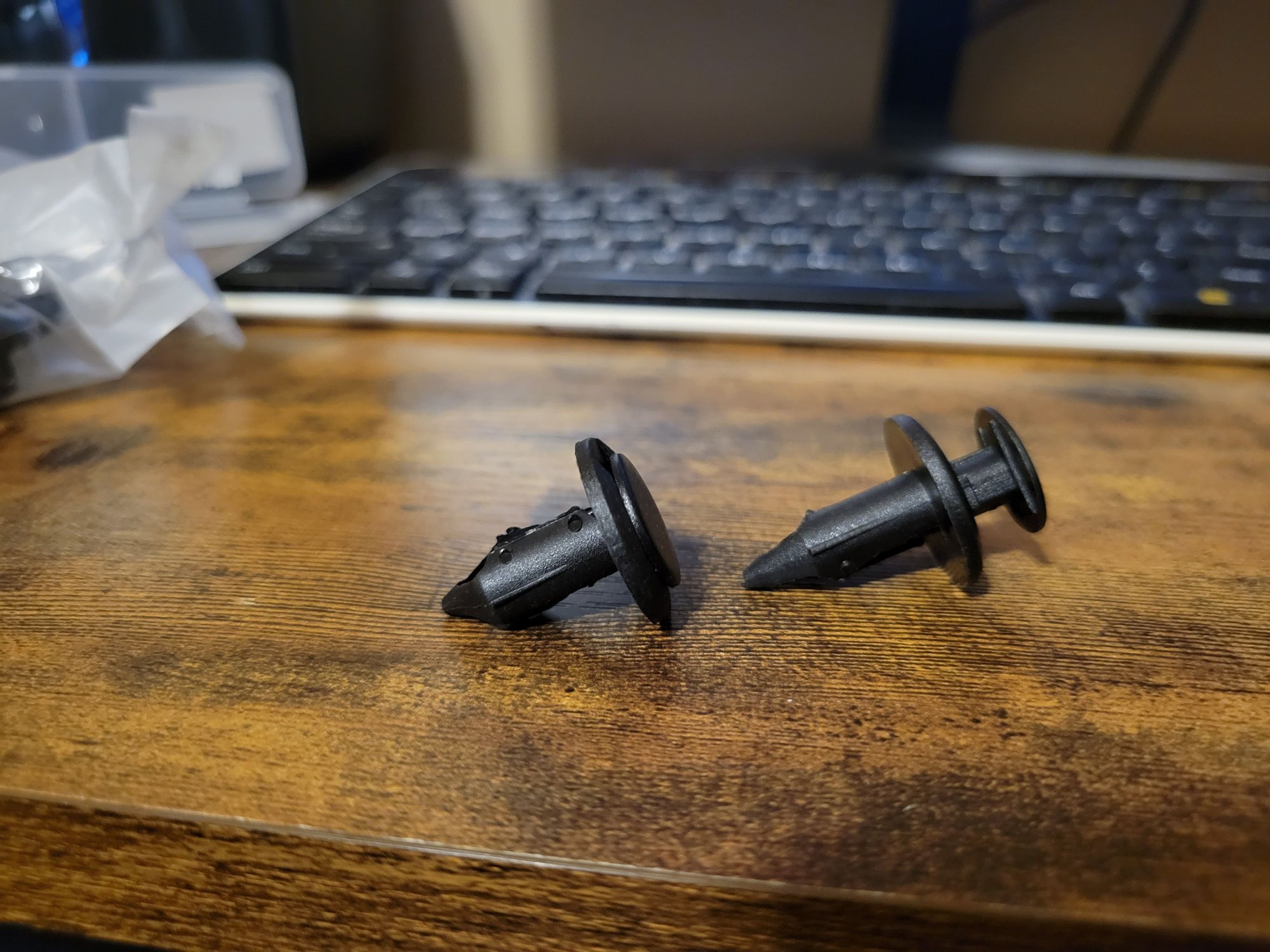

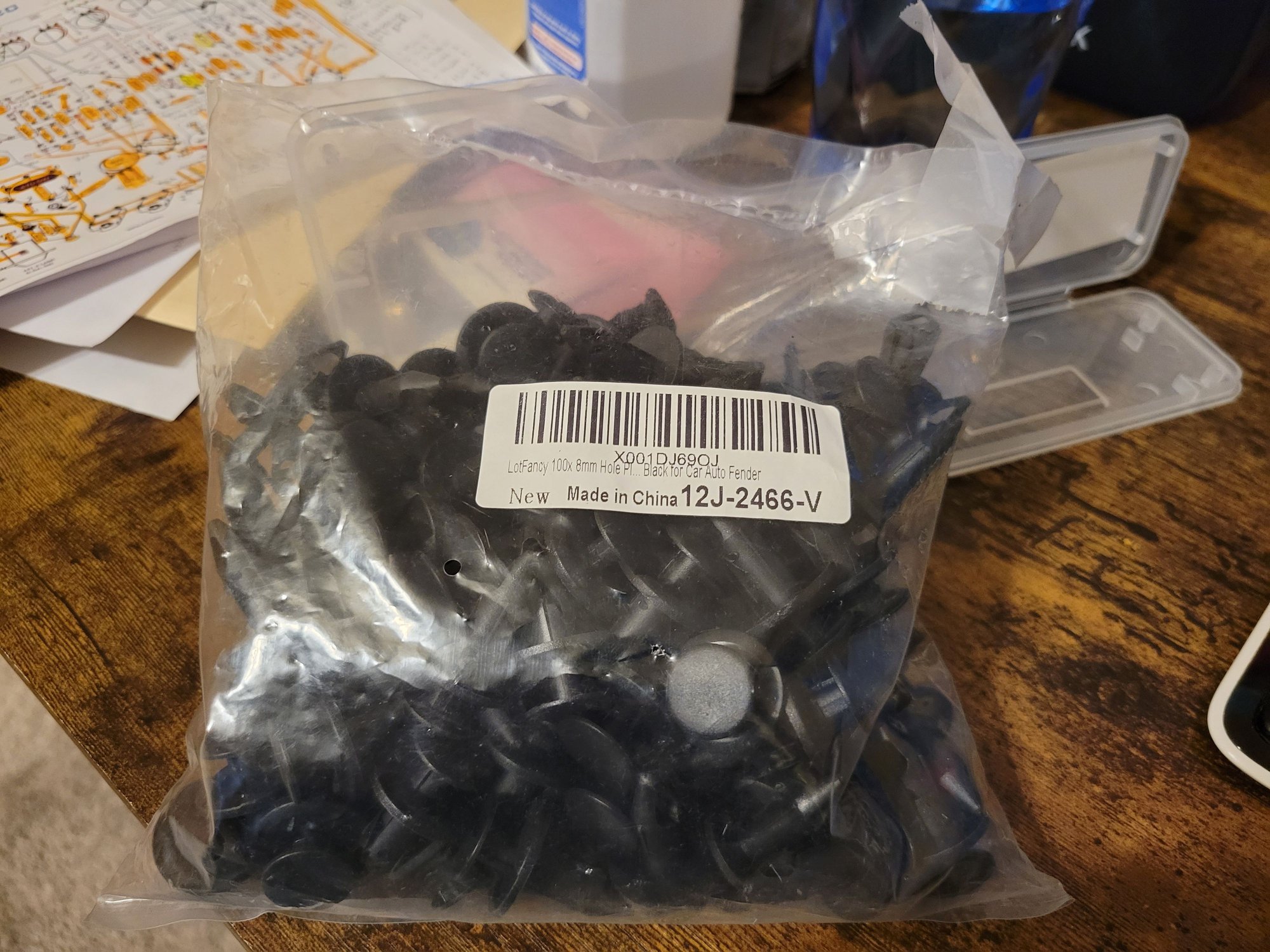

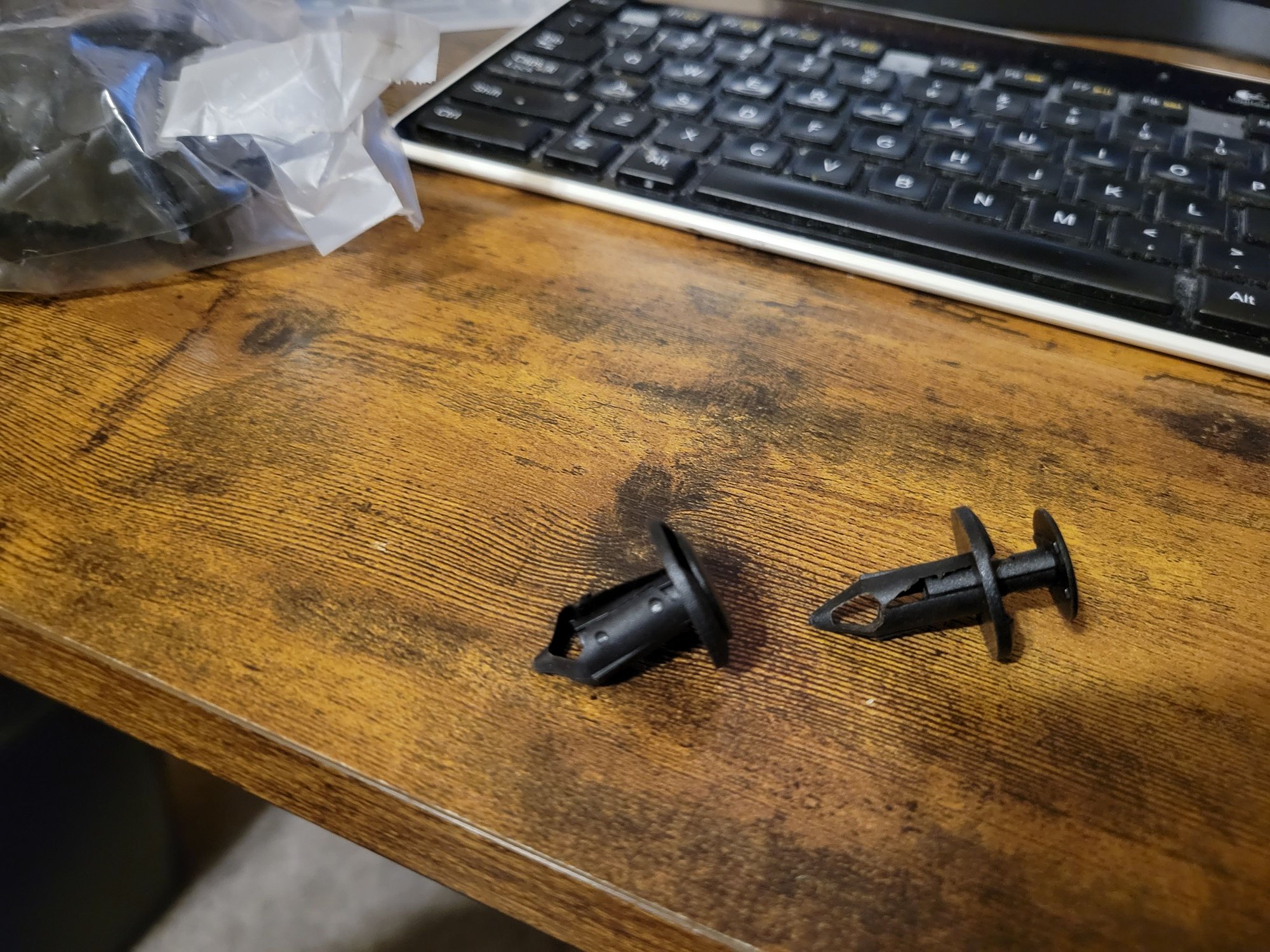

For the spoiler you can use plastic scrivets in place of the metal rivets. I did that once. They're easier to remove if the spoiler needs to be replaced again, which is likely.

Do you recall the size/type you used? Amazon is full of different types...

The exact ones I have are discontinued but these are almost identical. 8mm diameter. I had to drill the holes out slightly but these scrivets were very stought and it made the spoiler solid. Too bad you didn't leave close or I'd just give you a handful.

Thanks for the update! I'll try your suggestion.
