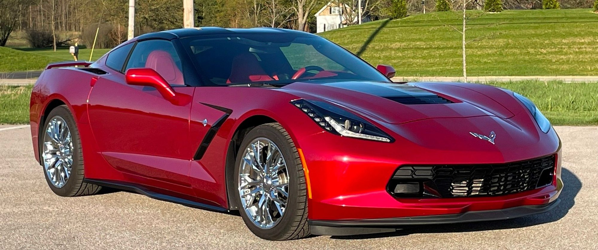

14point5's Avatar
14point5
Cruiser
Veteran: Marine Corps
Joined: Sep 2021
Posts: 497
Likes: 616
From: NE Ohio
2025 C7 of the Year Finalist - Modified
2024 C7 of the Year Finalist - Modified
For base model 2014-15 Stingrays with those 5 spoke 18/19 wheels, they just scream "early" C7 and I wanted to modernize. I also updated the Bose audio system to support Apple CarPlay and replaced the steering wheel to get the flat bottom style like the 2016 and up cars.
I went with Factory Reproduction (FR22) chrome Z06 style wheels in the original 18/19 size with all season Continental Extreme Contact DWS tires. The slightly larger sidewall rides well and regular body width Stingrays have no history of bending or cracking wheels like the widebody Z06 and Grand Sports.

Originally Posted by Catfish4818
^^^^Looks like your car has the 'high-wing' spoiler. Those are cool.
Good eye
