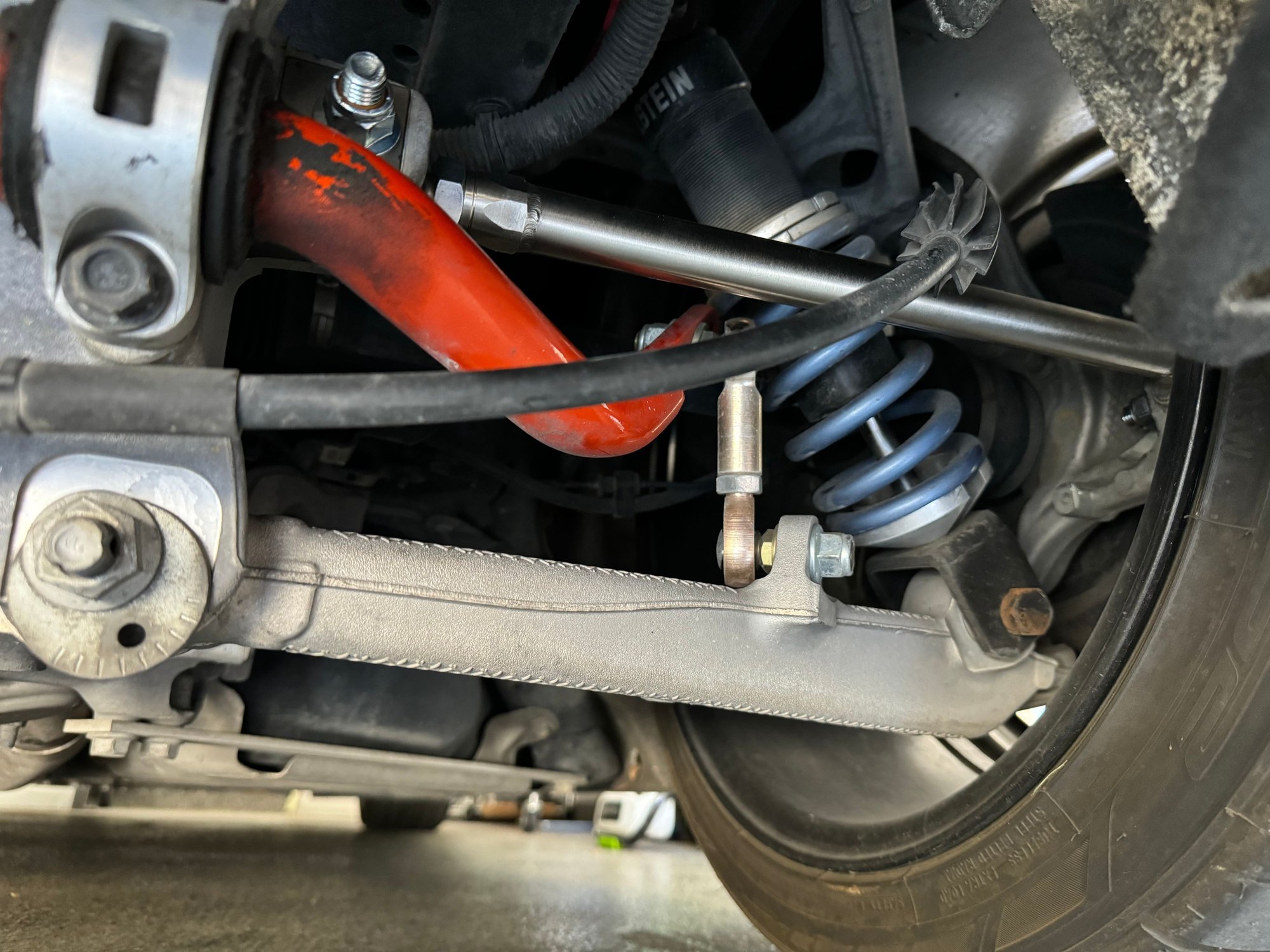

Originally Posted by TxLefty
LG would be another source for information and parts.
Second this. If you go with the G2 from LG, they’ll even valve them to your application. Decided to go with the street valved G2’s on my setup and couldn’t be happier.
