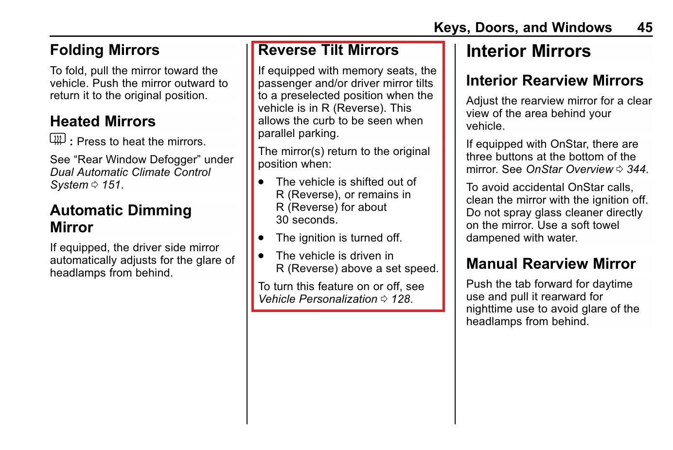

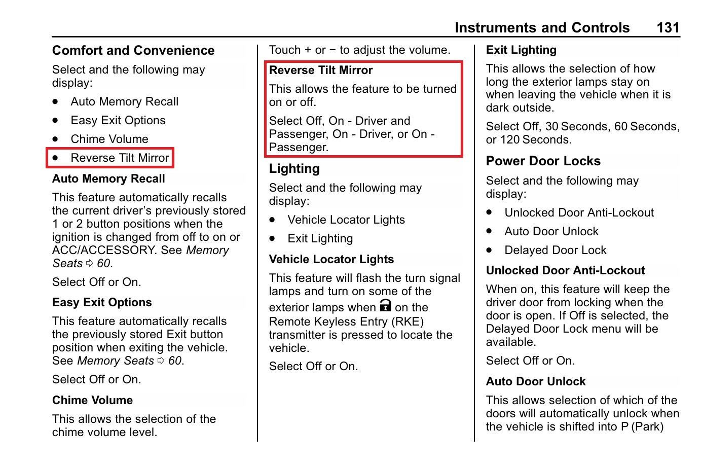

Not sure about the 2016 MY but, according to pg 45 in my '19 Owner's Manual, Reverse Tilt Mirror functionality can be adjusted via Vehicle Personalization...
Vehicle Personalization begins on pg 128, but Reverse Tilt Mirror adjustment is described on pg 131...

Grab your 2016 owner's manual and turn to page 131 and find the "Vehicle Personalization" section. The section describes how to work your way through the menu to change settings to your liking. I believe you will want to choose "vehicle" then "comfort and convenience" then "reverse tilt mirror".
The mirror setting that you will be interested in is on page 134 on the bottom left side of the page and is titled "Reverse Tilt Mirror". You can turn the reverse tilt mirror feature off when you find this menu option.

Thank you all for your quick responses. I found the section in my manual and will try it today. It just never occurred to me to search "Reverse Tilt Mirror", though I searched at least 10 other iterations of "mirror" without finding that.

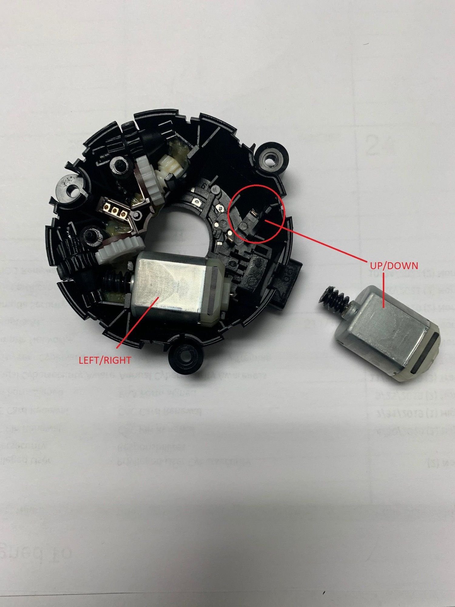

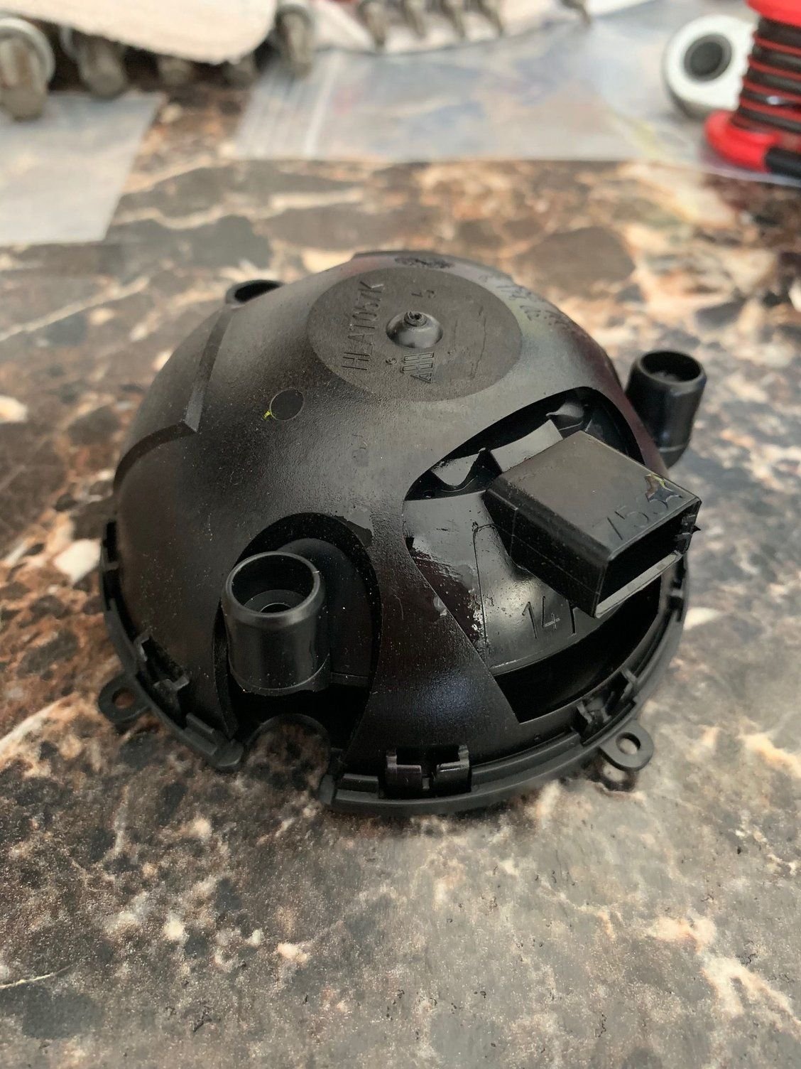

I've gone round and round with the issue on my '15. My work-around fix was to disable the tilt signals by cutting the associated pin on the actuator. I'm fairly confident the root cause lies with the memory seat module not retaining the firmware setting.
https://www.corvetteforum.com/forums...ll-issues.html
