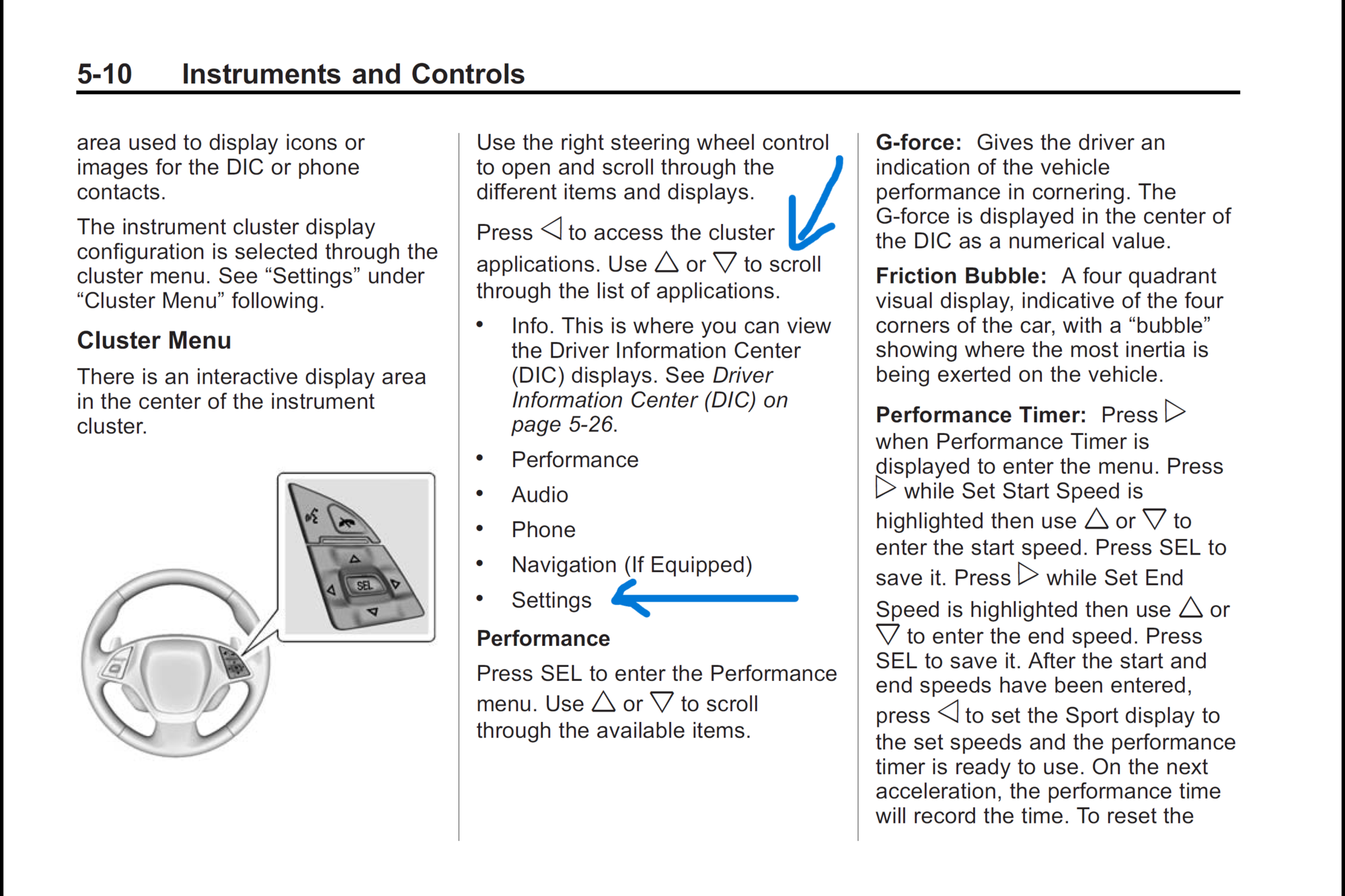

Not sure what your problem is. Have you selected which display mode or theme you want? To do that make sure the left button is highlighting the left column of the display so you can see Info, Performance, Audio, Navigation and Settings at the bottom (if you don't see that column click the left arrow several times to make sure it is displayed),
Once you have those choices Select Settings, then follow the directions in the picture below to choose whichever display mode you want.

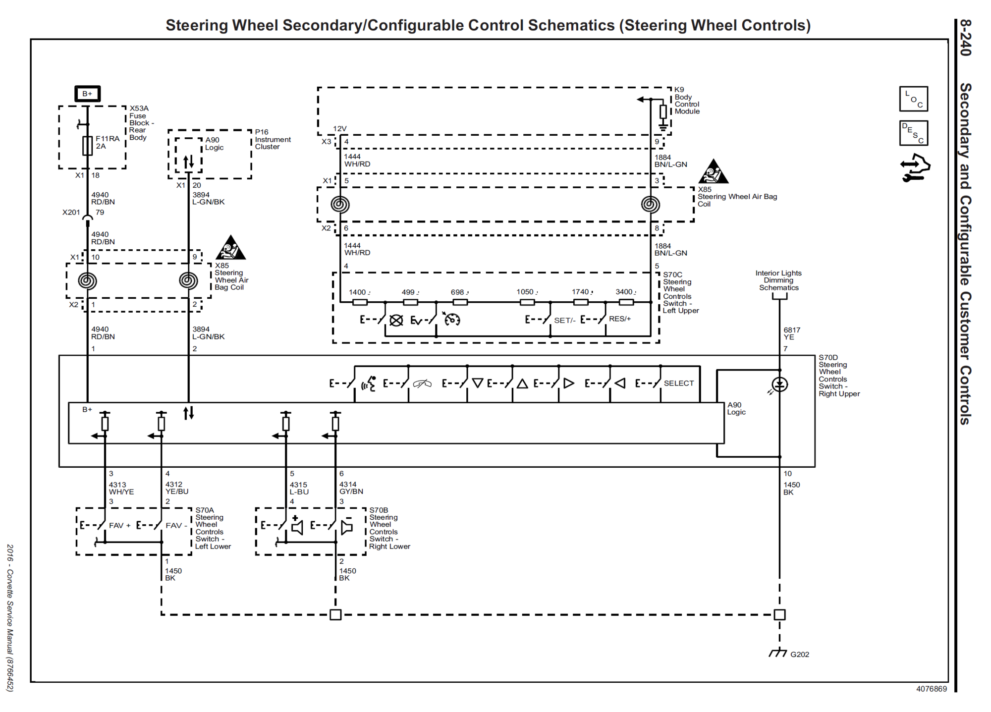

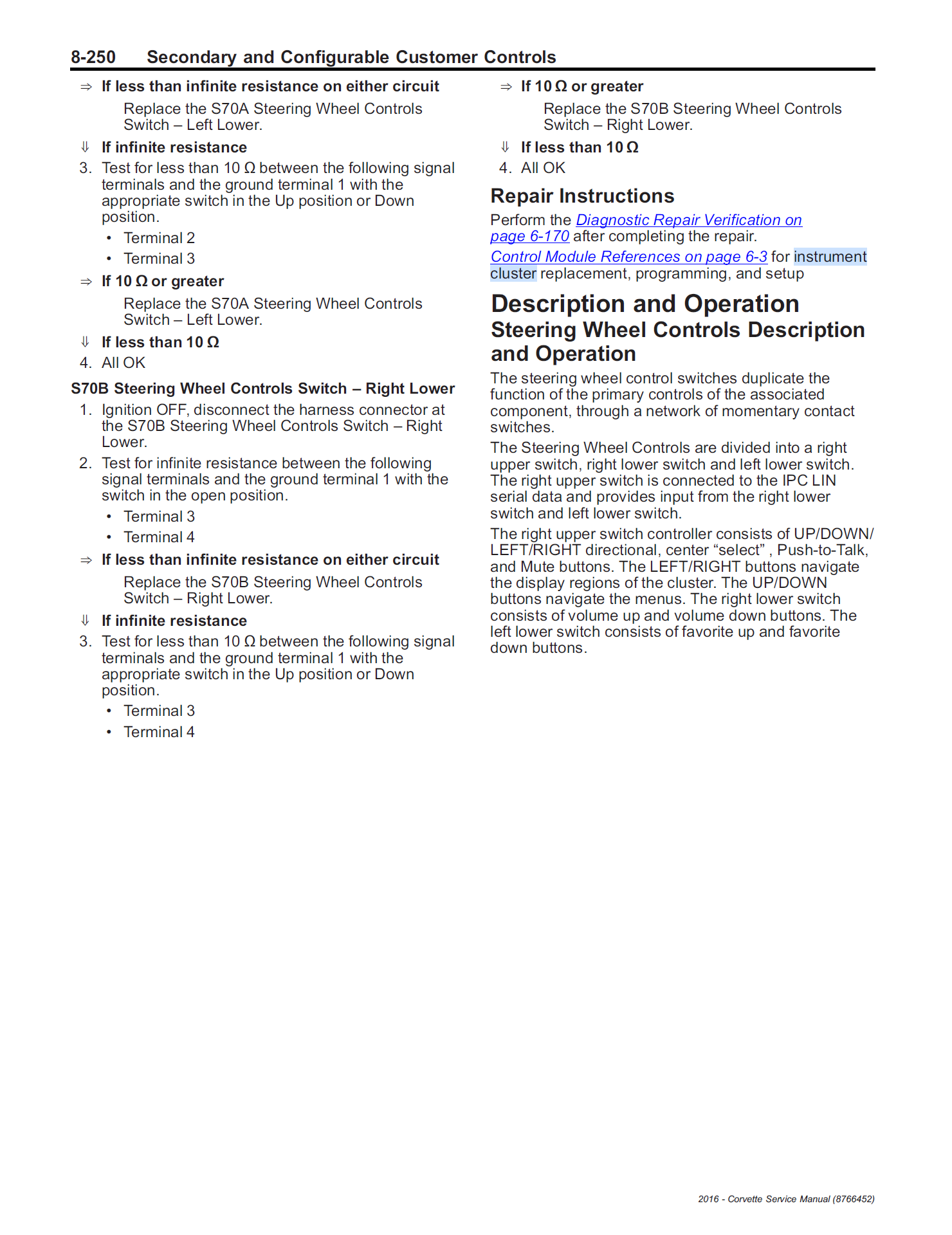

If you can't change the digital speedo reading to some other feature by using the up and down arrows you may have a problem with the switch itself. Switches are some of the least reliable electronic devices so you may need to replace a switch. I am including the diagnostic process that should be used to check the switches.
Ensure your +12V and GND battery connections are good and there is a proper +12V level being delivered to the steering wheel.
Hope this helps.
