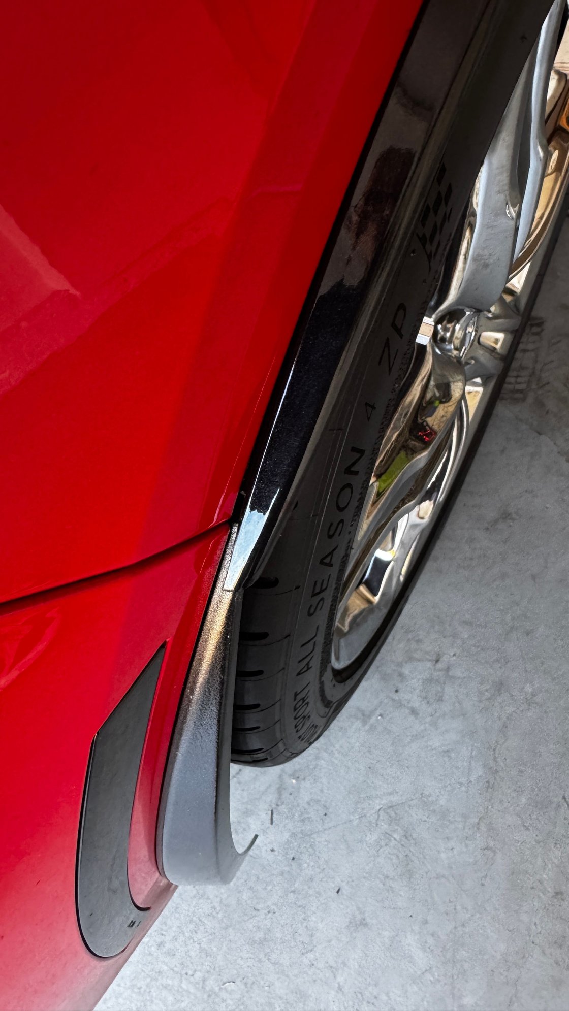

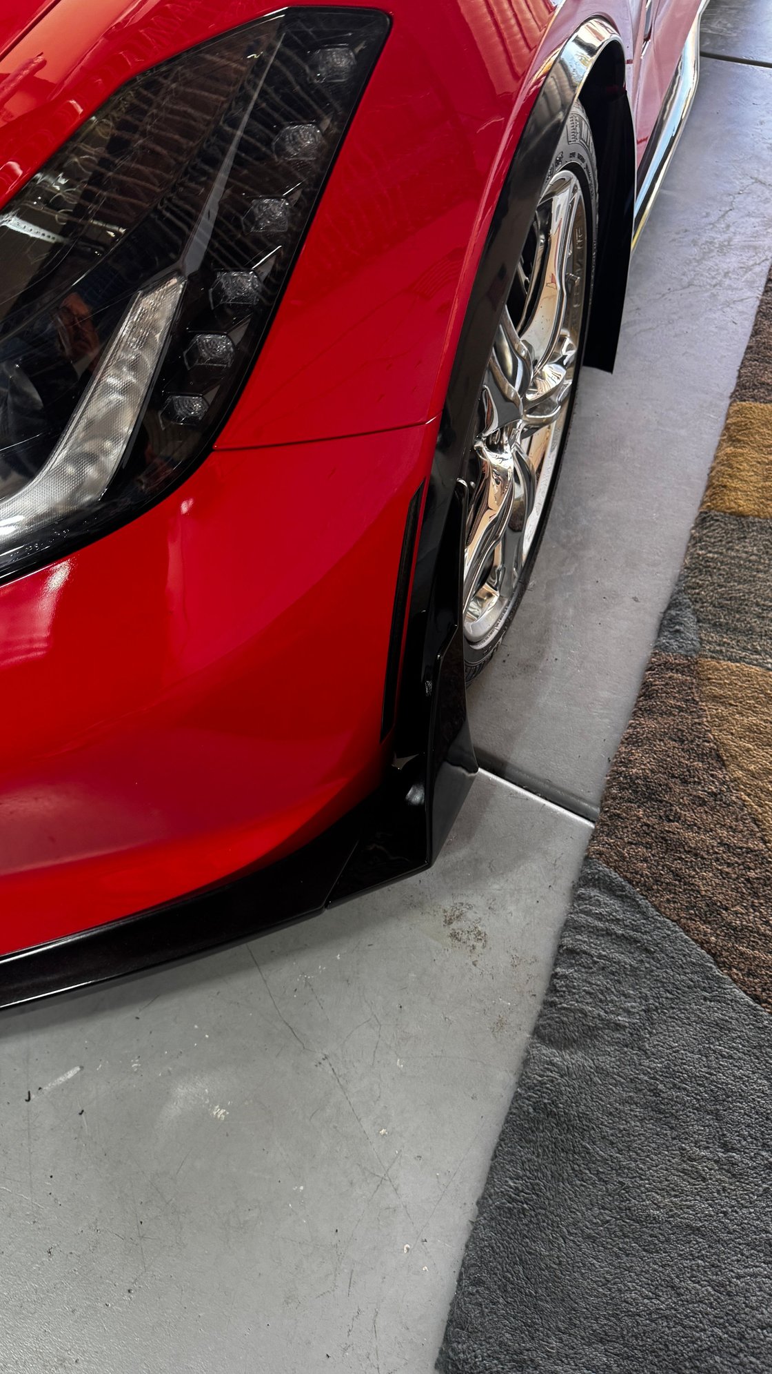

Default Z06 Wheels on Z51 Repros
So I installed the Corvette C7 Z06 Rear Quarter Extension and Corvette C7 Front Fender Flares Wheel Trim along with the Corvette C7 Extended Front & Rear Splash Guards and need to get the wheels out approx 25-30mm in front and 20-25mm. I have the Z51 18/19 wheels and also the larger Z51 brakes and want to also go 19/20 and I would probably go 255/30/19 in front and 305/25/20 in rear.
Will the Z06 wheels 19x10 Front and 20x12 in Rear. The overall responses are, they are too wide, but that is what I need. What other issues would become a problem. Thanks
