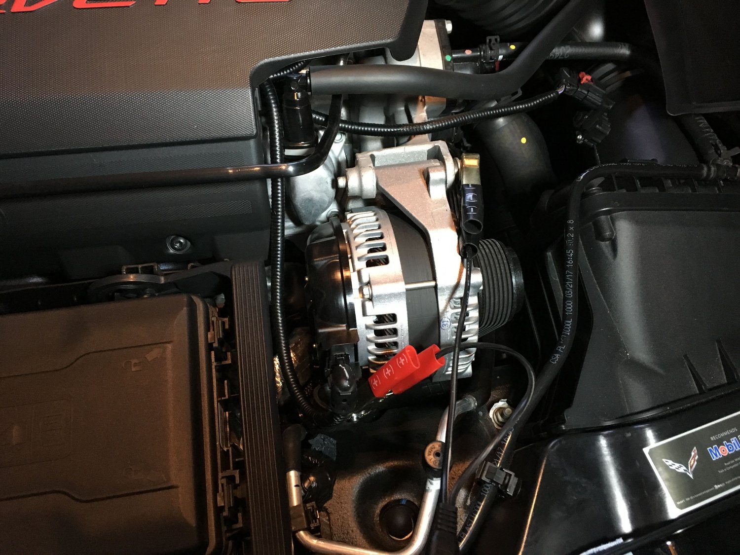

If your charger has both plug and clips, try using the clips and attach to the alternator to see if it charges better. I've been using the clips for years
