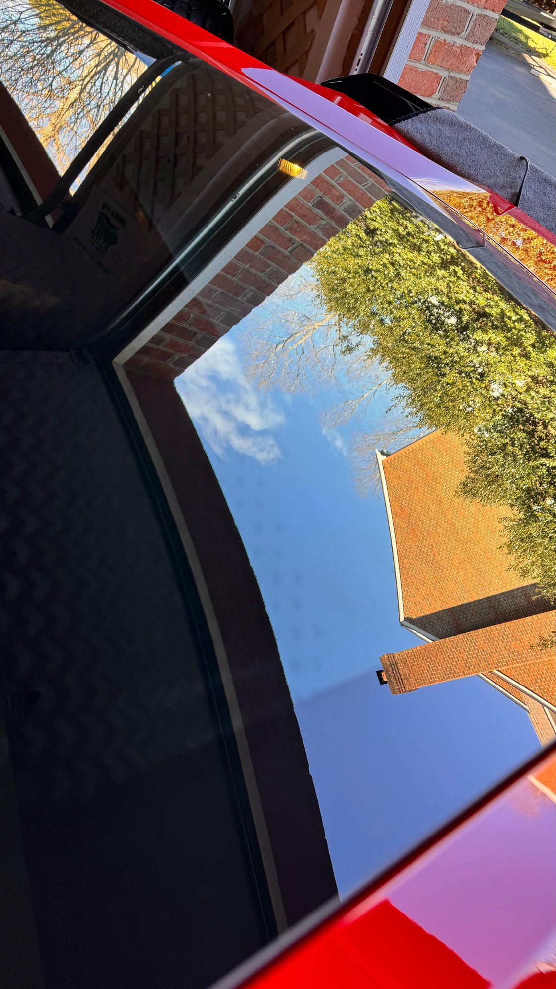

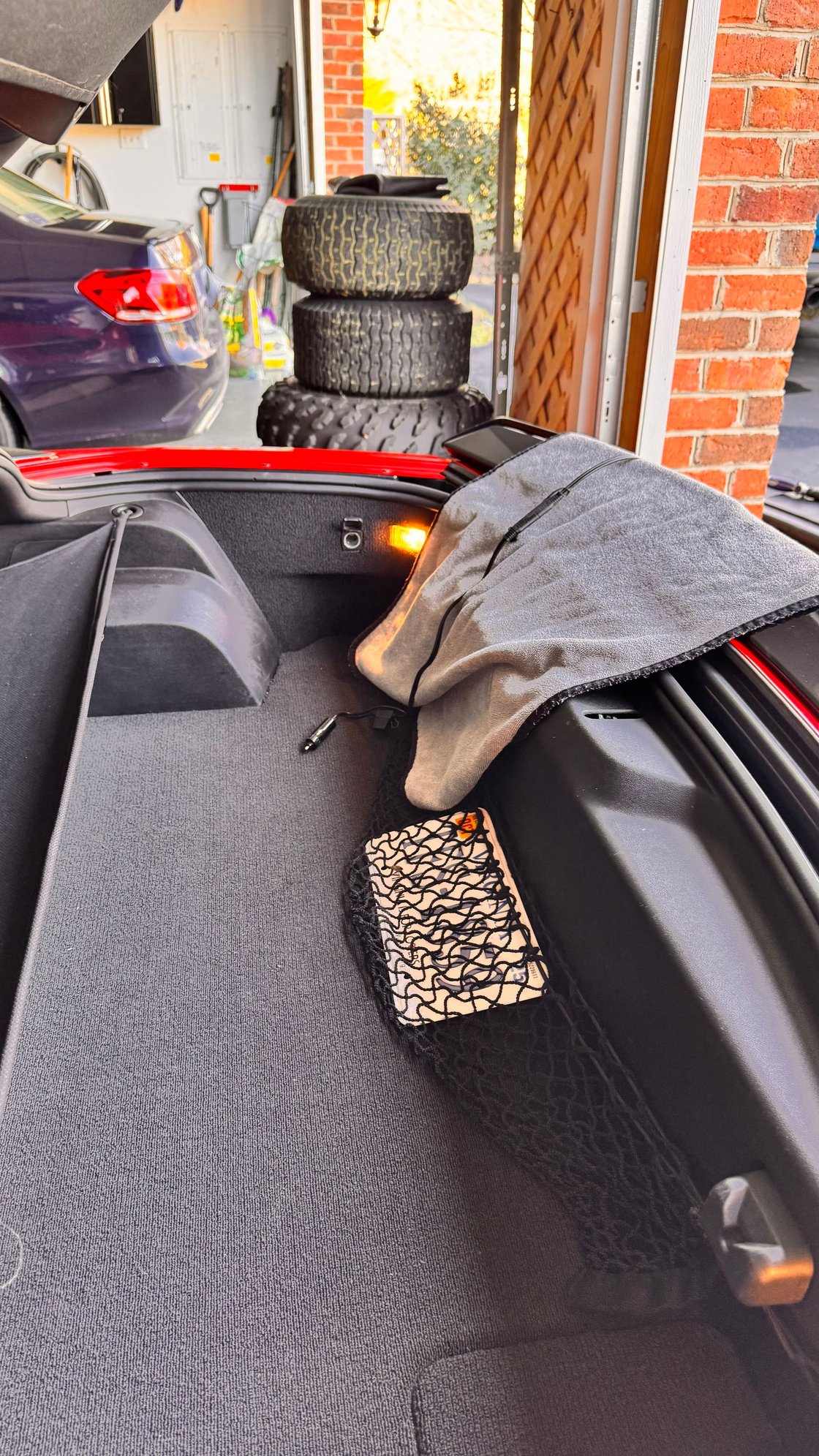

I know this is a stupid question and it’s probably been answered here before but I can’t find it. I set up my battery tender, left the hatch cracked open for the cord, and the trunk lights won’t turn off. What am I missing?

How long did you wait?
From the manual and it working on my car.
Battery Power Protection
This vehicle has a feature to help
prevent the battery from being
drained in case any of the following
lamps are left on: vanity mirror
lamps, cargo lamps, reading lamps,
or glove box lamps. If any of these
lamps are left on, they will
automatically time-out after about
10 minutes. To reset it, all of the
above lamps must be turned off or
the ignition turned on.

It is supposed to turn off after a few minutes. Personally I just close the lid on the cord and it doesn't seem to be causing any problems at all..

I plug it in and just lower the back hatch until it's just sitting on the cord. I don't totally close the hatch, just set it. The light goes out after a few minutes.

I do the same. The car will automatically shut down the courtesy lights after about ten minutes or so. No need to worry unless your lights do not go out after a 10-15 minute timeframe.

After 10 minutes it will shut off. If it’s still on after 15 -20 minutes there’s an issue
