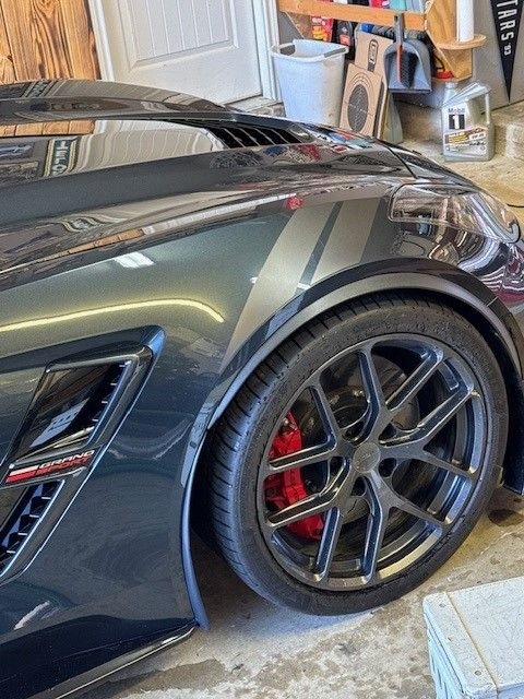

[img alt="Yes, you want it warm, read the instructions, watch a video of it and take your time. Measure the spacing out .
My wife helped me with it, our first stab and it came out great. Good luck, Rich"]https://cimg8.ibsrv.net/gimg/www.corvetteforum.com-vbulletin/2000x1124/20200802_171944_1__0617127486f5c59e4d65e df4b04d283fb9f3bf40.jpg[/img]
Yes, you want it warm, read the instructions, watch a video of it and take your time. Measure the spacing out . My wife helped me with it, our first stab and it came out great. Good luck, Rich
