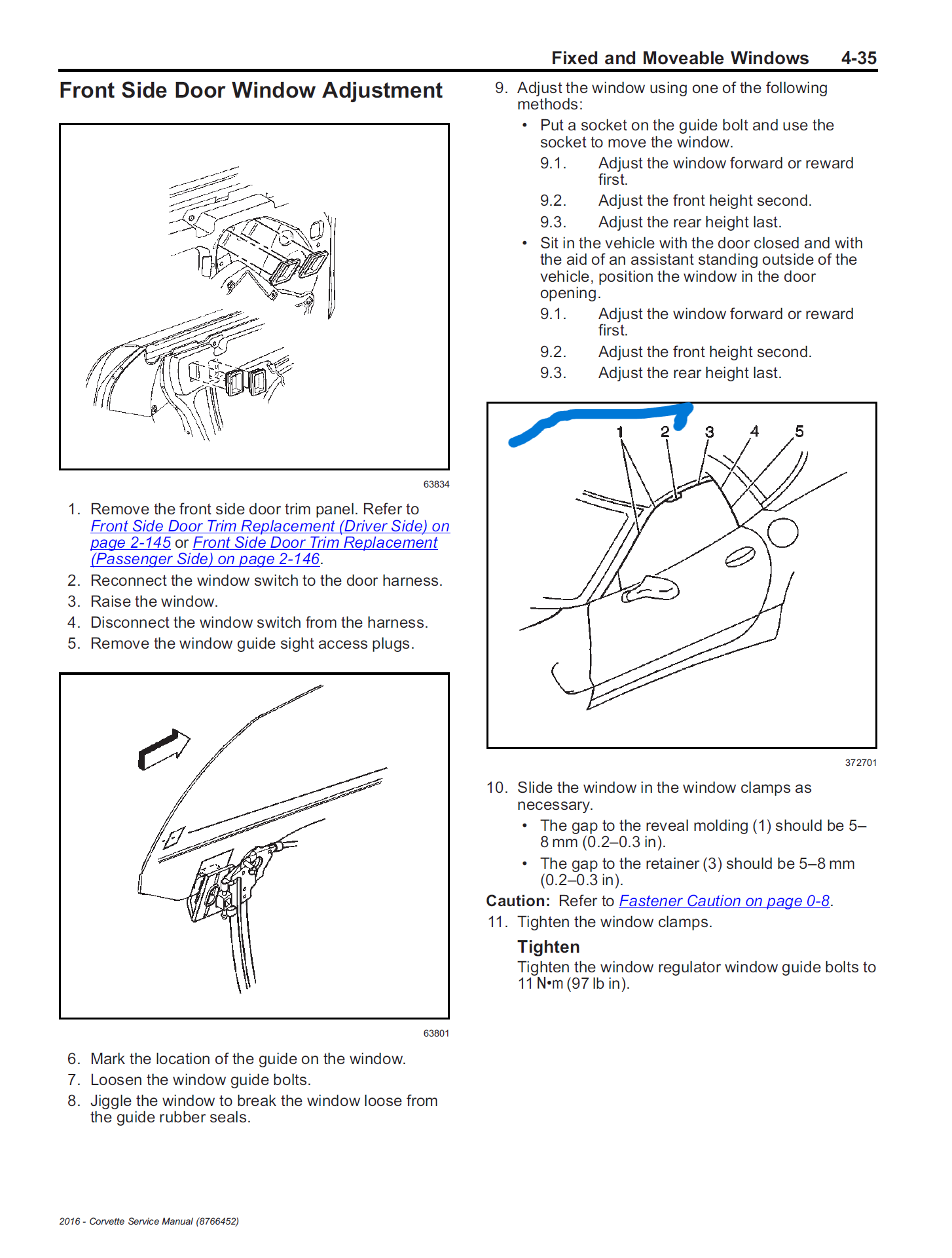

I suspect there is some outward pressure on the window that causes it to move outward. There is no electrical adjustment/index that will solve the problem since the indexing only sets how far the window will drop when the door is opened. Have you stood outside of the car and watched the window movement while you opened/closed the door many times? That might give you an idea of what has happened. Has anybody done any work on the door opening weather strip or has it been replaced? Have you checked the door hinges to see any movement in the door? Check the clearance between the window and the A pillar reveal molding it shouldn't be any more than how the window Check the inner and outer window seals on the door to see if they are letting the window move in or out too much. One thing that can stress the window and maybe cause movement is if the battery was disconnected while the window was closed and the window wasn't reindexed the door would open and close without indexing. That means the window would pull the upper sealing channel outward and inward. If that condition weren't resolved quickly continual opening/closing of the door would cause wear and tear on that channel. Since you aren't the first owner of the car there is no telling what happened over the previous 11 years.
There is a fair amount of outward pressure at the top of the window when driving at highway speeds, on the C5s this caused the top of the windows to blow out causing a lot of wind noise. GM attempted to resolve blow out by using anti blow out clips to hold the window against the seal (searchable in the C5 forums on this board). On the C6 they went with the current method of driving the window upward into a channel and when the door was opened indexing the window.
Here are the window adjustment instructions, what is interesting is the diagram shows a C5 and item 2 in the diagram is a blow out clip.
I would check the clearances shown in Step 10 to see if there is any issue with how the window rides on the A-pillar reveal molding as that will affect how much the window pushes outward as it is raised.
Bill
