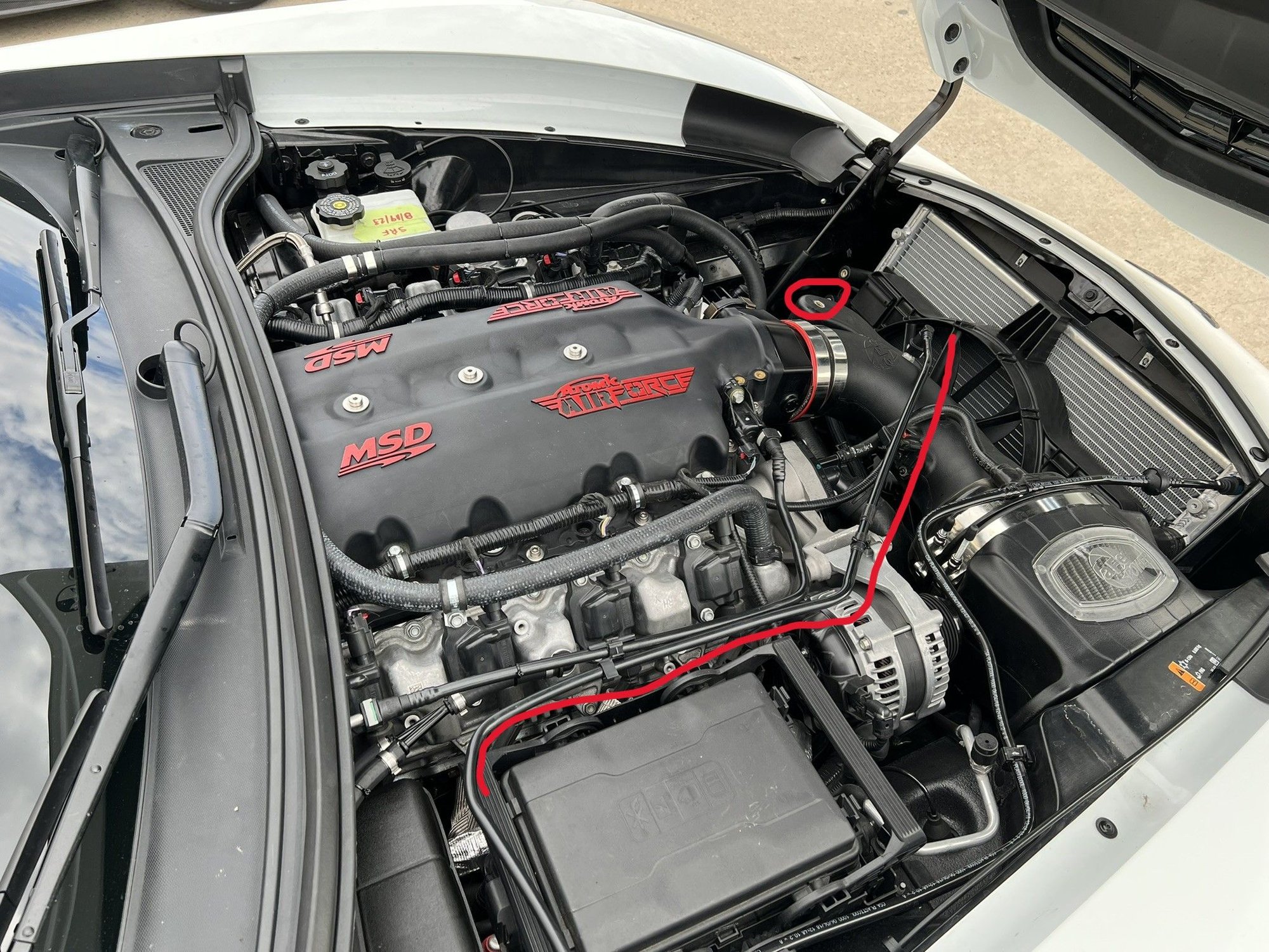

How many lines run to the factory intake (ie from the filter to the throttle body....the factory "CAI"). That's your answer. I've never seen a 2019 with the LT1 have more than 1.....but seems easy enough to open the hood and look
Should be 1 fresh air line.

The red line runs along the fresh air line. The red circle would be for the second line if it existed. My CAI is from AFE so they just give the buyer a plug if the car doesn't have the second line. Mine's a 2019 Grand Sport so like yours, it has the dry sump. Don't pay attention to the other stuff that's for the catch can and crankcase pressure. You should have a single line running to the intake as you see on mine.
