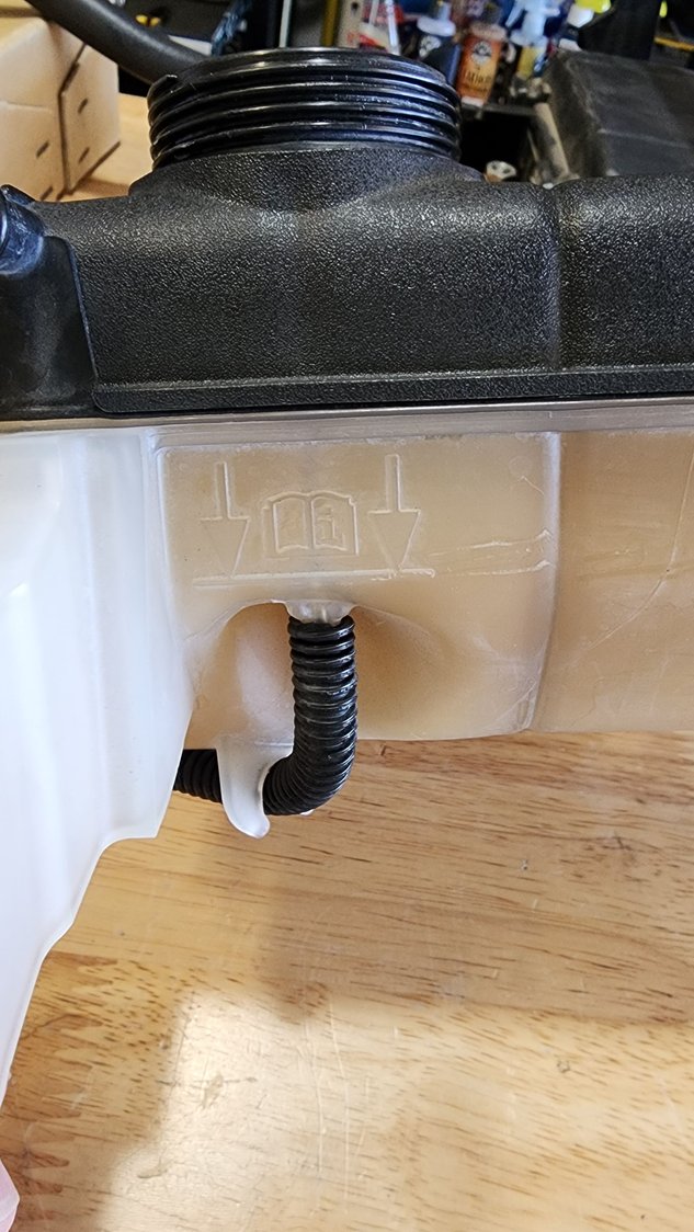

I know that his question must have been several times already but, I cannot for the life of me, find the coolant level indicator marks on the reservoir. If its where I think it is (on the front of the reservoir, right next to the fuse box). I do not see how this can read.
With the space allowed, the best that I do, is just feel what appears to be level markings. Am I looking in the correct spot? On a cold engine with reservoir cap off, I can barely see liquid in the tank. Suggestions?

Yea, my '15 is like that too. I can see coolant when I look in but seems low in reservoir. Cold fill line is at the seam about half way up if I remember correctly. I made a cardboard dipstick and level is pretty much at the cold line. Low coolant warning light would come on if low. Use a flashlight and you can see the cold line. Maybe put a magic marker line on it?

With the overflow tank right next to the fuse box (combined with my poor vision), this seems like a very poor for design for, what is a pretty important aspect to keep tabs on. I just wish the viewing access was better.

I nicely colored my level indicator on the tank with a black permanent marker to help me see it. BUT if you look in the tank, there is a small "landing" in the shape of a halfish circle. I don't have a picture, but it's right there under the lid. The top of that is basically at the same level as the level indicator on the outside of the tank.
