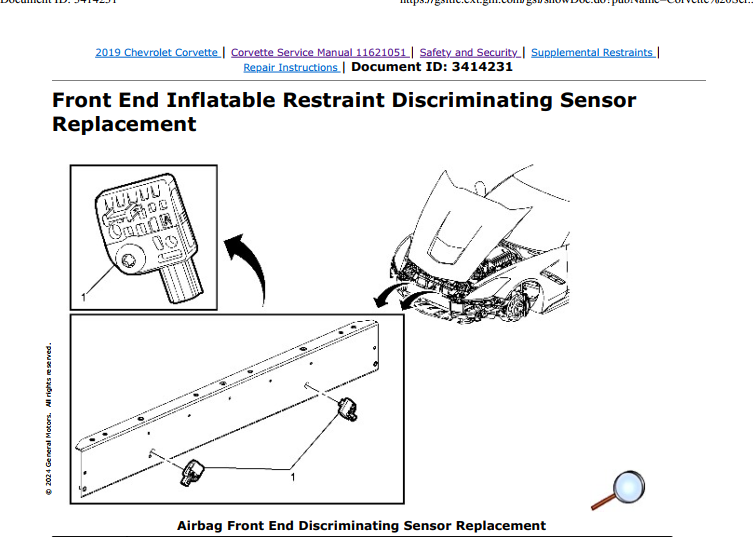

Hello, I am currently rebuilding my 2016 Corvette and have replaced my airbag, clockspring, seatbelts, and their pretensioners. I still have an airbag code, and my OBD2 reader said it was the left front side impact sensor high voltage open. I believe I know what the part is (part number would help still), but my main problem is I can't seem to find a picture of it anywhere to know where it is on the car. I hear it's behind the main front bar at the front of the car, but I can't find it. Would someone be able to take a picture of where it is to show me so I can fix it?

Upper left corner of the radiator.

Just imagine if you will there was a thing called AC Delco TDS with all the Service Manual information that, for $25, you can access for 3 days. Similar to AllData
Nonetheless....
You have to pull the bumper cover to get to it.
