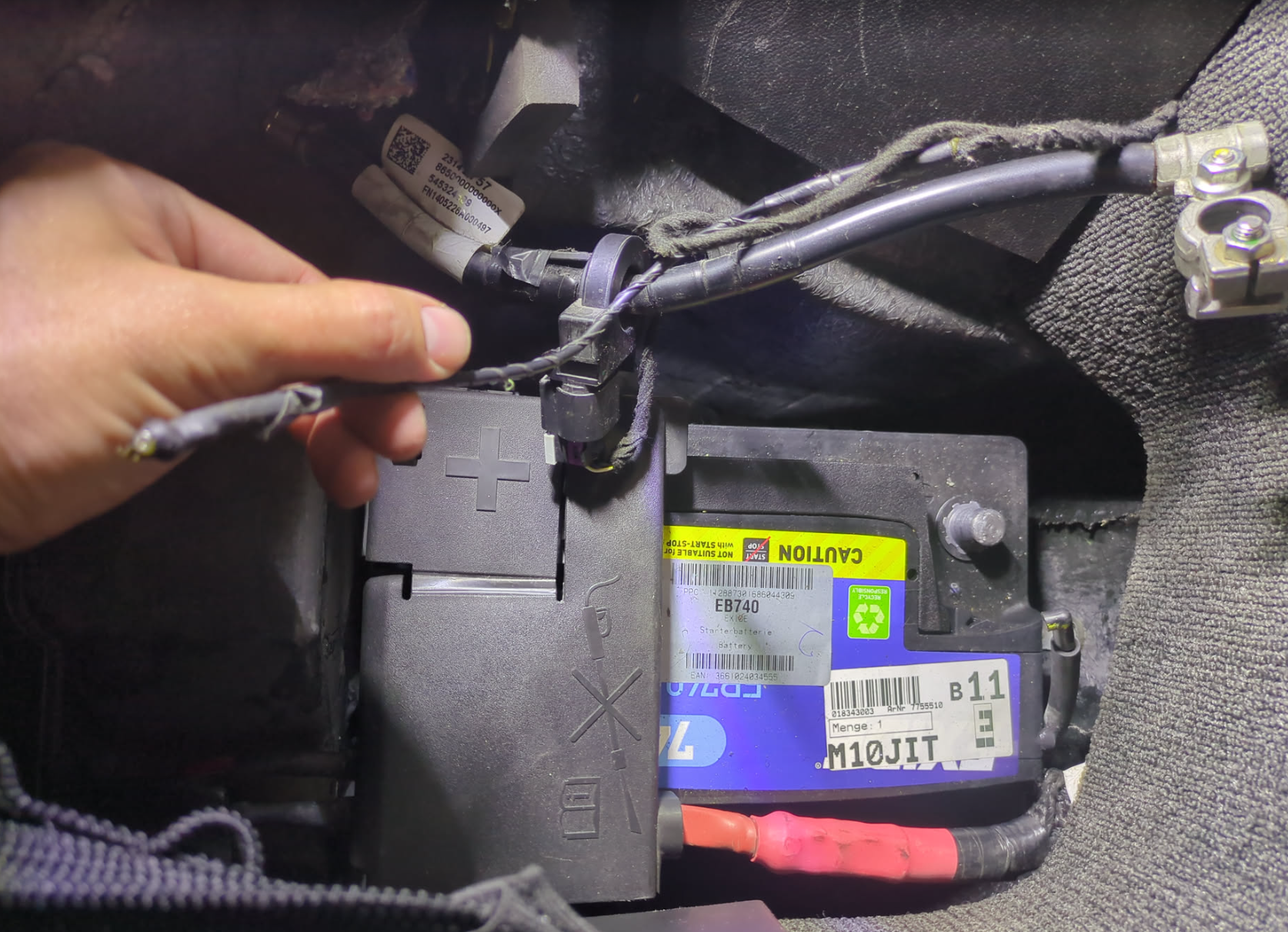

Is this installed from factory or has been added by previous owner? Can't figure out what is this black cable

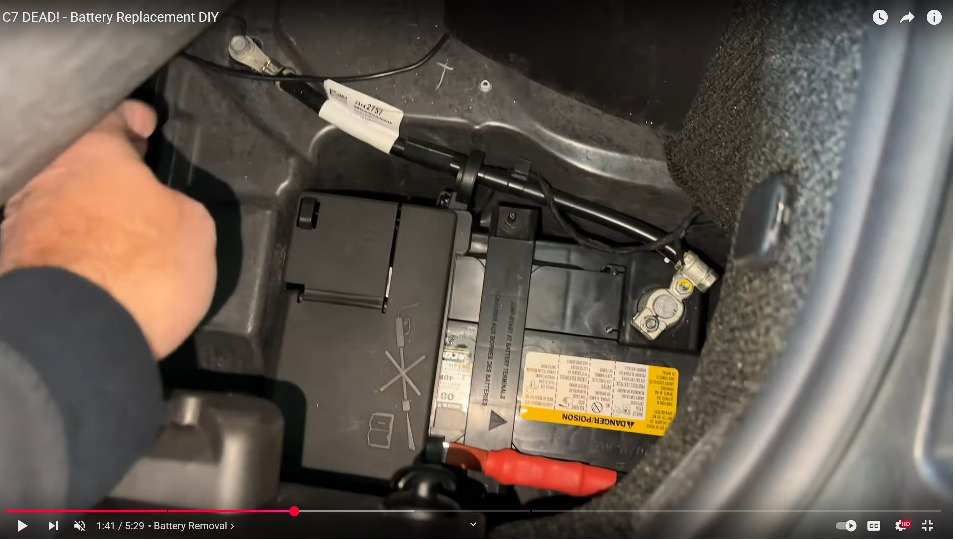

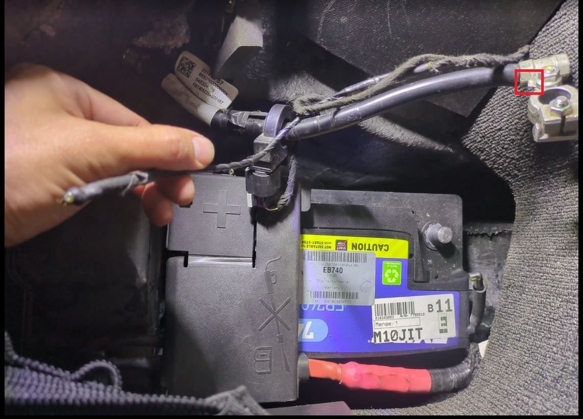

It's factory. It gets crimped to a ring connector on the negative battery lug. I believe the area I boxed in red shows where it was broken off. This is pretty common unfortunately.
I took the screen shots from the below video to show you it properly connected.

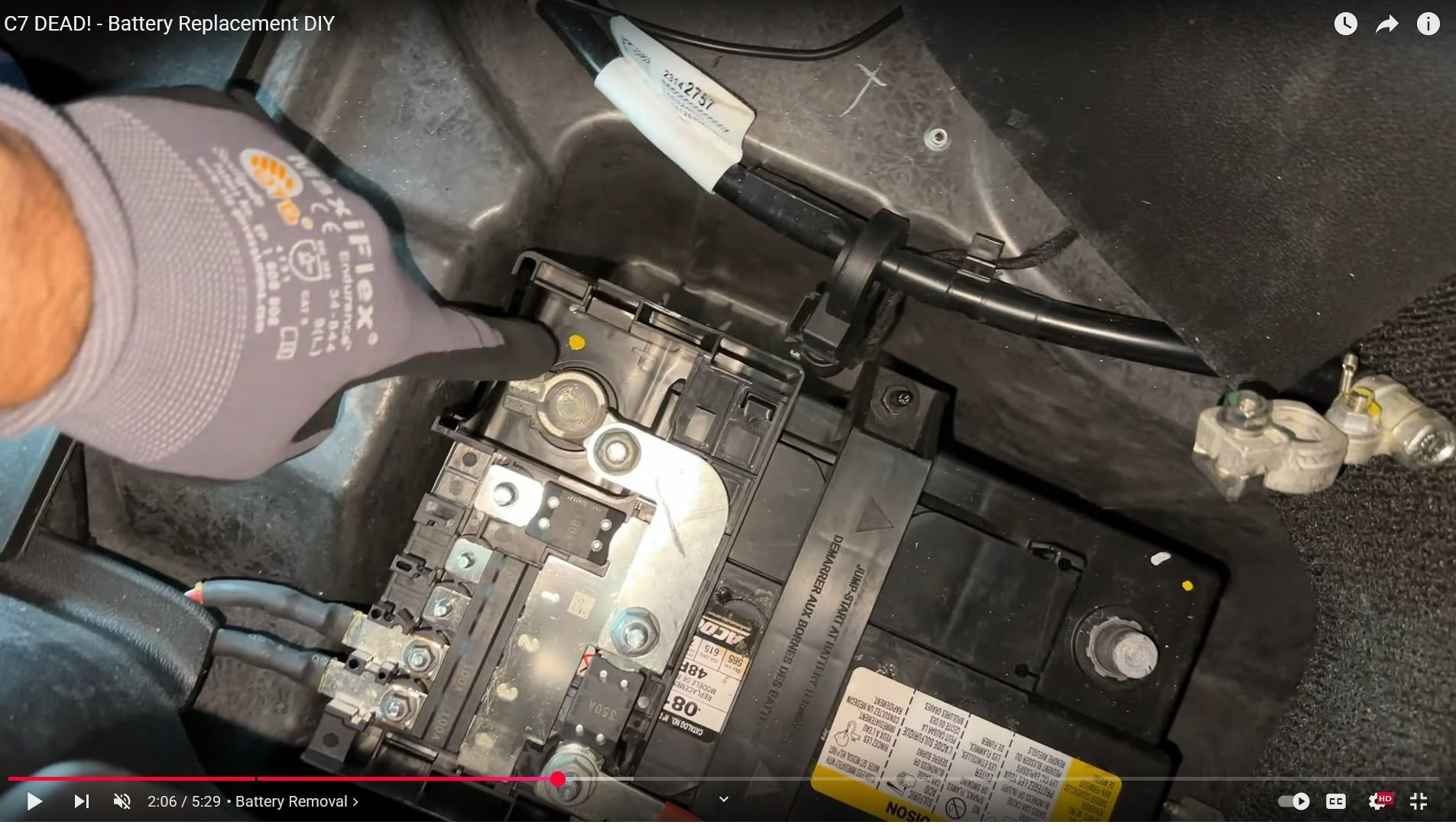

This shows it close up.

The black wire is a sensing wire important for proper battery charging. Just connect it back to the negative (black) battery cable. Splice in a few inches of black wire to add some slack. The wire is most often broken during a battery change.
