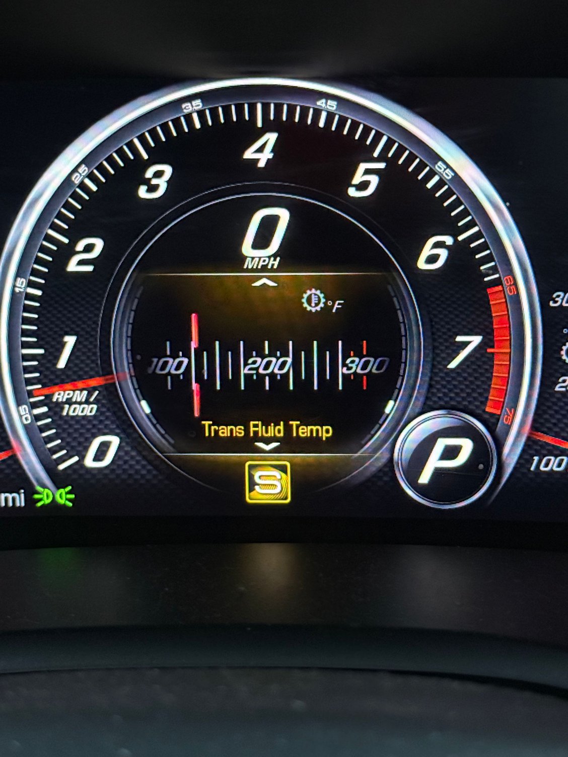

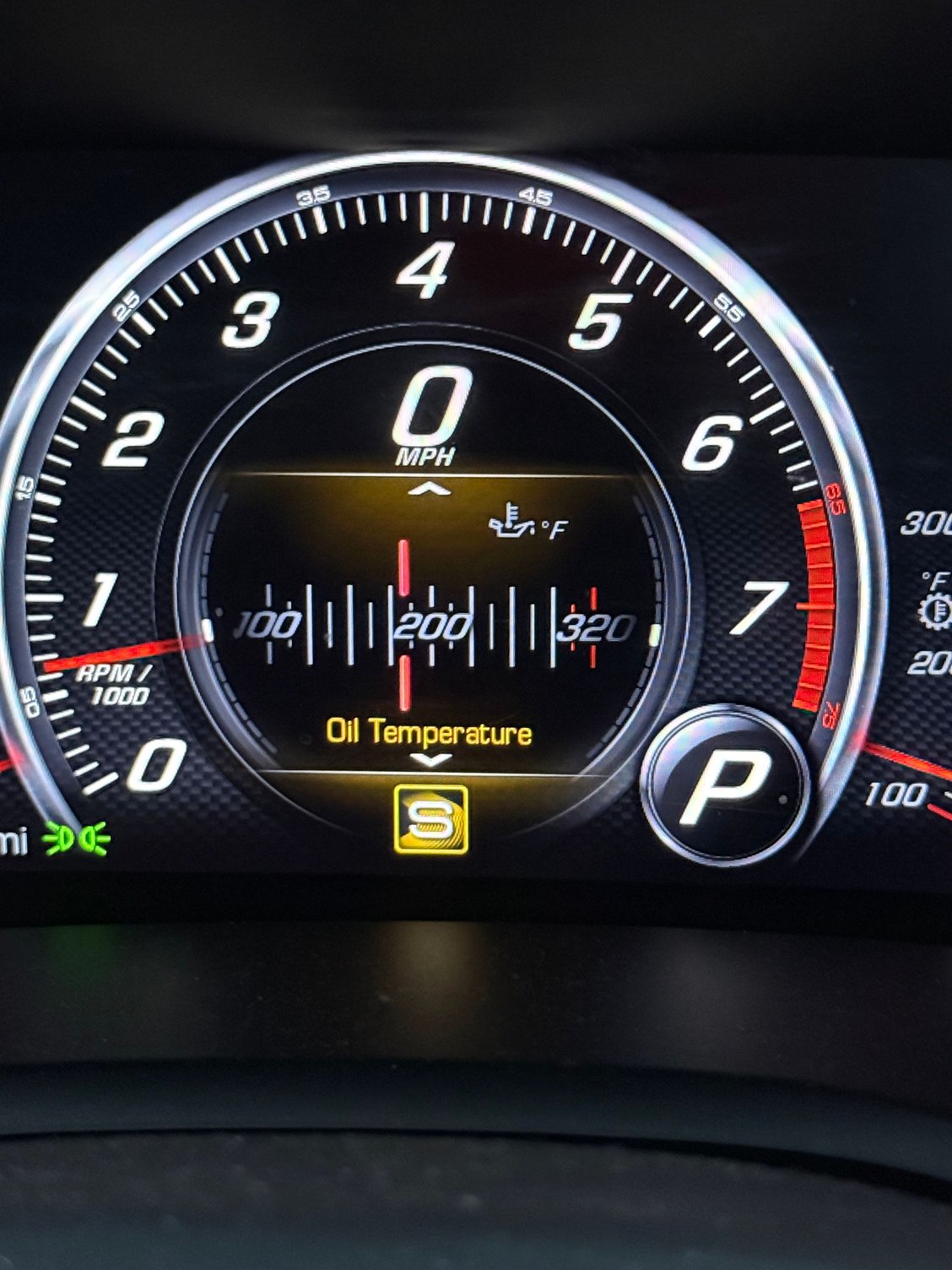

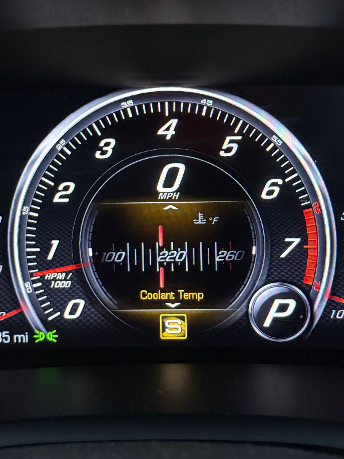

Just had my coolant flushed and rear axle fluid changed. Drove around yesterday for ~45mins mix of highway and local driving. Engine temp hovered around 180-200 F max, trans fluid did not get above 125 F. Oil and coolant seemed fine.
Strangely - put the heat on and it would blow warm for 5-10 mins and then just start blowing cool. Problem would go away when i turned temp up for a few minutes and then cool again.
Has anyone else experienced this?

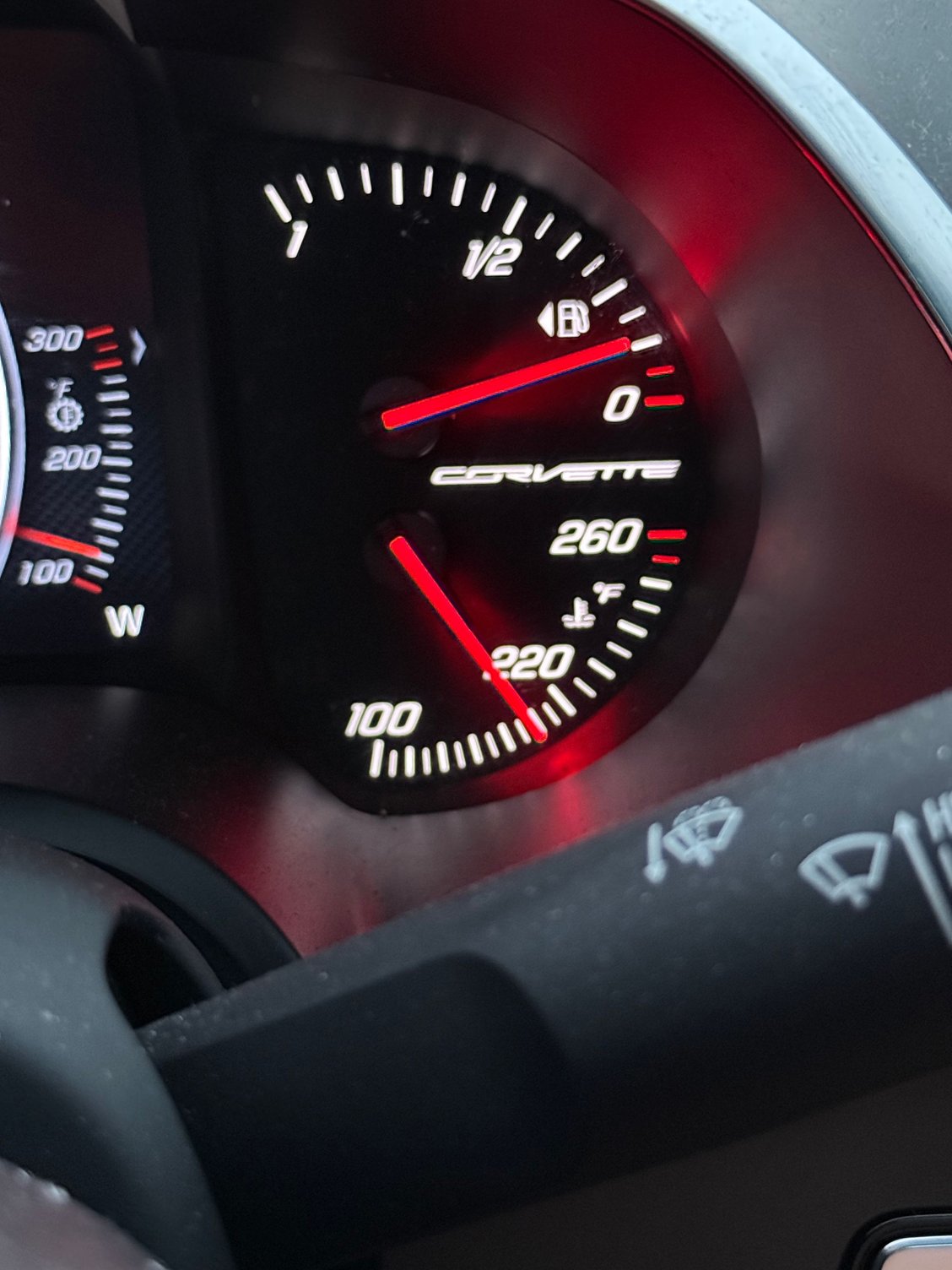

Which engine temp? The big analog gauge is coolant temp. That coolant temp is a little low. What thermostat are you running.

180 - 200 F coolant is normal with the 2015+ thermostat . On a hot day in traffic it can be higher. Transmission temp seems OK.
You just had the coolant flushed and now your heat is intermittent - so how can that affect heat? Check the level in your coolant tank - your car may still be clearing air pockets. Correct coolant mix is 40% Dexcool / 60% water.

Your coolant temp is normal.
