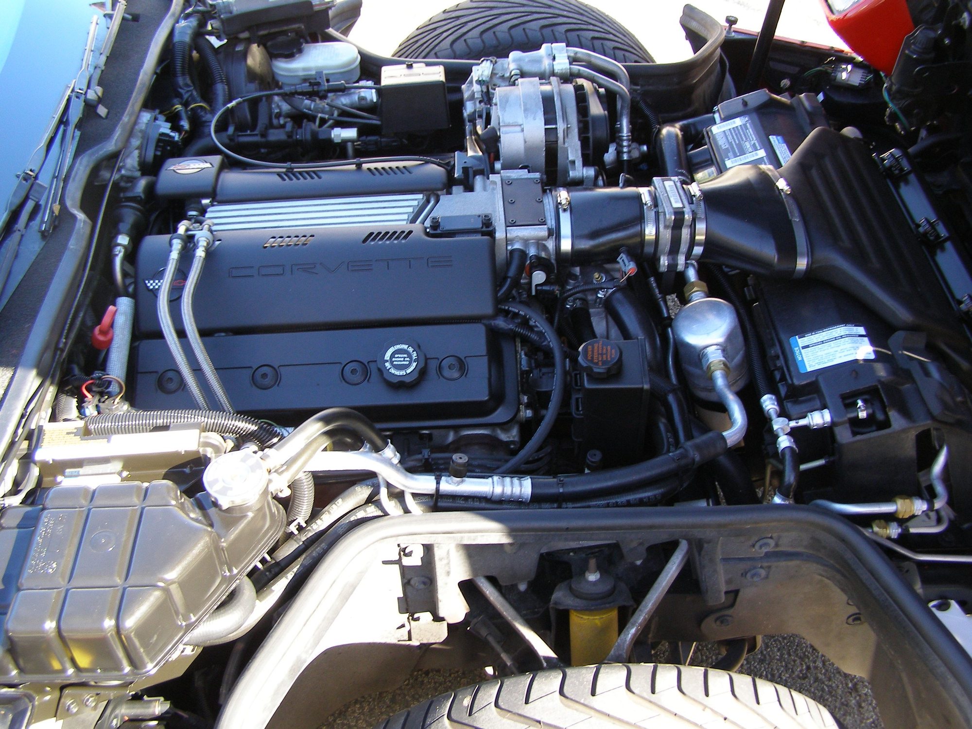

A lot of people are not familiar with the raised hood on a C4. It does make working on the car and detailing the engine much easier. I happened to be at my computer and will add some images for those that are not familiar with the C4 "Clamshell" I believe the engine had about 75,000+ miles at this time period.

You can see in the pics of mine the inner structure since the fender was off for access to the dry sump tank during my 416 build.
  • You'd have to chop the inner fender panel....which is bonded to the frame so cut carefully
  • The lower rear portion of the fender has nothing supporting it so structure would need to be added
  • The upper portion of the fenders need to be bonded to the hood
  • You'd have to figure out the headlights, including how to ensure access in case of maintenance (ie bulb change)
  • Not shown in the pic, the cowl likely needs some integration work
  • A hinge system would need to be designed as well as a way to support the clamshell when it's open
Basically....a big pain in the ***. Like anything, with enough time and money...mostly money, lots of it...it could be done
