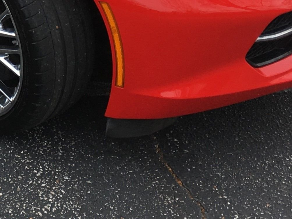

Z51s have two lower air deflectors (black plastic, maybe 18" long and 4" deep) that hang down, one in front of each front wheel. They are horrible for scraping the road, curbs, or driveway entrances; making a helluva racket while doing so.
They are installed, I believe, for improved aerodynamics at high speeds (130mph or so).
I removed mine years ago and haven't missed them at all.

Just to make sure were all on the same page with splitter/air deflector names, Z51s came stock with the air deflector shown in front of the wheels below. The two deflectors did not meet and butt up against each other in the middle; there would be an approximate 2' gap between the two.

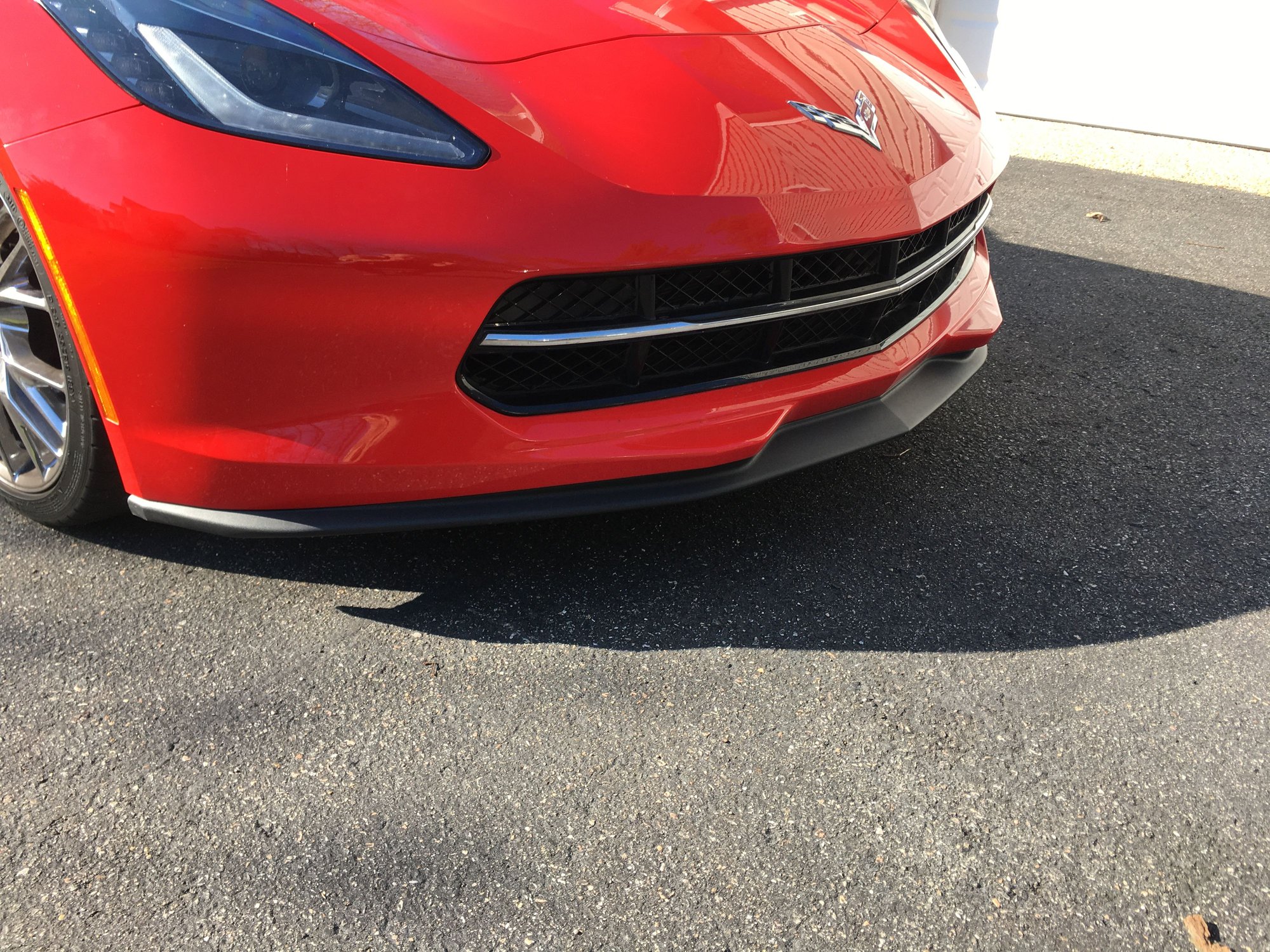

Here is the car with the deflectors removed and a Stage 1 splitter installed. The deflectors could have been left in place, but as I mentioned, they hung down and scraped the road, etc, quite often. The splitter on it's own hangs down less that the deflectors (I'd estimate 1-1/2", as opposed to 4").
Z51s did not come stock with the Stage 1 splitter; I don't know if it was an option that could have been factory-added. By any chance, do you have a photo of either of the Z51s you're looking at, or links to their sale, so we could see what splitter is in place?

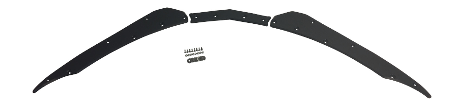

I added a product called ProTEKt for the underside of my stage 3 front splitter. It's a skid plate that bolts to the underside of the front splitter.
Scrape Armor also makes a similar product. Google both of them. Pays for itself in no time.

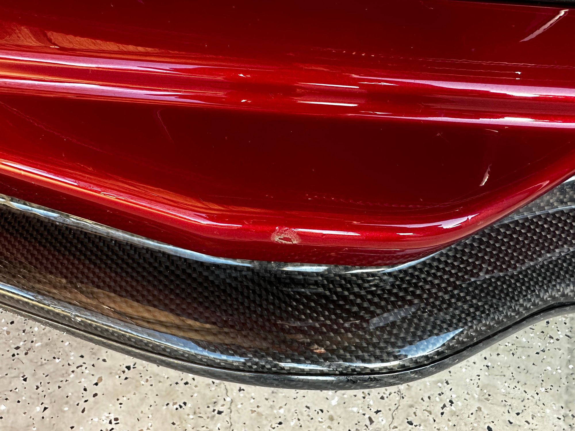

I have ACS carbon fiber splitters. I put PPF on mine and it does a great job but does not protect the edges. Also added Cowle’s Door Protect molding to the edges to protect the carbon fiber from the inevitable scrapes. You can take it off if it gets scraped
and add a new strip and looks like new. Can get it at O’Riley’s.
