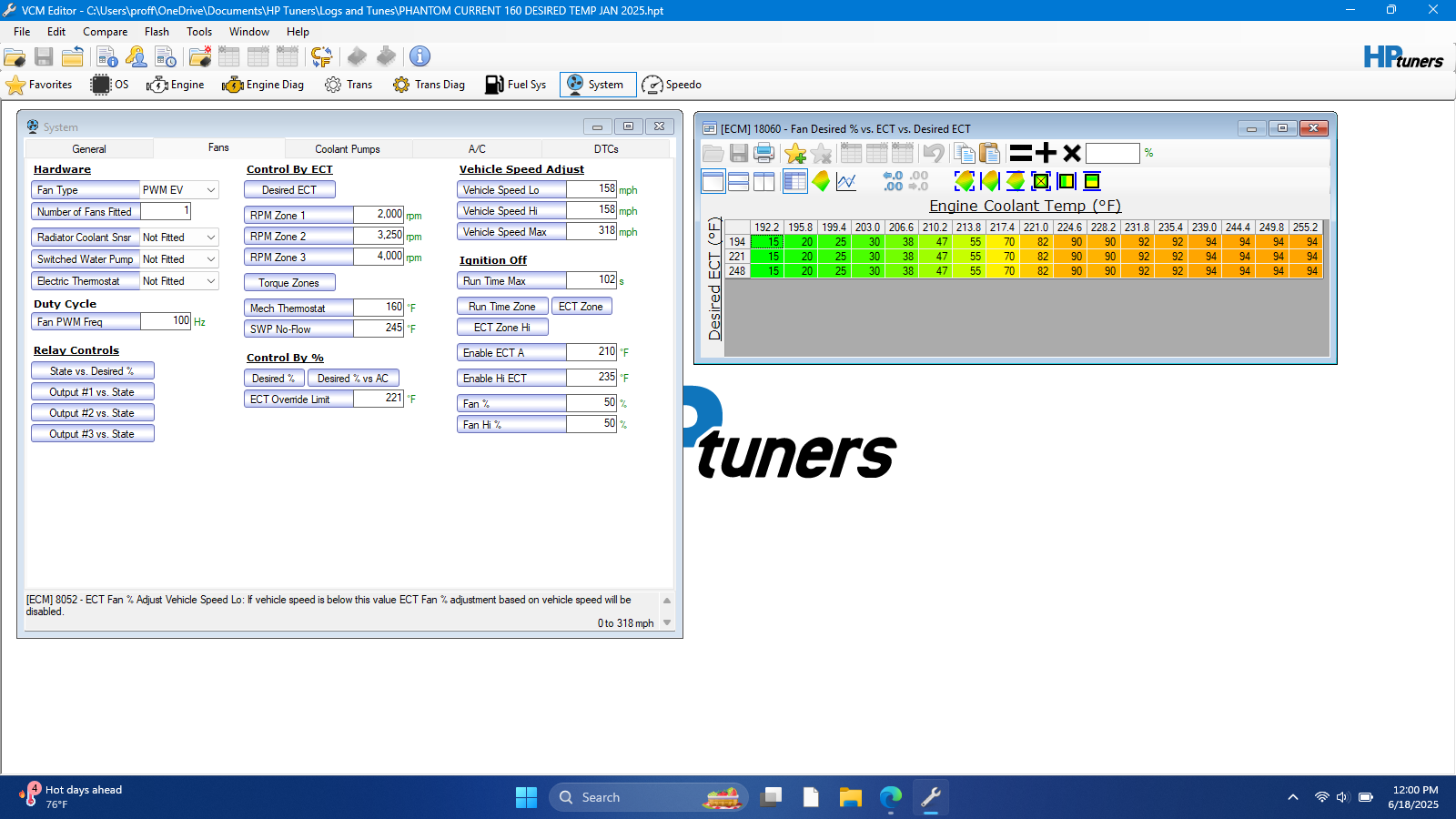

You can use HP Tuner. I used HP Tuner to keep temps around 170-190 degrees

A thermostat sets the lowest temperature that your engine will run at. For example, if the thermostat installed is 190F, the engine temp should remain at 190F or greater. On the other hand, a 170F thermostat will not drop engine temperature if the engine temperature is at 230F.

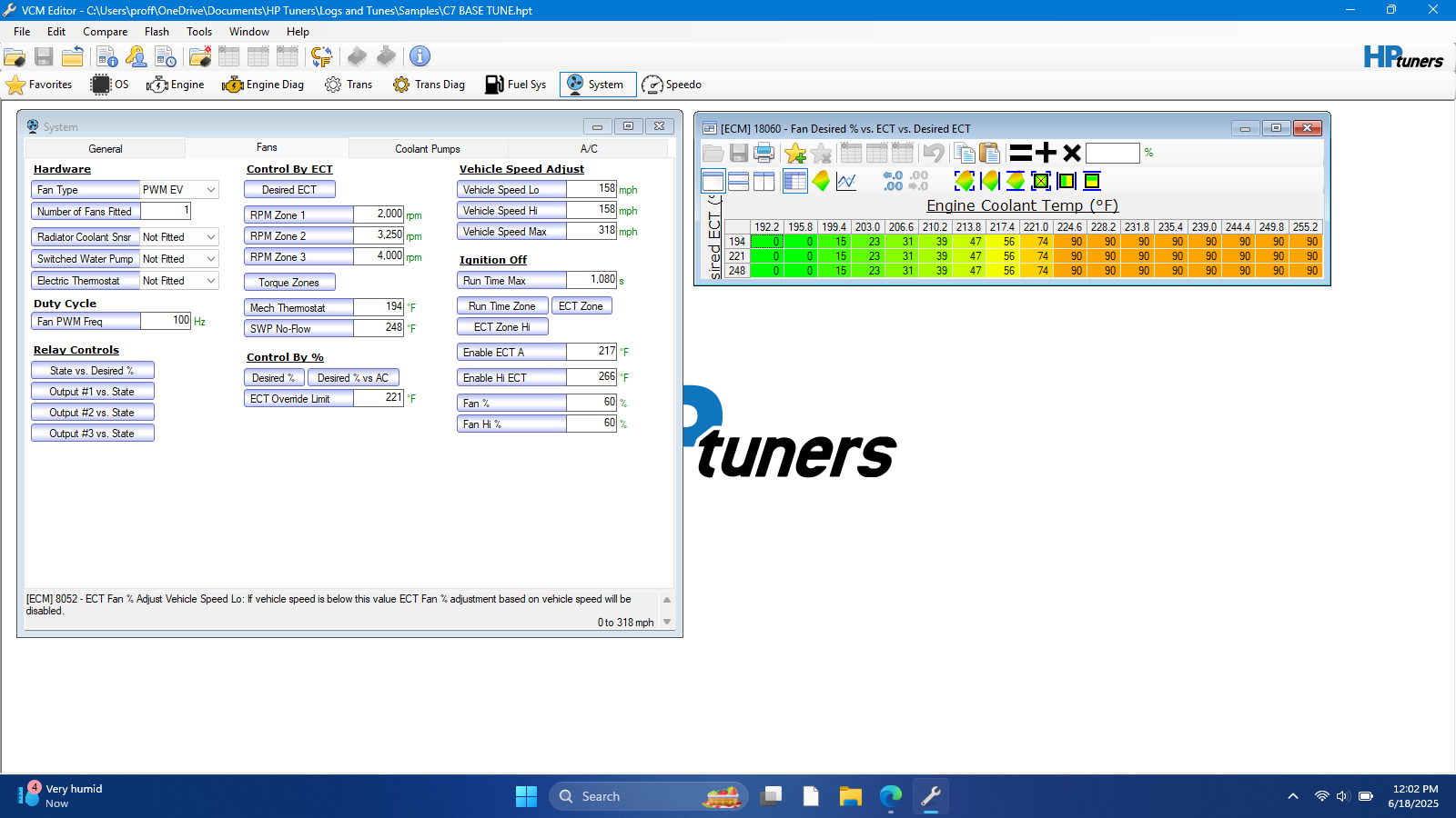

The top tune is stock. The bottom tune I changed the values.

The $600 solution to the $100 problem Of course if the OP is going to do more to the car then I do agree....totally worthwhile .
Having said that...With the higher opening point of the 2014 thermostat, a programming change is going to be pulling air through a radiator that has reduced coolant flow due to the closed thermostat. It slows the temp increase more than stops it although if it's cool enough outside, it can help. To really take advantage of the programming, thermostat needs to be changed. Now you have a lower opening point and the fans running to keep it there. The 2014 cooling system is the same as 2015 so it has plenty of capacity (for a street car).
To the OP....lots of threads from 2013/2014 when the C7 was introduced regarding people not liking the higher temps. There are more threads from 2015/2016 once it was discovered that GM used a cooler thermostat for the 2015 & up cars with no other changes and that those cars tended to run 10* or so cooler under the same conditions.

And if you want to dive into the details I can attach some 2014 & later OEM files to compare. The below shot is the base 2014 file vs a 2019 file. Green is where GM made changes. 2014 values are shown. Grayed box means the 2019 file doesn't use this parameter. Lastly I will mention that not all parameters apply. You have to look at each one and decided if it does something or if it's an artifact in the programming for other vehicles since at least some of the base parameters are for items the Corvette is not equipped with, such as a switched water pump.
I look forward to your analysis and findings

They're as low as $375 for MPVI3. It's totally worth it. They're so many things you can do with it. Changing the fan speed and thermostat to a 160, and disabling DOD was one of the first thing I did. One of my favorites is customizing the exhaust NNP valves. The valves can be programmed to open and close, in any gear, at any rpm and engine speed.
