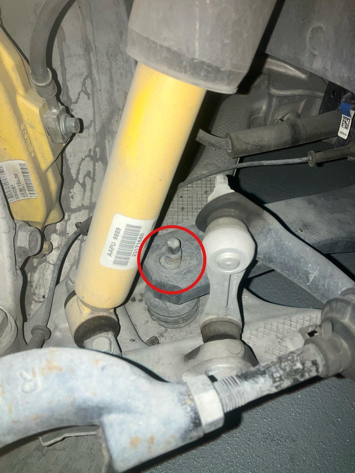

Is this normal, not missing a nut here? (C7 front side)

That does not need a nut, it is the height adjustment bolt. A 10 MM socket or wrench fits that end to make adjustments.

You can always add a washer and nut (go with stainless) if you like, though.

The bolt can be used to adjust the ride height of the car on each corner. We adjusted ours to exactly stock height when the car was a year old, now 6 years later one end is about 1/8" below stock (BFD, I know) and it's frozen in place. The Tech has tried penetrating oil/tapping/vibration/time/mild heat, and nothing moves it. He's afraid to ruin the spring if he tries too hard, so we just ignore it.

I have adjusted mine a few times. It always takes some penetrating oil to get them moving. It might not be a bad idea to quirt a drop or tow on there each time you have the tire off to avoid Gearhead Jim's situation.
