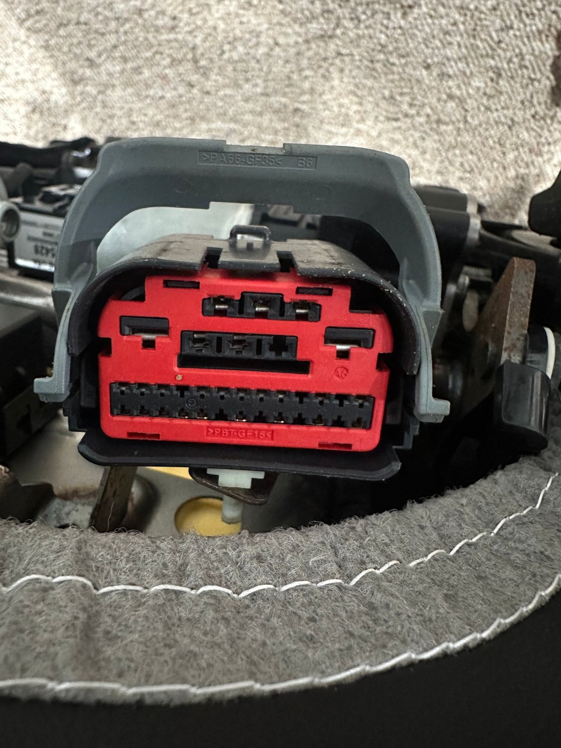

Originally Posted by 96GS#007
Need a pic of the harness under the seat. 2018/2019 are more rectangular in nature than the 2014-2017 cars.
This is the connection
....so you have a 2014-2017 2LT seat. Somewhere on the seat or on a piece of trim you'll stumble across some scribbles from a line worker and/or a sticker with the manufacture date of whatever part or trim piece you find it on. Doesn't really matter since to my knowledge the pin-out is the same for all 4 model years.
thank you!! That’s what I needed to know. I’m going to buy a harness kit and they want yo know 2014-2017 or 2018-2019
