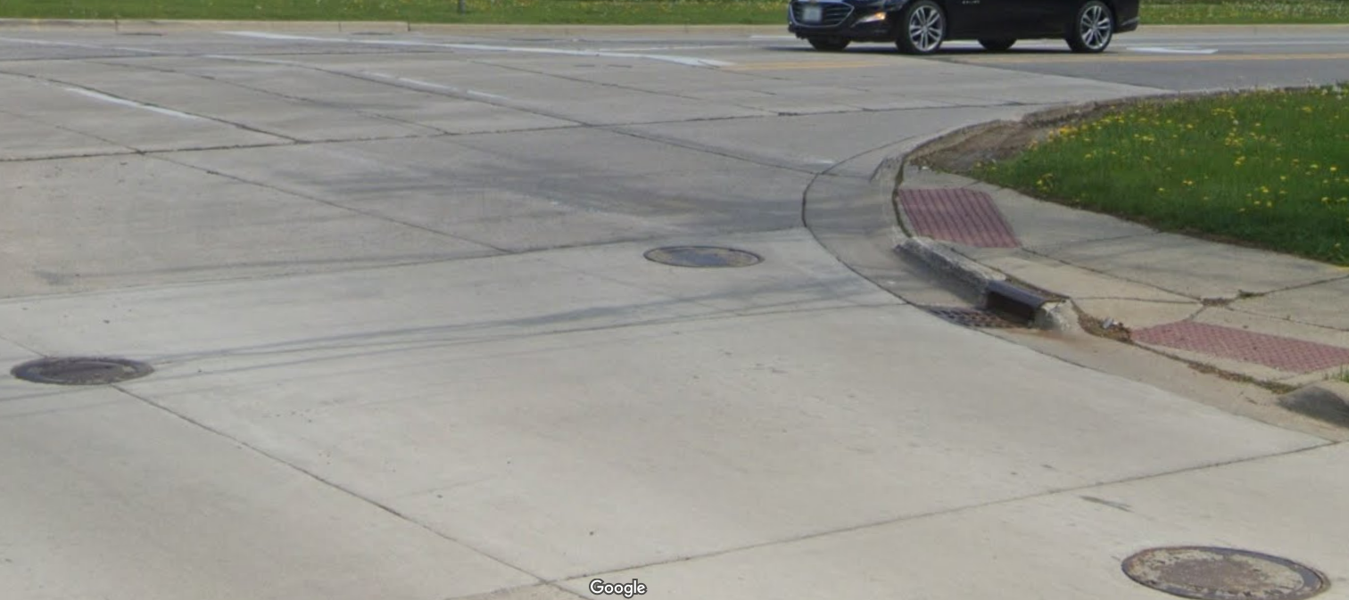

How tight? There is a 90 degree turn here by my house (picture below) where its every so slightly off camber (you crest a small hump mid turn). If I take it AGGRESSIVE and try to power slide around the corner (with stability control on it always will catch it), I can get pretty bad "chatter" from the braking and the wheel hop. Sometimes you think the drive train is going to drop out. But its fine. It's mostly caused by the stability control oscillating the brake pressure to catch the car while your trying to stuff torque down and at the same time getting a little wheel hop. If I do it hyper aggressive enough it will de-rate (cut) power a little when I try to straight line accelerate after completing the turn.
