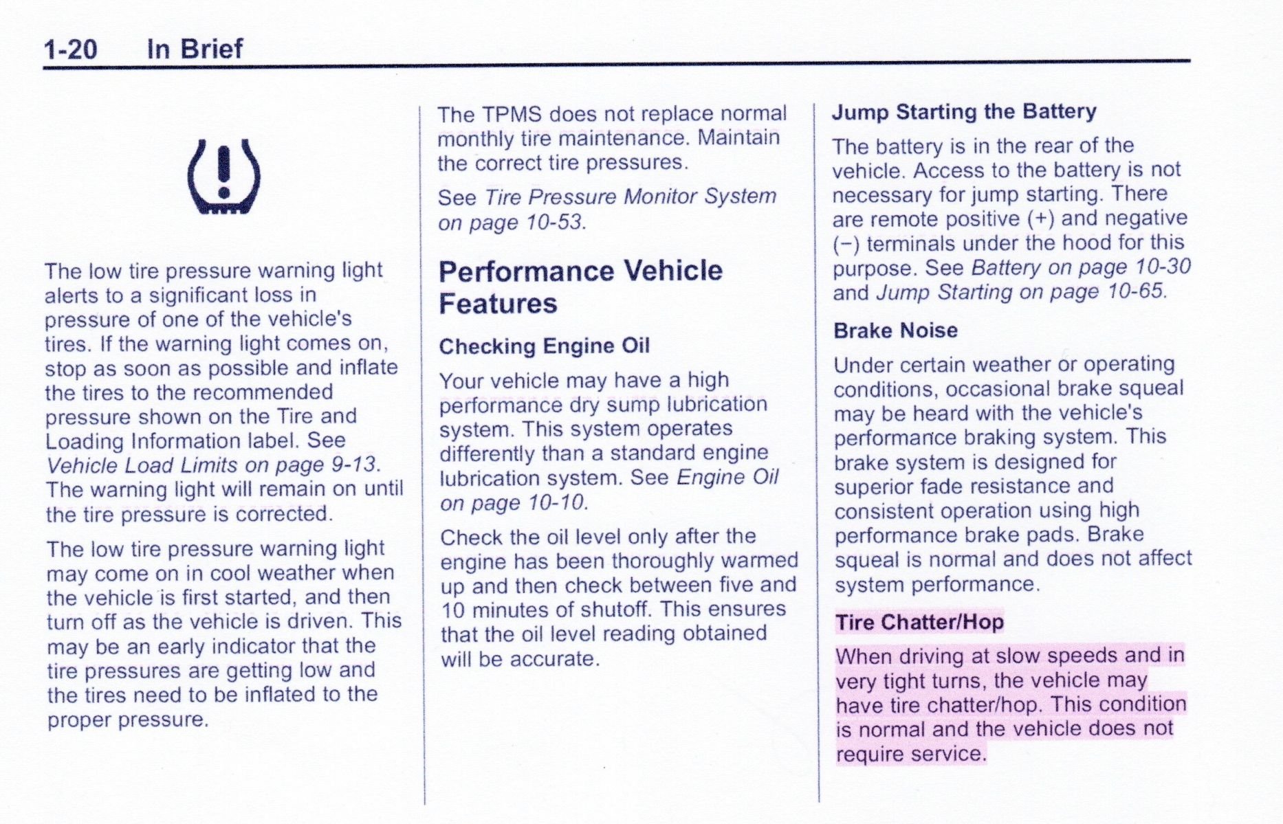

From the 2014 Owners Manual:
Old Jul 29, 2025 | 11:00 AM

Thank you! My 2016 one owner, I've had it for 3 years now, never came with an owner's manual. Glad to know it's not an issue with my car or anything though.
Old Jul 30, 2025 | 07:59 PM
