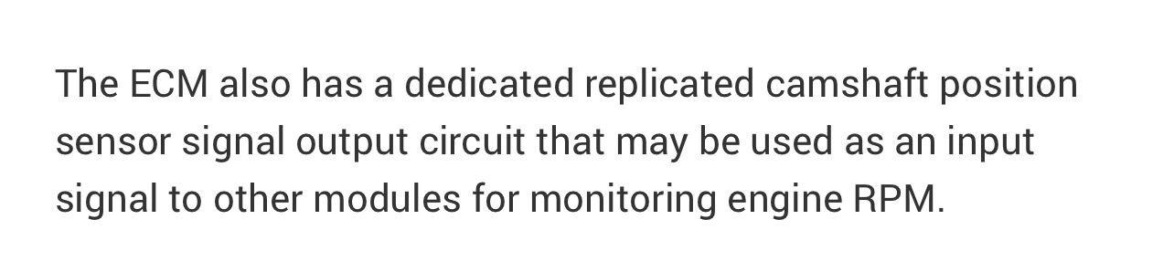

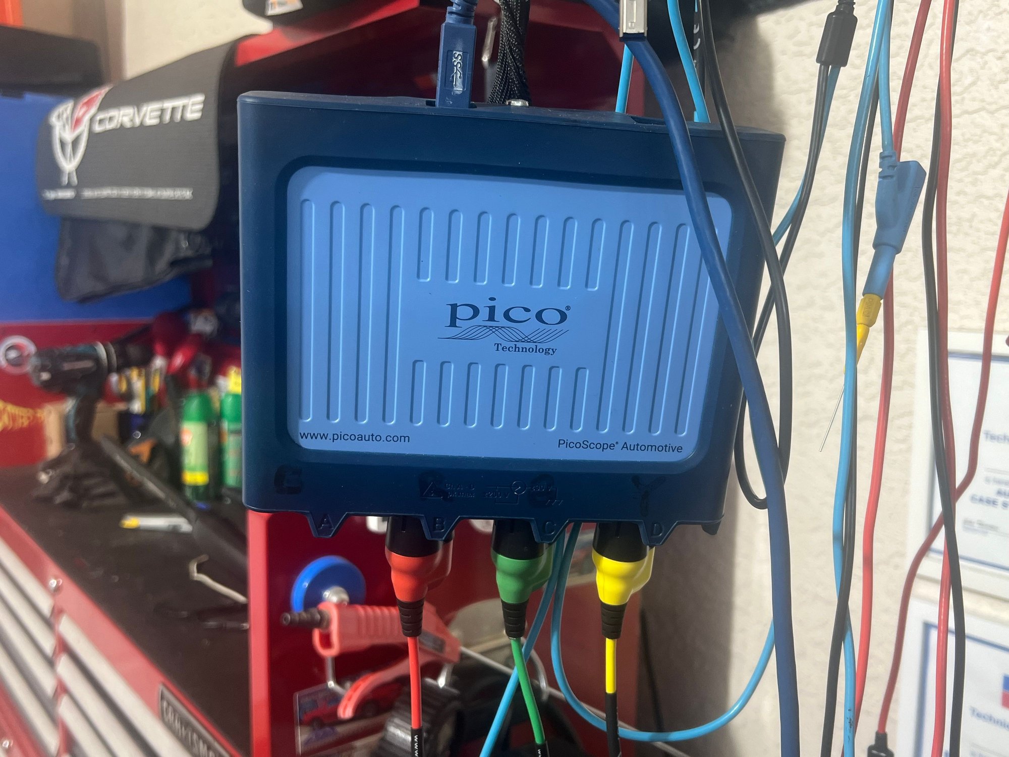

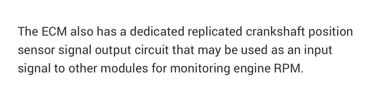

A PICO test ??…do you mean diagnosing this using a PicoScope DSO ??…dealers only use a scope for NVH…you can diagnose this if it is an Auto looking at Torque Converter data PIDS…seeing if it is engaging or disengaging by itself…usually the crankshaft position sensor is the input for the Tach.

I strongly suspect the OP is in the early stages if the transmission “shutter” issue. Although there isn’t any mention of shutter or vibration it is often very subtle in the early stages. I have seen the PICOscope used to sort out if the NVH symptoms were originating from the engine or transmission, in conjunction with other diagnostic procedures. I still strongly suspicion that a 400RPM variance (RPMs going up and down) when not downshifting or coming to a stop is a torque converter issue, and I strongly suspect that it is the commonly mentioned shutter issue that requires the triple flush procedure to eliminate both the shutter and the variance in the observable RPMs..
