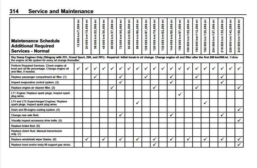

Was thinking it might be a bit soon on our 2019 GS as the manual says every 150k, but then it says (4) - "or every 5 years". Time to search out a good You Tube video as something I can easily do.

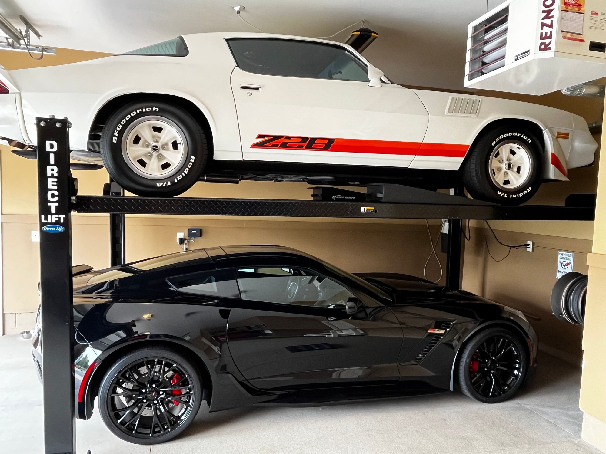

I have a 2021 Mazda CX-30 - definitely not a Corvette and not equipped with a turbo or supercharger - and I changed my coolant about two months ago. I used the "Ranger Method" - drain and fill, drain and fill, drain and fill with tap water until it drained totally clear. It takes a while to get all of the coolant flushed out.
I then bought the pre-mixed (50/50) Peak anti-freeze. It is "green" and valid for Mazda and other 'Asian' cars, even though our Mazda was built in Mexico. One shop wanted $200 to do it and the other said they would do it for $250. I bought the two gallons of pre-mixed Peak (blue jug) for about twenty bucks. It definitely took a few hours of my time, but I saved money and at least it was done correctly. It took about a gallon and a half - including draining out the overflow reservoir. Best advice is to use a turkey baster to suck out all of the old coolant each time you drain/fill it. I definitely don't believe in leaving the coolant in there for ten years - even if they claim that it is "long life" anti-freeze.
I sold my Corvette before I had to flush out the coolant, but do know that DexCool is what is spec'd for most GM vehicles. Just make sure to get it all out of there before you put the new stuff in. Some brands claim to be "universal" but might not mix very well together. I had a Silverado truck for many years and always used DexCool in it. As far as the supercharger goes? That's way out of my realm. My 2017 was just a Stingray.
If you have a C7 with a manual transmission, the clutch reservoir fluid can be flushed out using the Ranger Method. I did it successfully after I had my 2017 Stingray for five years. That is where a turkey baster comes in handy. Just do one reservoir full each time - drive it for 50 miles, shift often and then repeat the process until the fluid looks very clean. NEVER leave the bottle of fluid open unless you are pouring from it. You don't want any air in there at all.
FWIW, that Camaro is very pretty. Is it a 1979 model? Nice hoist in your garage too.
Thanks for your input! Yes, it’s an all original 79 Z/28 with 32k miles, that I bought June 1979.
It and my Z06 are MT and share time in the bunk beds, depending on which one is being driven.
Sweet ride! I figured it was a 1978 or 1979 because of the wheels. I think the '80 and '81 had more "mag" looking ones. Glad that you preserved it so well.
