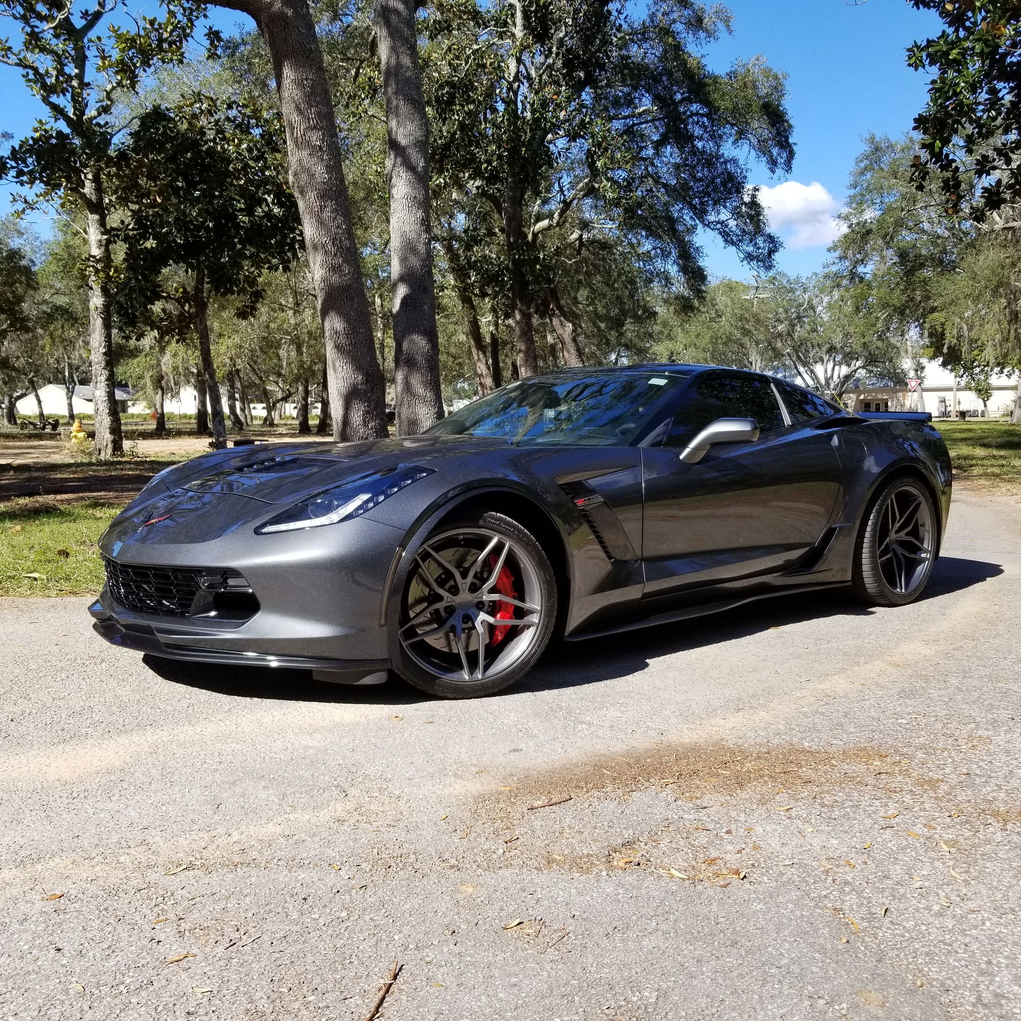

Originally Posted by C-141 driver
I replaced my OEM wheels... My choice was Forgeline F01 in Black Ice finish for my 2019 GS. There are many wheel choices out there for your GS.
And here are my F01s in Anthracite.

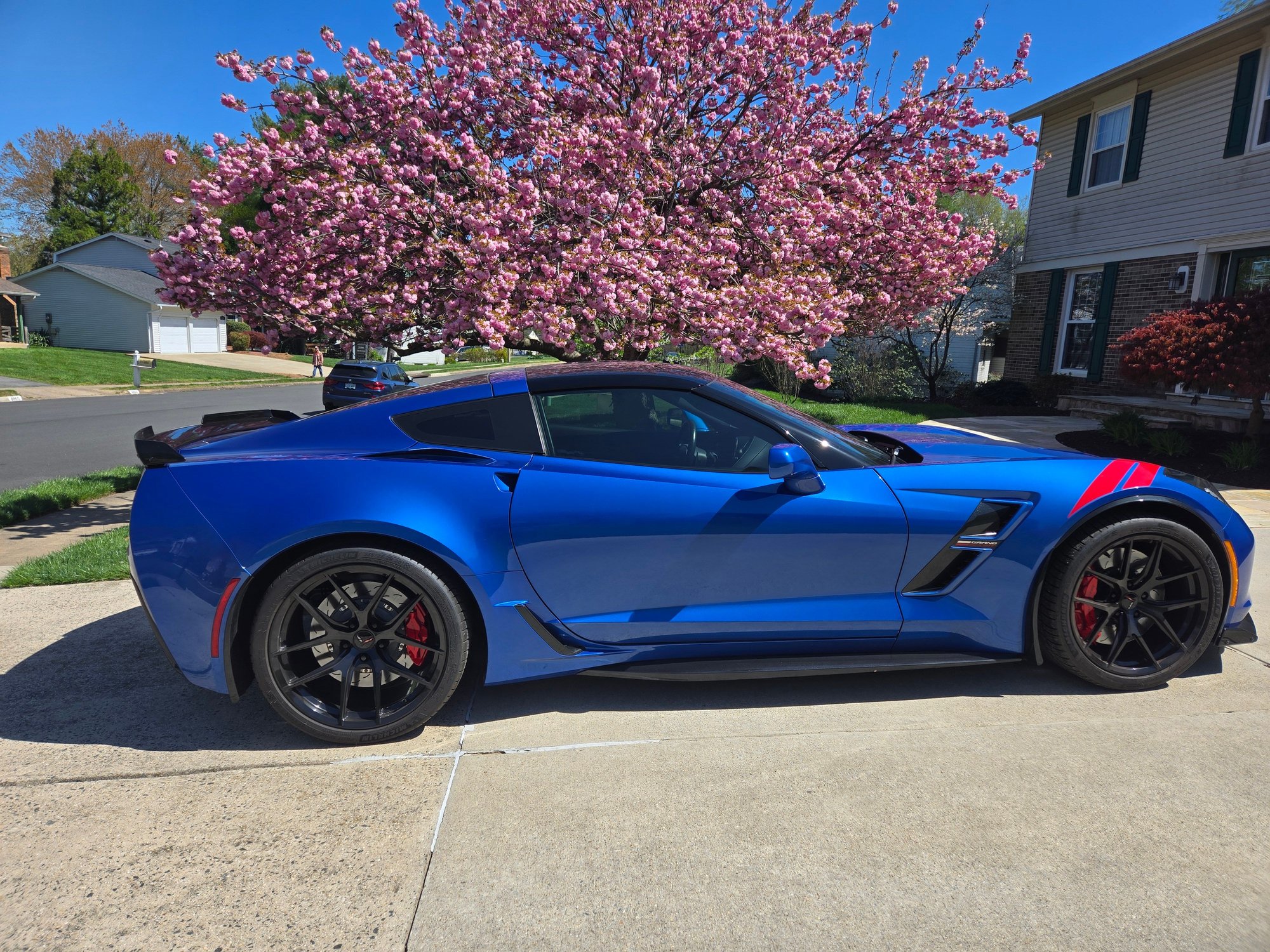

OP - Your best bet, if you plan to keep your GS, is to invest in a set of forged wheels. There are several businesses on the Forum that sell forged wheels. Price will vary from a couple $1K to several $1K. After meeting one of the owners and touring the Forgeline facility in Dayton, OH, I selected the wheels in the below pic. I am very satisfied with the wheels and the buying experience with Forgeline. Good luck.

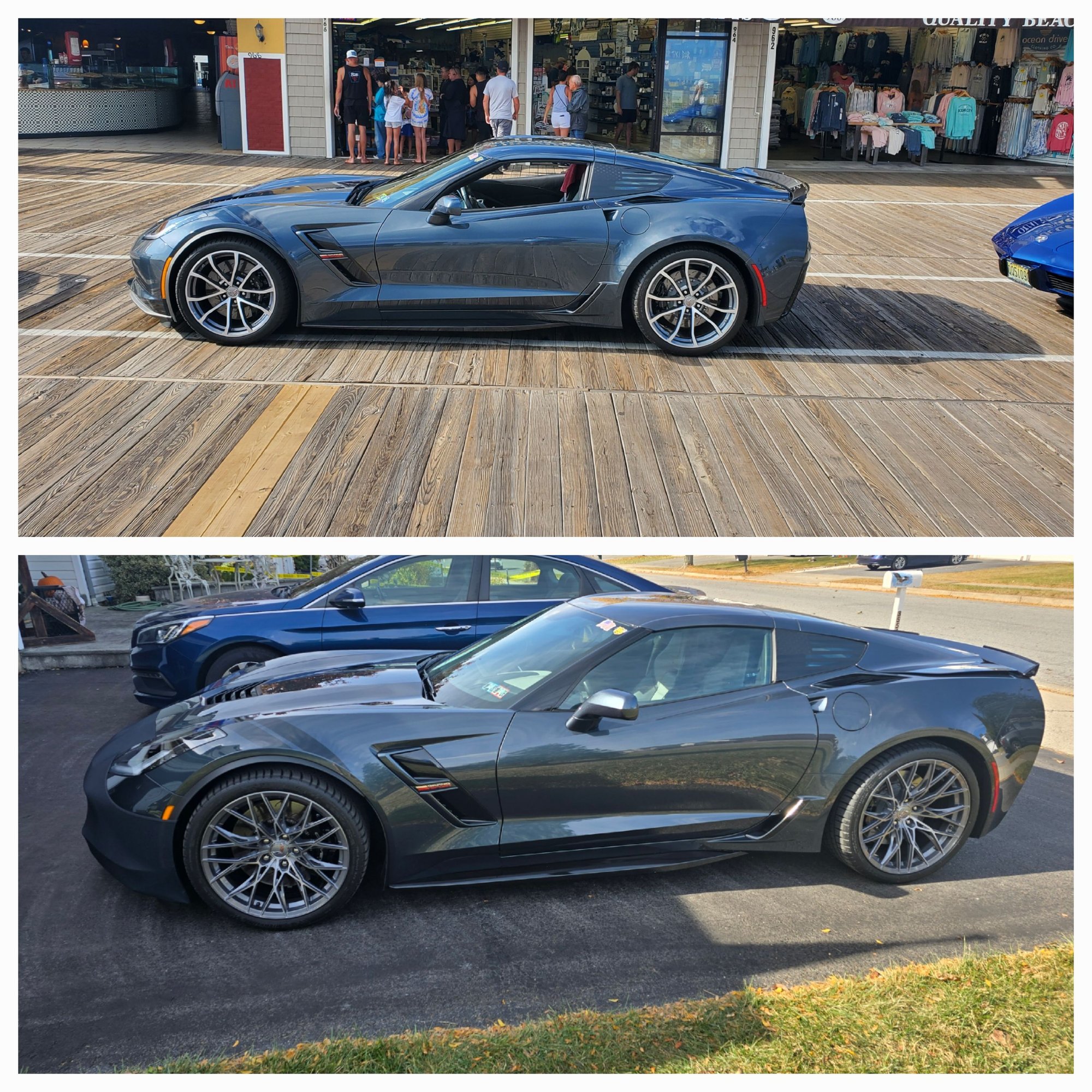

I went trough at least 8 wheels on my 19 GS between being bent or cracked. My Wife refused to ride in the car any more with the **** wheels. I didn't have a ton of money to spend on wheels so I looked around and bought new wheels from E5wheels. They are spin forged and were under 3K for the wheels. Dante at E5wheels was great. Top pic with OEM and bottom with the new.
I went trough at least 8 wheels on my 19 GS between being bent, cracked or both. My Wife refused to ride in the car any more with the **** OEM wheels. I didn't have a ton of money to spend on wheels so I looked around and bought new wheels from E5wheels. They are spin forged and were under 3K for the wheels. Dante at E5wheels was great and I had the new wheels in a few days. Top pic with OEM and bottom with the new. I met them a Carlisle last week and they were very nice.
