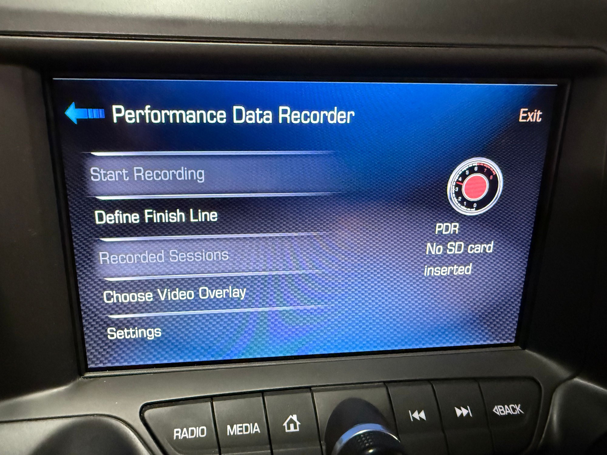

Can anyone tell me why I get error message saying no SD card installed to accede my PDR when a card is installed?
I have card installed why this message?

What capacity is your SD card?
Someone will know for certain, but I think 32G is the max size...

Could be the issue it’s 512gb.

You can use a larger card, but all cards must be formatted to FAT32. You can find online formatting programs to do FAT32. Most 32GB cards are FAT32

Agree - SD cards must be formatted Fat32. Cards larger than 32 gb must be formatted by a third party utility. I've had SD cards as big as 1TB work.
But - note that a 32 gb card will hold over 11 hr of recordings. Also - stop / start every 90 minutes due to Fat32 file size limits. The recording will stop with NO error message. And - recording stops when the card is full.
NOTE - some SD cards have a write protect switch - must be OFF (slide closest to contact end).
Ron

and Belvin20 thank you I will look into formatting.

Same thing happened to mine.
I reformatted, and it started working again.

it's not recognizing it. I think max is 32 storage. Check that. 64 won't work.

Thanks I will try reformatting.
