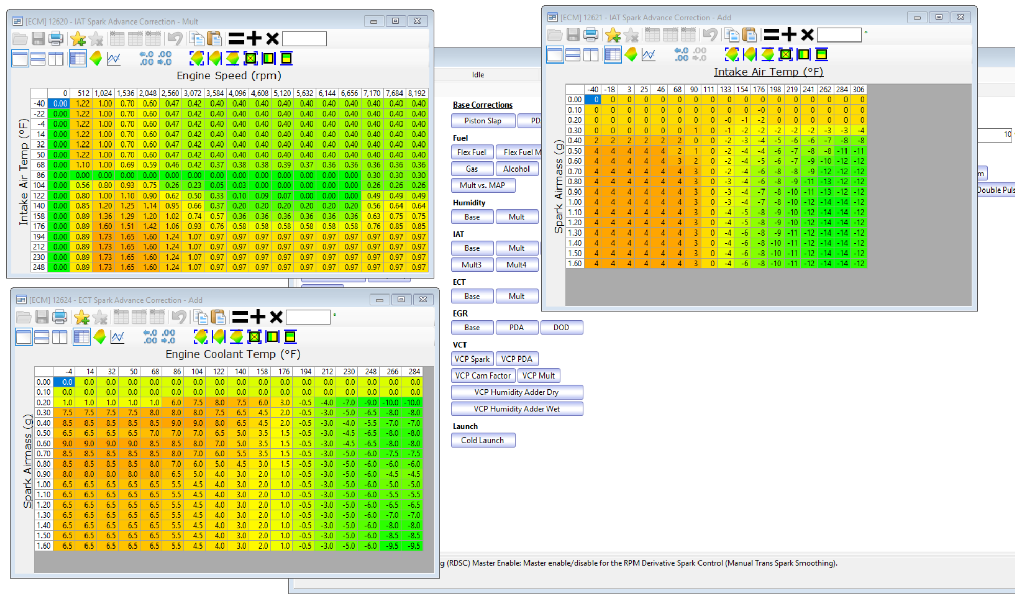

What the hell.....here's a tiny peek at *some* of the corrections. This is a stock file straight out of a 2018 Z06. You'll note there are corrections for IAT....inlet air temp, ECT....engine coolant temp, and then you see one of the multiplier tables. There are more albeit a couple of them are "1.0" (ie they don't do anything in this application). The tables are blended using GM secret sauce and of course the multipliers applied. Most notable is how sensitive the Z06 is to IAT. Not surprising on a supercharged car.
If you were to log these, you won't see any of the absolute values. These only give you an idea of how large the starting point is and where the PCM starts to make adjustments.
