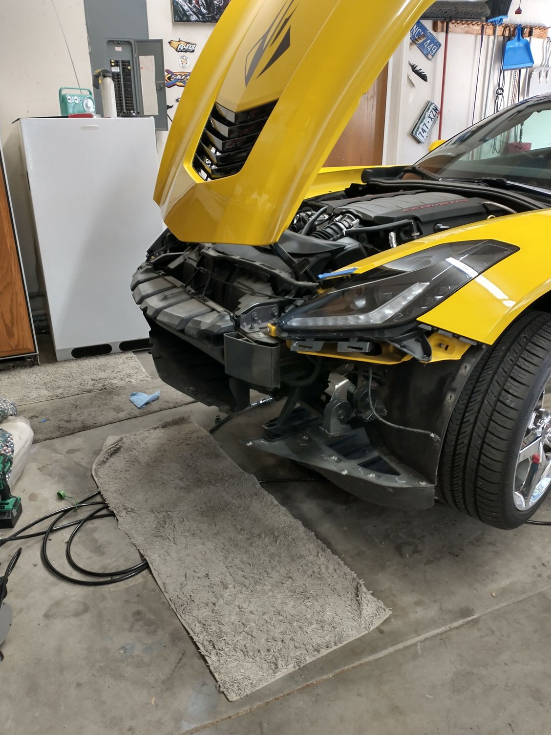

The front bumper attaches to the edges of the fender with brackets. There are two brackets, one on each side of the head light. In the pic, one has blue tape by it, the outer one you can see the 3 sections of the bracket. When you install the bumper, you want the bumper edge to line up with the fender edge. These brackets adjust the alignment. It's a pain in the butt to snap the bumper onto the brackets and then have to remove them. If you don't have to remove the brackets is the best answer. If you have to remove them, make note how they align so you can reinstall them correctly.
Info on removing the bumper:
When removing the bumper. The two connections around the headlights can be difficult. You have to push the bumper towards the gap, like you are trying to close the gap, then lift straight up.
