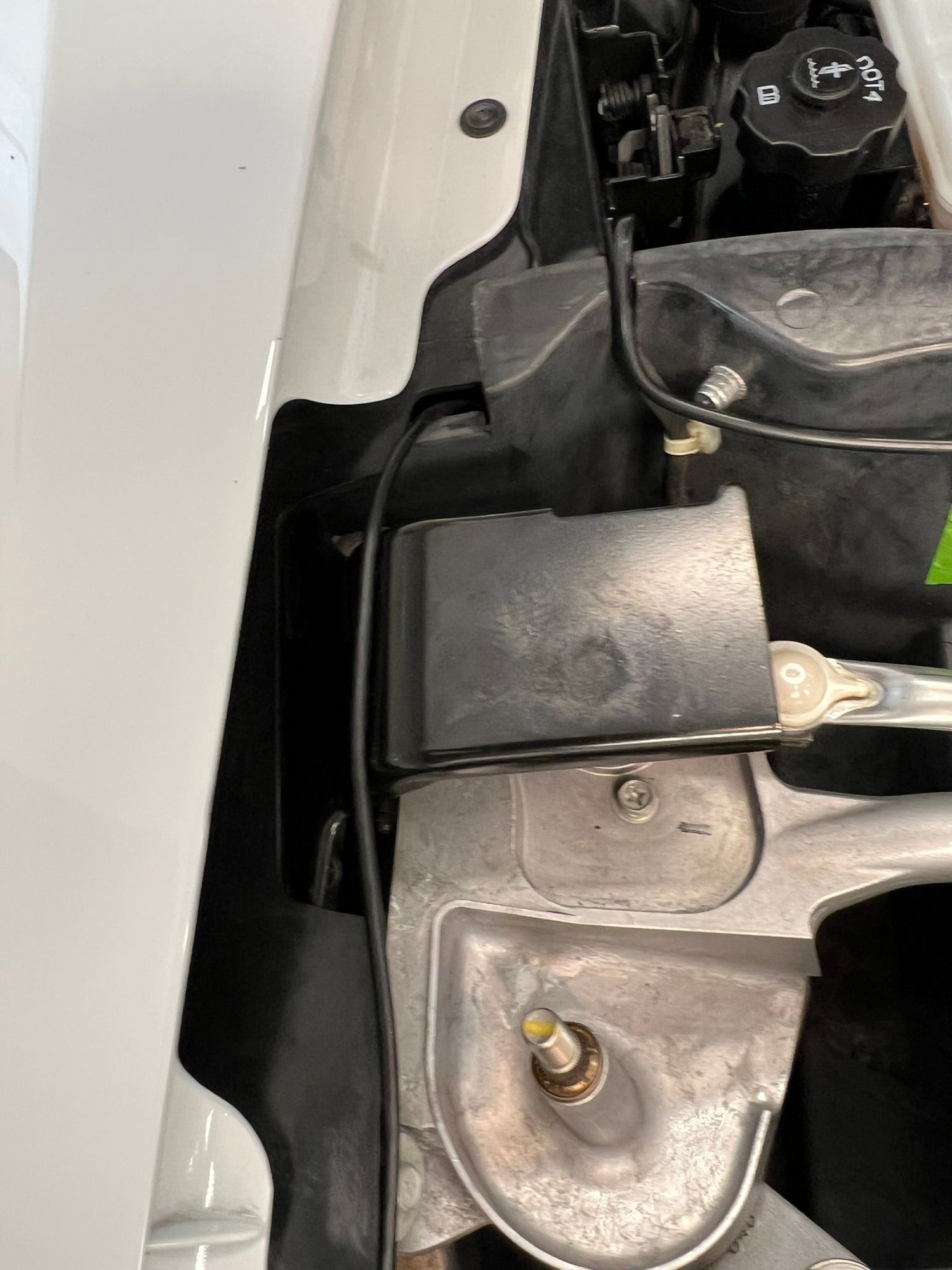

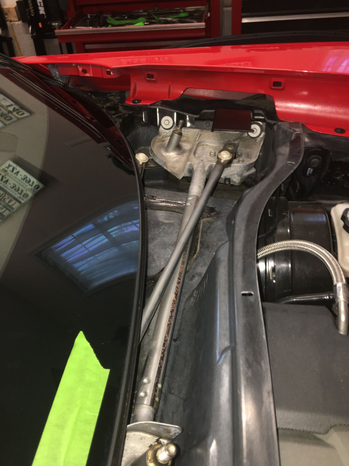

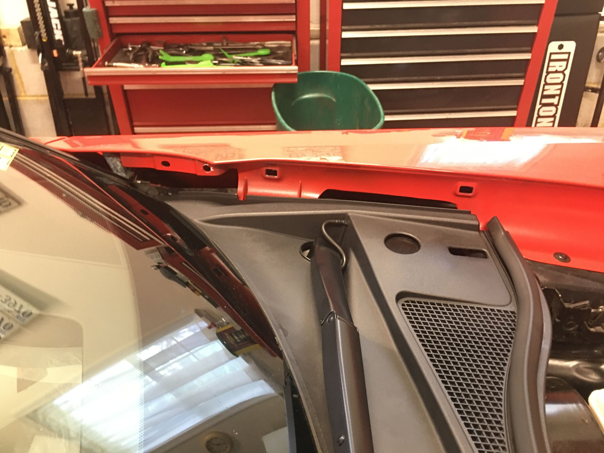

Here's a series of pics I took a while back that'll give you a heads-up to what lies ahead - -

As long as you have a trim tool to pop loose the couple retainers, the rest of the job takes about 15 minutes. To make it easy to reinstall the wipers in the same place, use a Sharpie or paint pen to make an alignment mark.
@Catfish4818 pics show everything perfectly. Very simple task.
If you look close in the two pics you can see my alignment marks on each post in order to locate the wiper arms upon reassembly.
