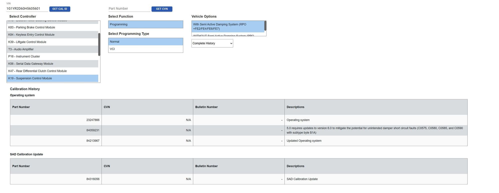

Hi all,
I recently had the MRC upgrade performed on my 2017 Z06/Z07. The dealership initially had a tough time getting the information but in the end seemed to get it right. They produced the instructions that I have seen floating around the forums referencing Instruction ID PART 84353676 and document ID 4873206. This seems to be correct and the upgrade was performed. I "think" I can feel a difference but the warm fuzzy of checking the AC Delco TDS/SPS calibration information is not showing what I have seen for others to confirm the upgrade. I have attached a screenshot of what I am seeing so far about a week after the upgrade. Is this something to continue to pursue, or just assume it's done and the money spent was worth it. I was charged 375.00 so that checks out for pricing as well. Appreciate any inputs, thanks.

It may take a while for the site to update. I had mine done this spring and it took a week or so for it to show up. Also I didn't notice a big difference after the calibration at first, but after a few weeks of driving it was more notable.

Awesome to hear. Thank you for the quick response on this. I will keep checking periodically for the site to update.

Wanted to update this post. As of 13 Feb 2026 the site still doesn't show the update.... Now I guess I get to have fun talking to the dealership.

I just did mine recently and it shows. Your dealership probably did something wrong.
