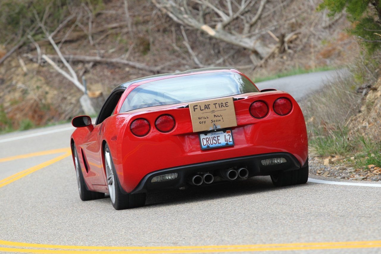

Our first modern Corvette (2001) came with runflats and we've stayed with runflats on all of our 'vettes ever since then.
We sometimes take long road trips to places far in the boonies, and I wouldn't consider anything else.
If your car is just a weekend toy for local driving where a flat wouldn't be dangerous or too inconvenient, then non-runflats could be a reasonable choice.
The one Corvette flat we've had was at the end of a narrow twisty road, far from help, near the south end of the Tail of the Dragon in NC. Sidewall cut that couldn't be inflated or plugged, and was not repairable.
We called ahead to a tire shop about an hour away, hopped in the car, and "drove the Dragon" at slightly reduced speed to the shop. It took a couple of hours out of our trip but nothing more- no flatbed, no trying to remove the wheel and find transportation to the shop, etc.
