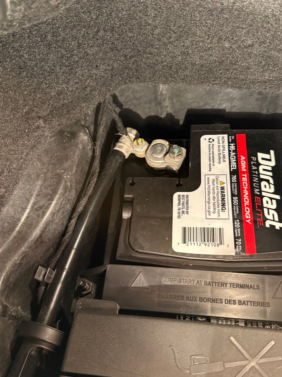

Here’s what mine looks like. There is no “stud” connected to the body or anything else, just the cable from the negative terminal on the battery. Why not connect the charger negative cable right there?

Not just ChatGPT--but I agree, need to take that AI with a grain of salt--but like mentioned above, almost every car manual and charger instruction manual states to connect the negative clamp onto a grounded metal position on the car. And yet, I've also used the neg battery terminal in the past. I guess I could unbolt the two lug terminals, and charge the battery as if it were just independent of the car.

The owner’s manual doesn’t address charging, but it does address jump starting. It says to connect both cables directly to the battery posts. If it’s safe to jump start that way it’s safe to charge that way. Quit overthinking this and quit using ChatGPT.

Since the C7 battery is in the back, and has extremely long leads to fuse boxes and the like you just use the terminals. In most other cars you can use the positive terminal and the "ground loop cable" (aka the other end of the small cable that connects the battery to the frame) as jump points but the negative cable on the C7 doesn't connect to the frame, because the frame is not ground.
