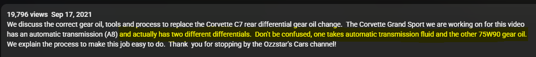

Getting ready to swap out the differential fluid on my 2017 Grand Sport and was watching some videos on it and came across this one. The guy says the car has 2... the standard traditional one that takes gear oil and the eLSD that takes ATF. He only shows the regular one in the video. Anyone know what he's talking about?
