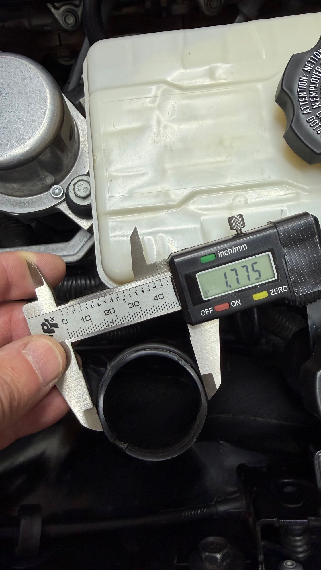

Can you confirm that your windshield fluid tank is original? Maybe its time to grab a caliper and measure that outside diameter
I have 1 3/4"
the ring that goes with the cap needs to be smaller than 1 3/4 to stay behind, I will think that it can stretch a bit to go over that. I didn't try on mine as 10 years old most likely will just break

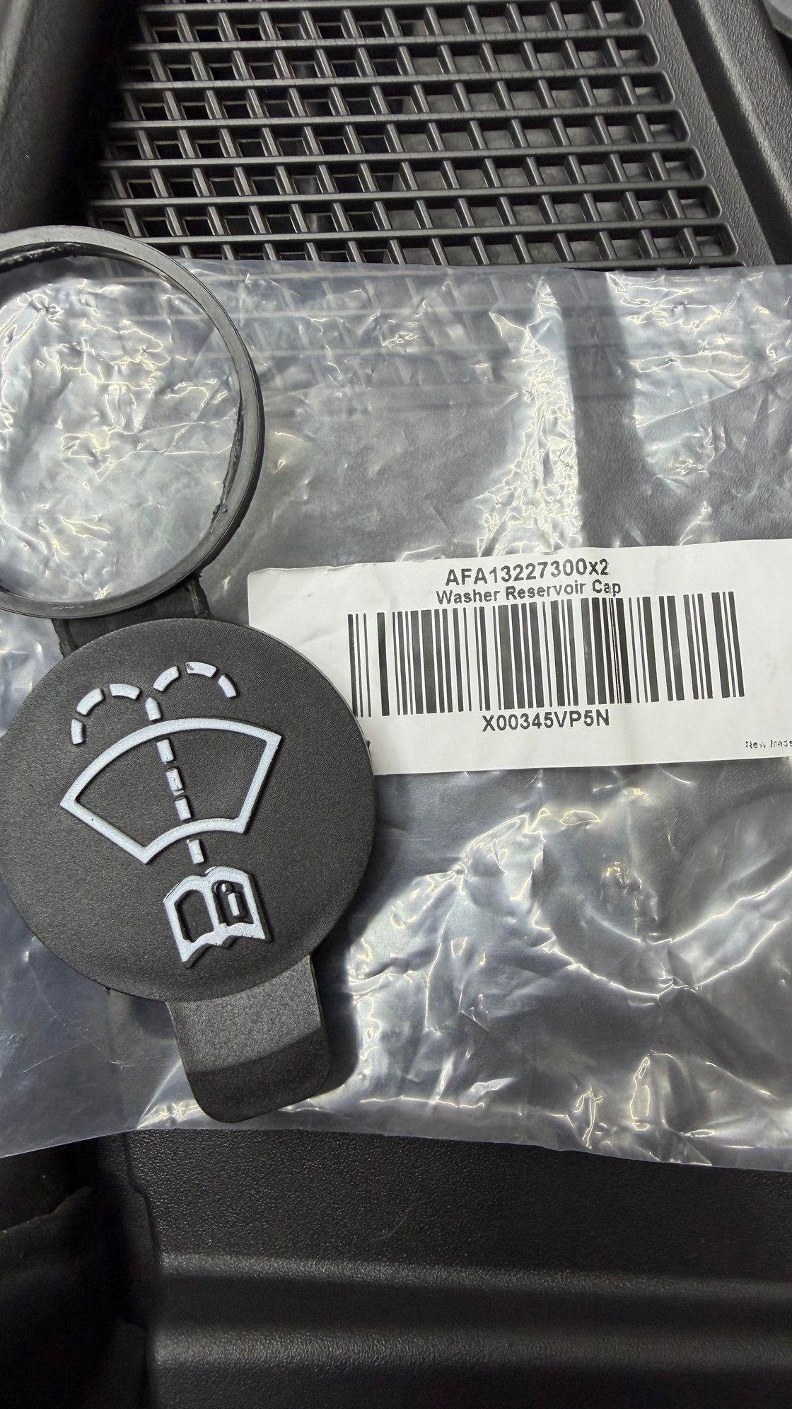

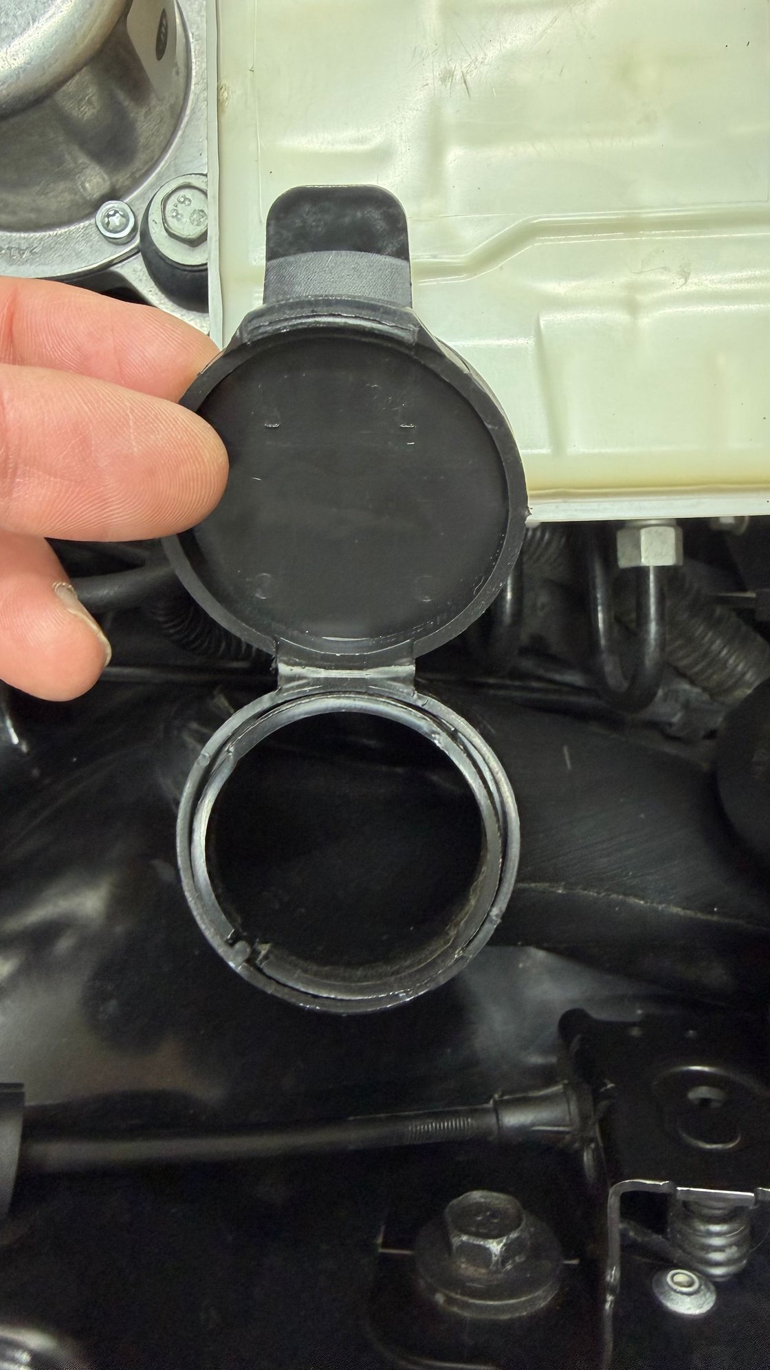

Originally Posted by Laguna Blu
I did order that one and the ring was way too small to go around the neck of the filler tank. Not sure how it fits on yours???
Video of unaltered cap being installed and Amazon packaging
Same cap except I removed white graphics/paint
Cap open and attached to reservoir
Measurement of reservoir neck - note small cut out area that accepts notch in washer cap so it doesn’t rotate
Actual cap and Amazon packaging
