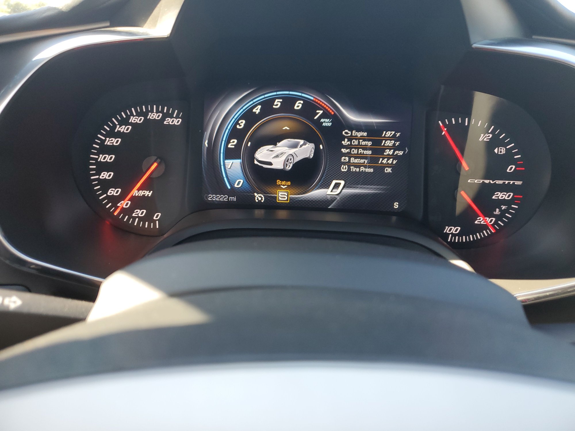

Please indulge a senior citizen antique car collector with a faulty memory as I've asked this before, I think. I enjoy the Tour screen to the right of the speedo that lists water temp, oil temp, tire pressure, volts and Tire Pressure OK, in a list. Perfect. But every time I navigate away from it I cannot find my way back.
Can one of you supply a step by step? Its a 2019 GS M7.

Here's a quick guide from another senior:
You want to select TOUR mode (not Link to Drive Mode), then Perf.
NOTE - a WHITE arrow <>^dn means you can scroll that way for more choices, a GRAY arrow means no choices that way
- Use the steering wheel buttons under your right thumb.
- Scroll left, down to Options / Settings, push OK button
- Scroll down to Display, scroll right.
- Choose Link to Drive Mode, Tour, Sport , or Track. Push OK
- Scroll left 2 times, then up/dn to Info, perf,,, Select View you want and push OK
- Scroll up / down to the detail you want.
HUD display:
- Click the left toggle to get the desired view
- The middle toggle raises / lowers the display
- The right toggle is HUD brightness
Pat yourself on the back when you get the displays you want.
