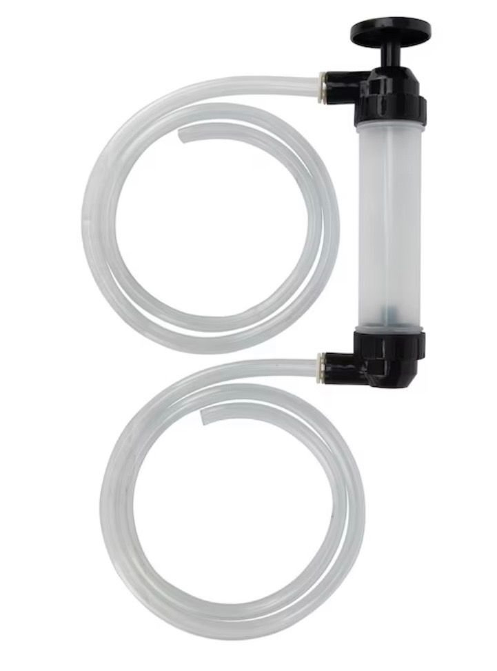

I bought this siphoning pump at AutoZone for $17. It says it will siphon out low viscosity oil. It is a hand pump and it works well.
