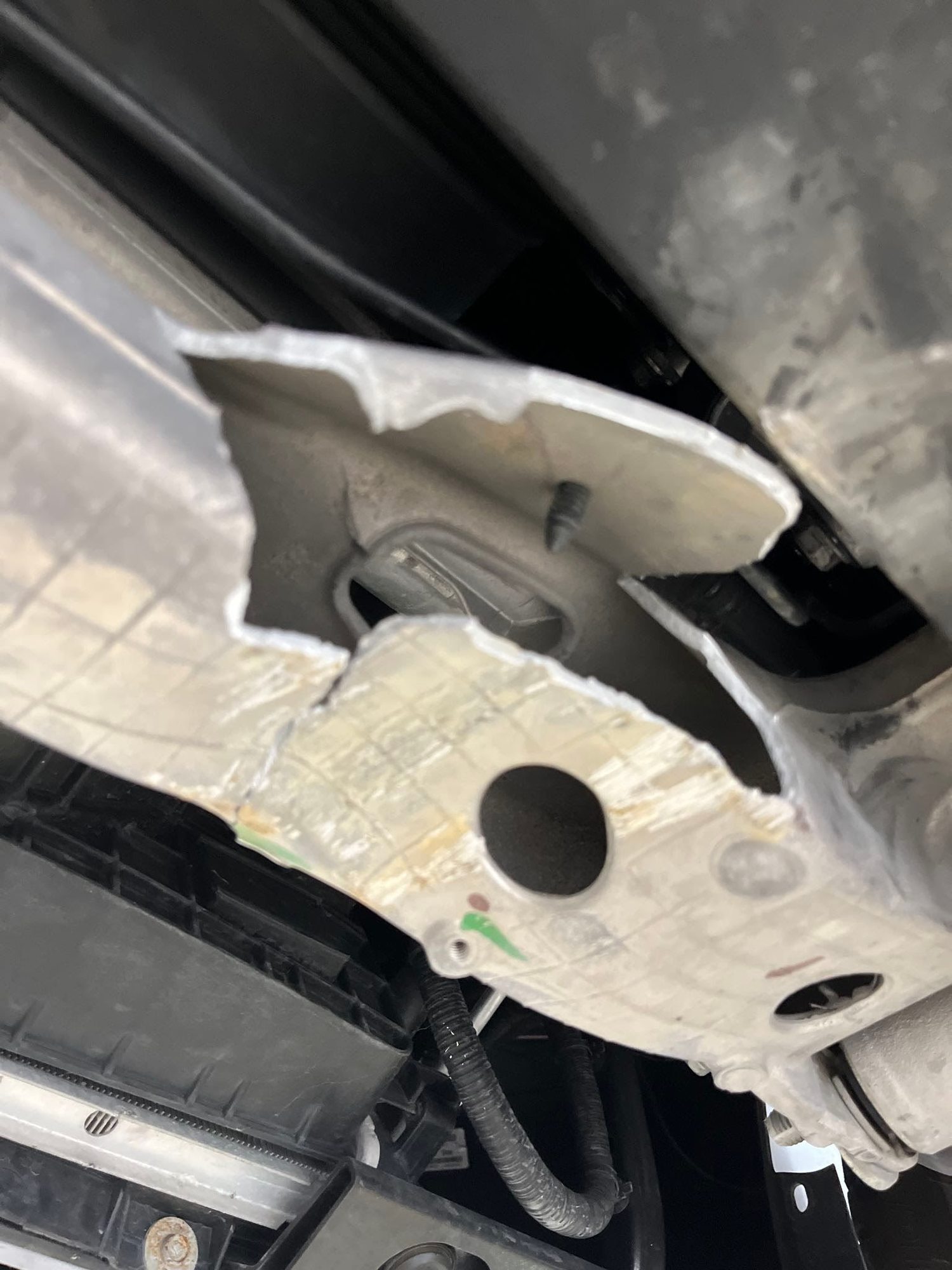

Here's a photo of the front "engine cradle" that was hit by the rock. This is pretty much the extent of the damage except that the ripped piece is wearing into the front spring. The rest is just scrapes on the exhaust, oil pan and "center reinforcement" and purely cosmetic. As I posted earlier, I drove it home 600+ miles without issues, no leaks no temperature issues, nothing at all. Guess I got lucky. Seat belt pretensioners did deploy so that's another parts/labor issue. And there's absolutely no body damage! Rock sheared off the deflector below the splitter but never touched the nose piece/paintwork.
Old May 13, 2026 | 10:47 AM

Old May 13, 2026 | 10:48 AM
PicaVette's Avatar
PicaVette
Joined: Jul 2025
Posts: 210
Likes: 276
Ouch...

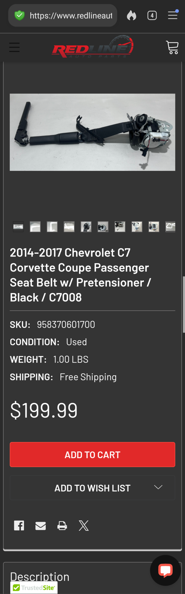

that cradle new is like $1k, used like $350... splitter depend on which one can start around $100 - $200...
the seat belt with the pretensioner could be found for $200
maybe you are lucky after all and can avoid using the insurance for these

Originally Posted by PicaVette
Ouch...
I am impressed.
You are a great detective and online shopper!

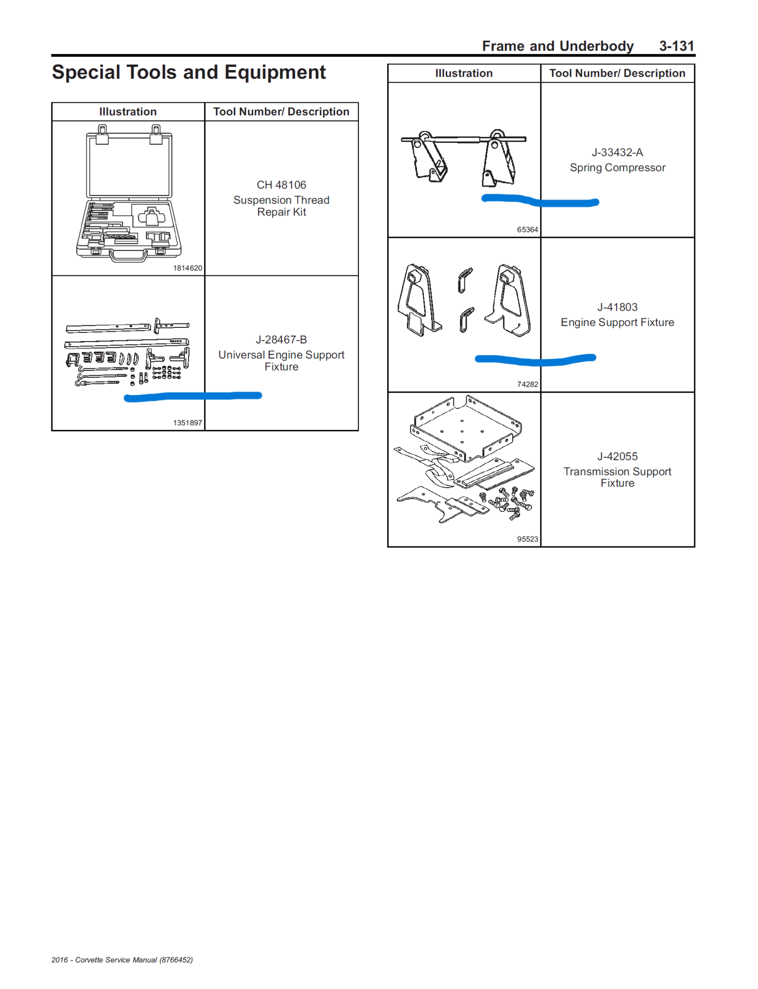

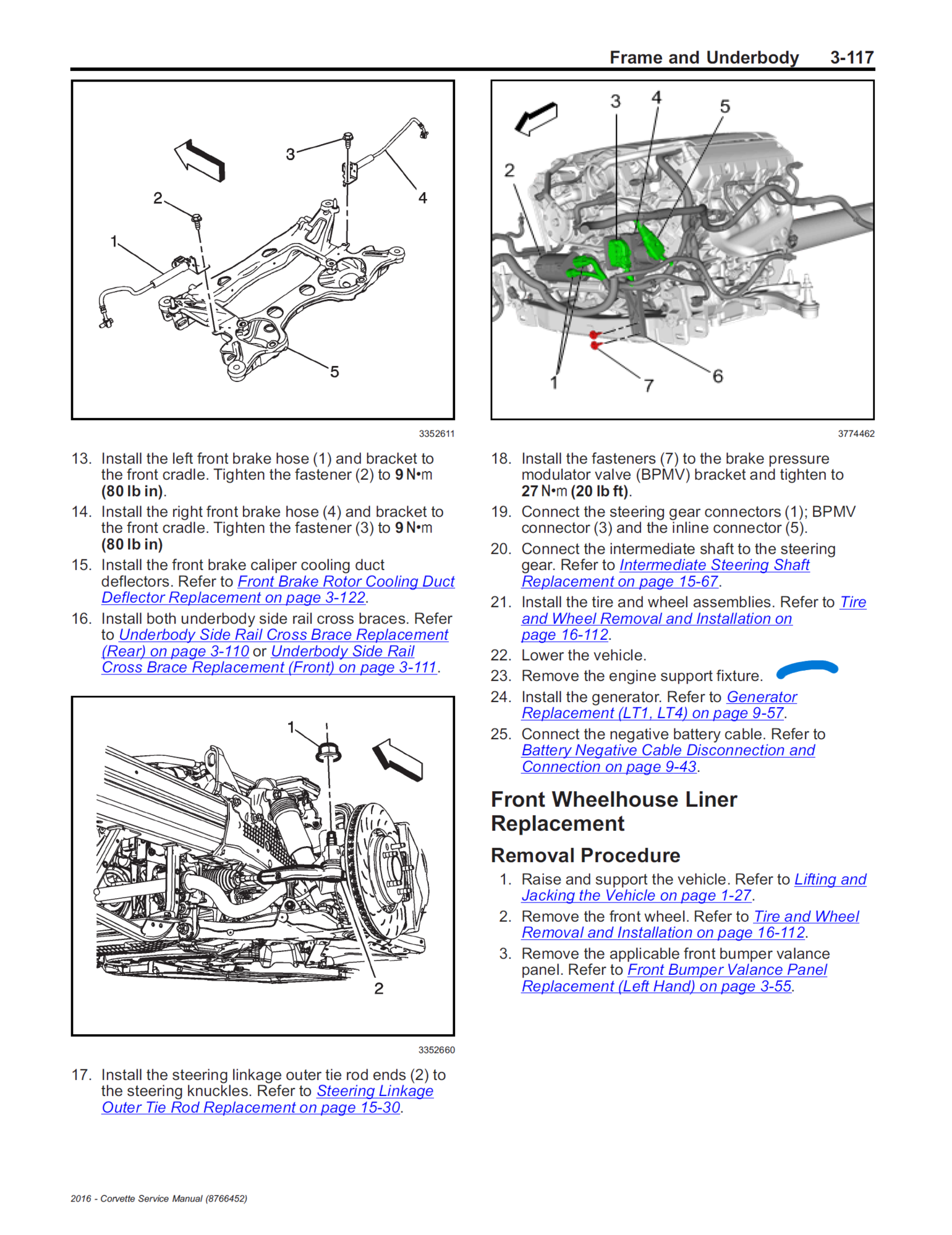

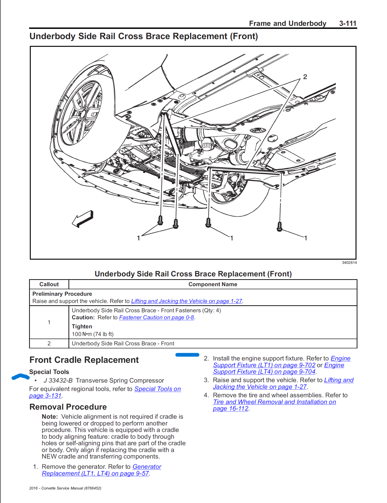

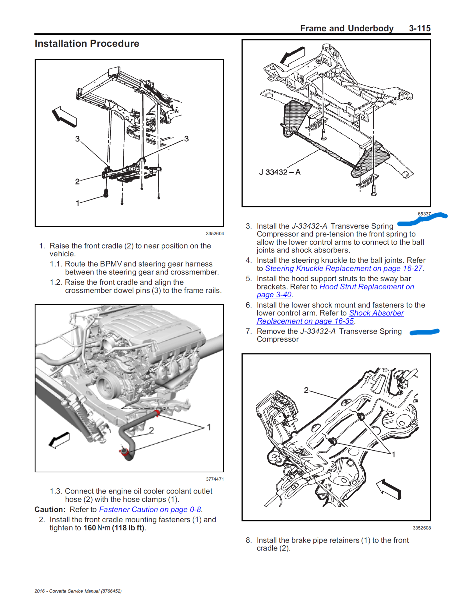

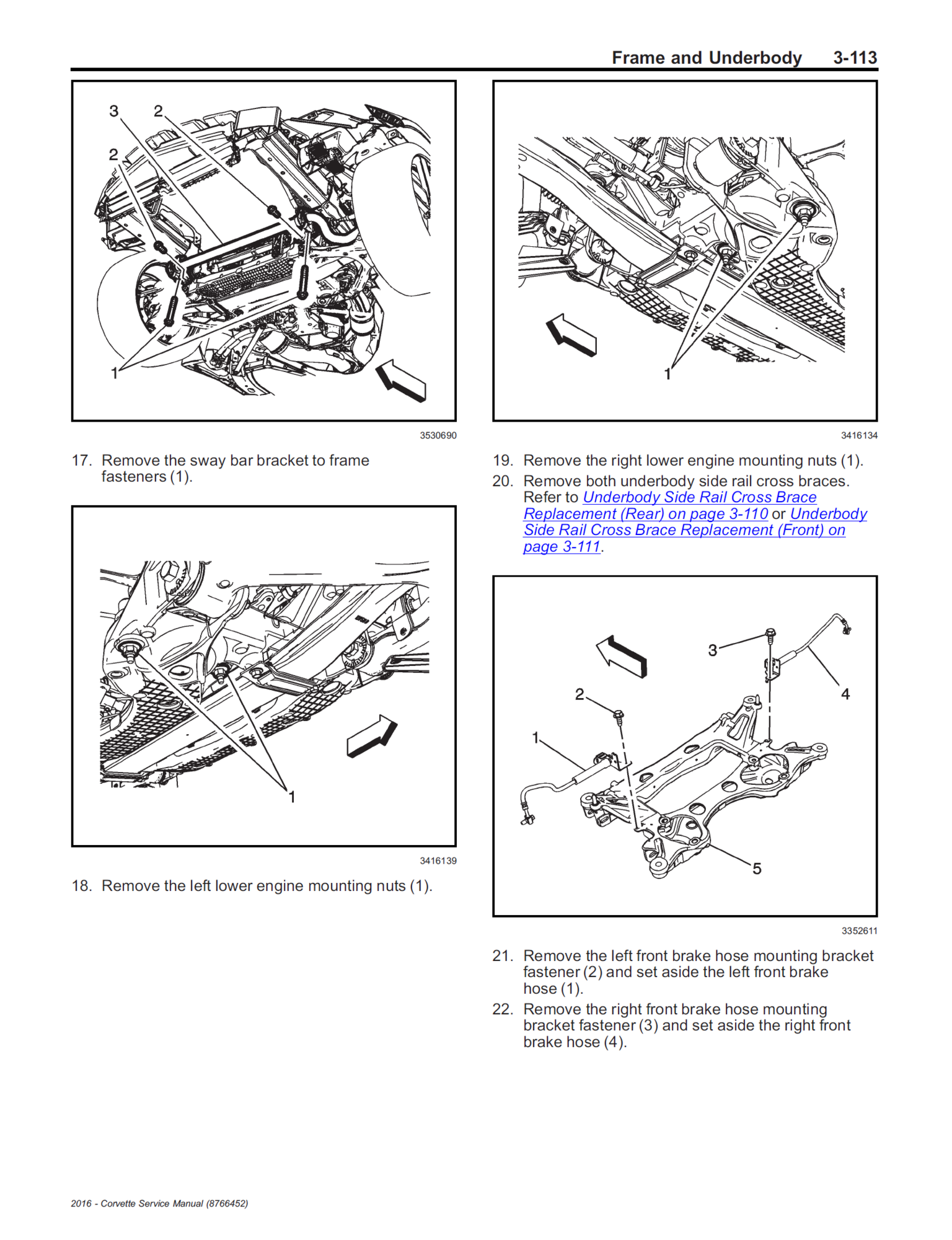

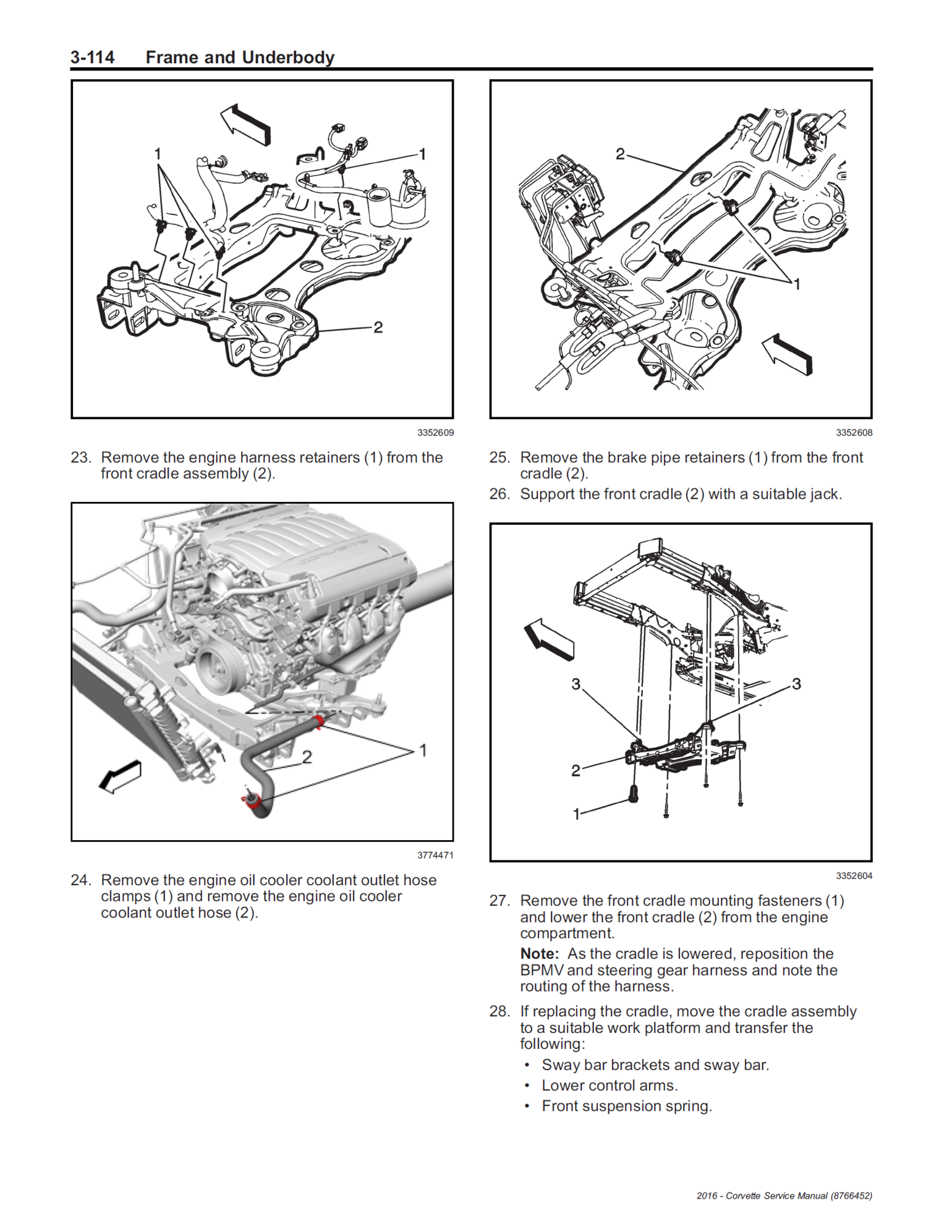

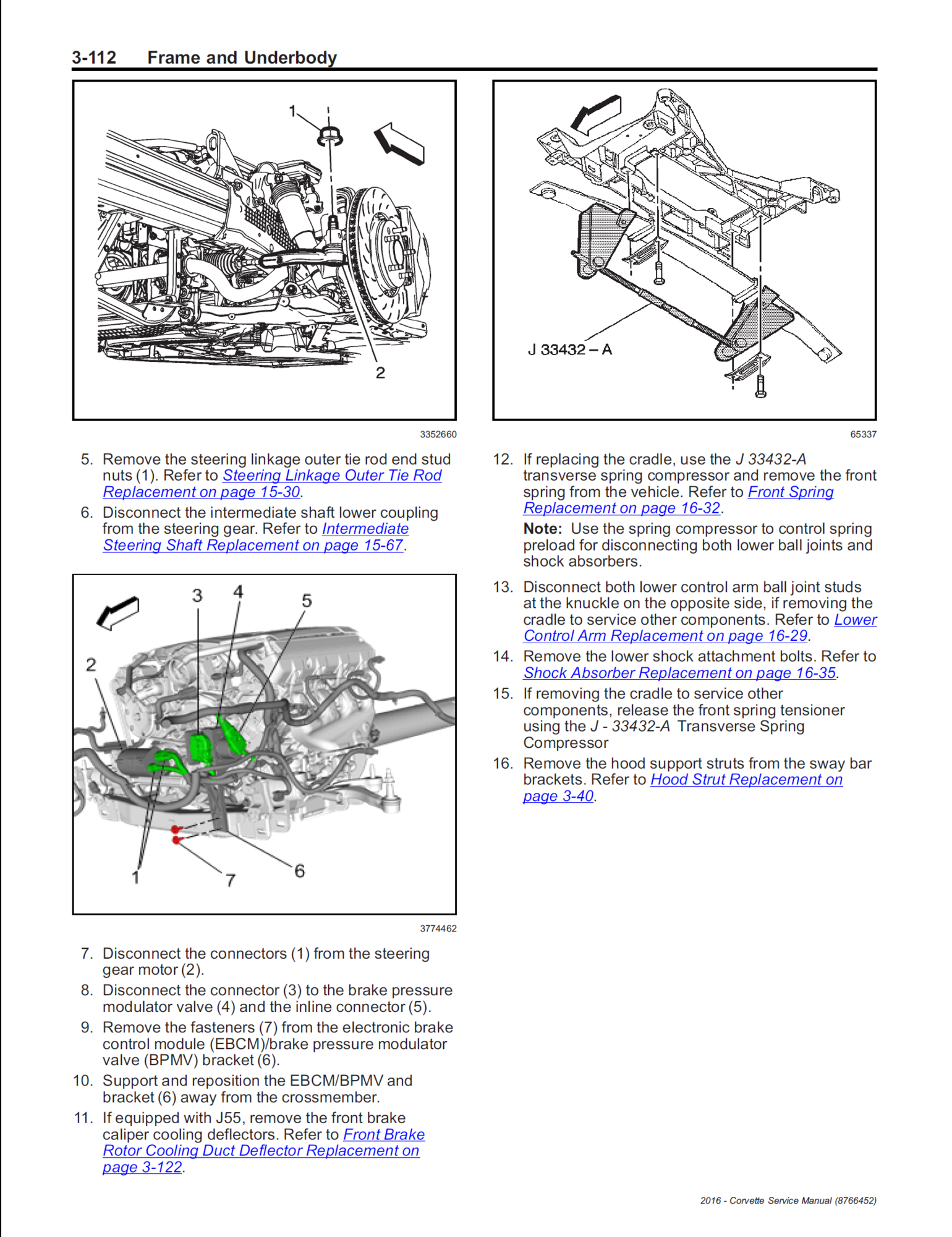

OP: Was the rock moving or standing still when you hit it? That makes a difference to insurance. If it was moving, the incident is chargeable on the Comprehensive Part of your policy, and if it was standing still, it is chargeable on the Collision part of the policy. Charges against the Comp Insurance aren't chargeable accidents and don't impact your rate or erase safe driving discounts. If you selected a lower deductible for Comp Coverage, then you may have a lower payment to the body shop.
That cradle needs to be replaced. It isn't safe to drive the car with it that way, which means the shop doing the work needs to have an engine support fixture and a traverse spring compressor to hold the engine in place while the cradle is out of the car.
Bill
Very useful and detailed information!
Looks labor-intensive, so I hope the OP's insurance covers the replacement.
