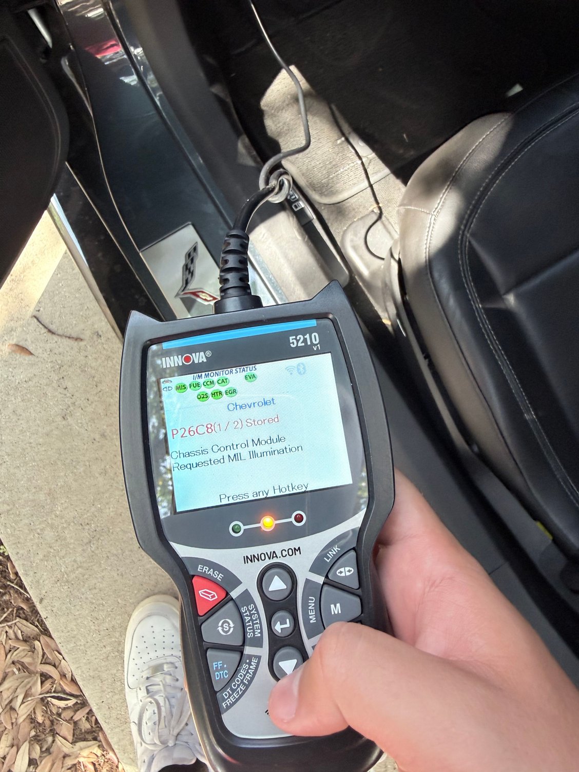

Hi I just bought from Corsa performance a valve back corsa xtreme exhaust with a x pipe. I have a 2019 C7 Corvette grand sport Auto that came with NPP getting the corsa xtreme exhaust with the X pipe was going to delete the NPP corsa
said that no check engine light was going to pop up, but I got a check engine light so I’m wondering what sensors or resistors do I need in order to get the check engine light to go away?

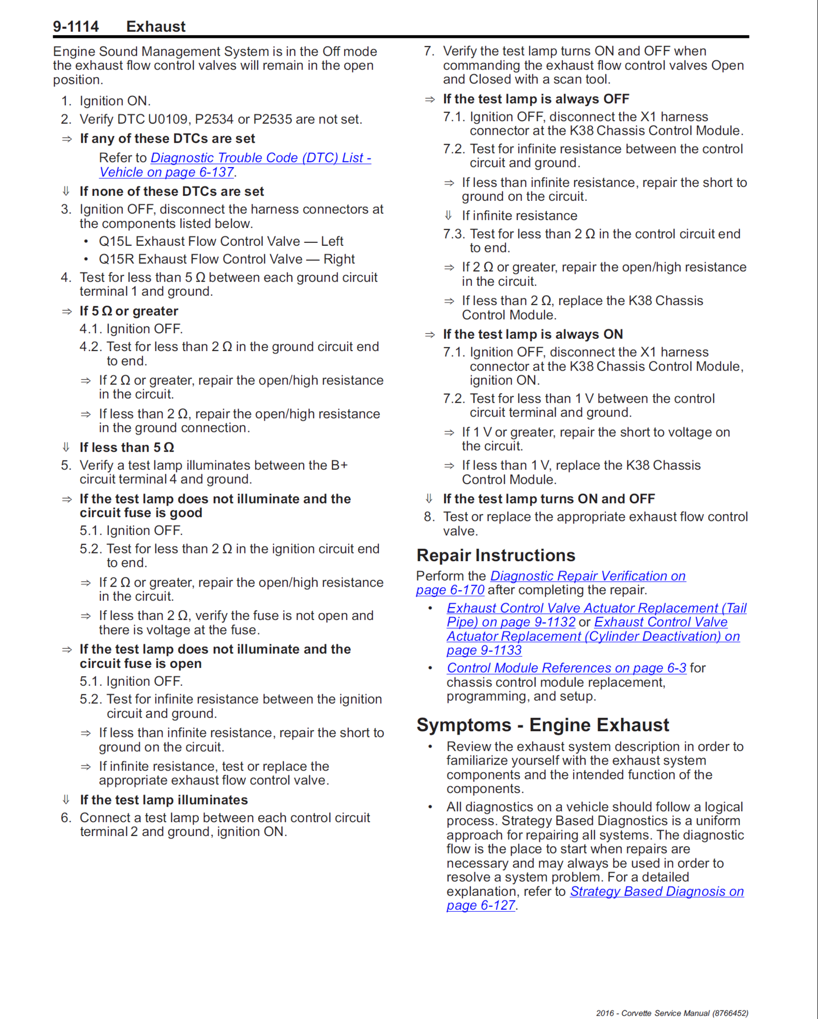

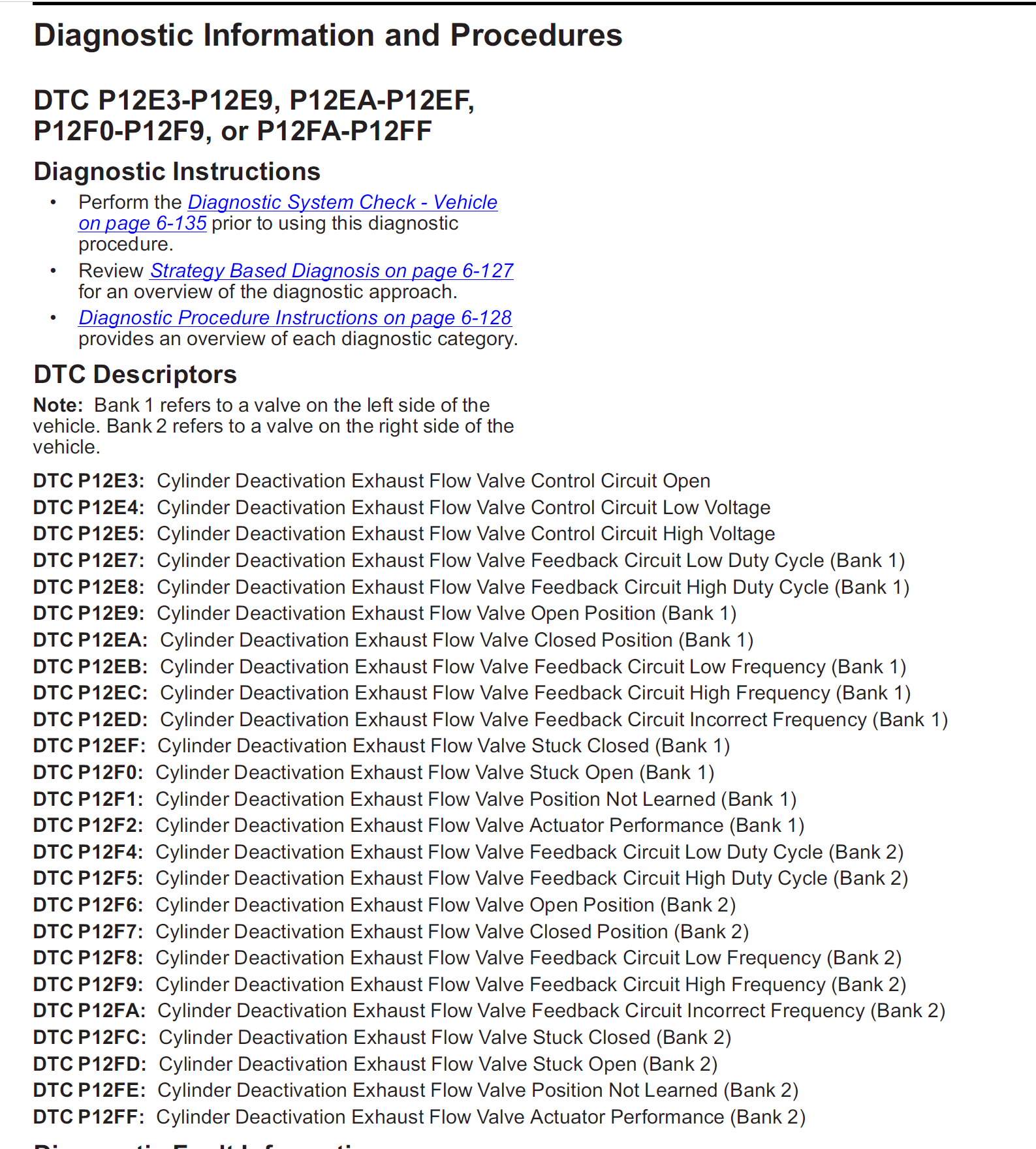

The wide-body cars didn't have AFM valves. You should only have the 2 valves at the muffler outlets.

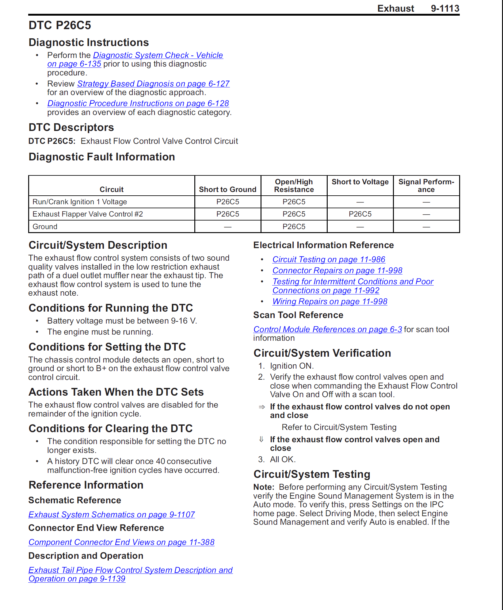

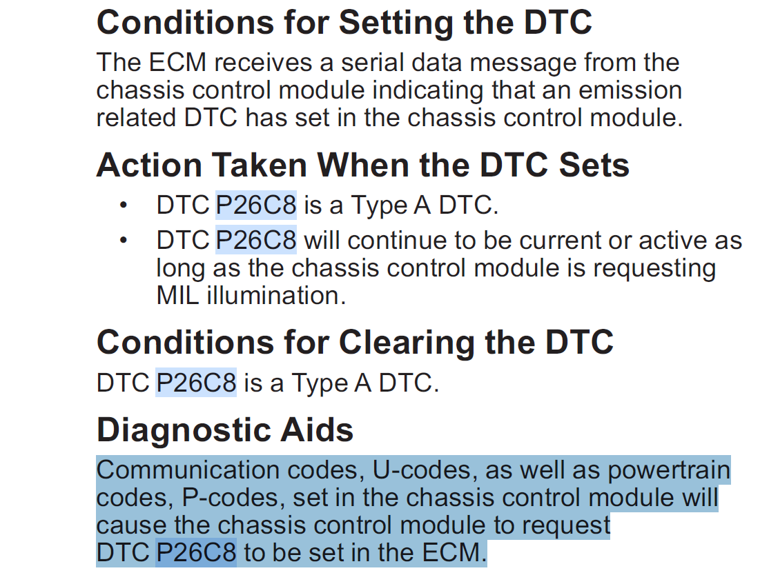

P26C8 may not have any connection to the exhaust valve failure as it is a general request by the Chassis Control Module to light the CEL due to a DTC being stored in the CCM. The DTCs that are related to the AFM valves are shown in the following picture:
The DTC for the muffler outlet valves is P26C5

I may be dumb but I’m reading the sheets and idk what I’m looking at the code it showed for me what p26c8
