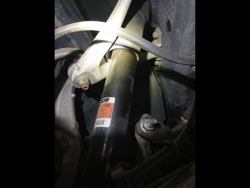

Hello all. Looking at buying my first Corvette, a 2017 Grand Sport with 39,000 miles. Had the dealer take it to a local shop (not a vette specialist) for a pre purchase inspection and they are saying the magnetic ride control shocks need replaced. I have read several places that these shocks will weep some fluid and that doesn't always mean they are bad. We had a 2020 Suburban that had magnaride and those lasted well over 70k miles. Also said the motor and transmission mounts are starting to fail, and the tranny, brake and coolant fluids all needed to be replaced, as it has been 2 years since these fluids were changed out (4000 miles). I am buying out of state...the car is in AZ and I am in CO, so can't run down there and check it out in person. Thought this would be the best place to get thoughts. Thanks in advance and we are very excited to get a vette and join the community!

From what I can tell, it doesn't look too bad, there will be some seepage with age.
If you buy the car, you can also have the magnetic suspension software update performed at the dealer -- I did on mine and was an improvement.

That does not look excessive to me and I would not be replacing them unless the ride is suffering as a result. Good luck with the purchase if you decide to go with it. I'm in Tucson. If it is in that area, I would be willing to hop on a motorcycle and go take a look at it.....I am no mechanic, but have had a couple Corvettes and replaced mag ride shocks.

Thanks fellas. My neighbor is a mechanic and also has a 17 GS. He said he was not worried about them based on the pics. Sometimes I think the mechanics doing a PPI feel they have to find some issues! Think I will move forward.

I don't think those MRC shocks look bad as they will weep like that. GM published a diagram that shows what an acceptable amount of weepage is. The GM TSB describing acceptable weepage is attached to this post.

Based on your shock pics, those shocks do not need a replacement, the coolant & trans fluid do not need to be changed out every 2 years. Buy yourself some cheap test strips on Amazon & check the brake fluid quality yourself

I believe GM says seepage down the top 1/3 of the shock is normal. I had one fail and it was puking fluid all over. The rest of my shocks look similar to that one. ~$400 from Rock auto and super easy to swap out.

Here's the GM diagram that Bill Dearborn and ^&right mentioned.

As an aside, based on what I know, the shock in the photo looks okay to me as well.
