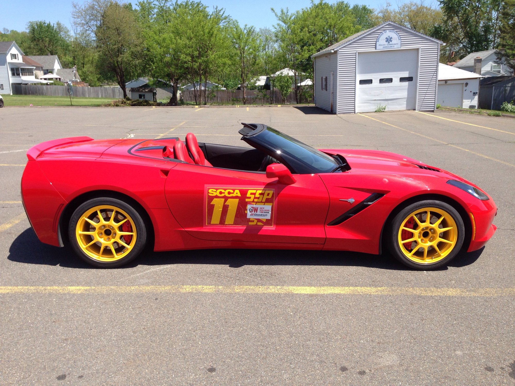

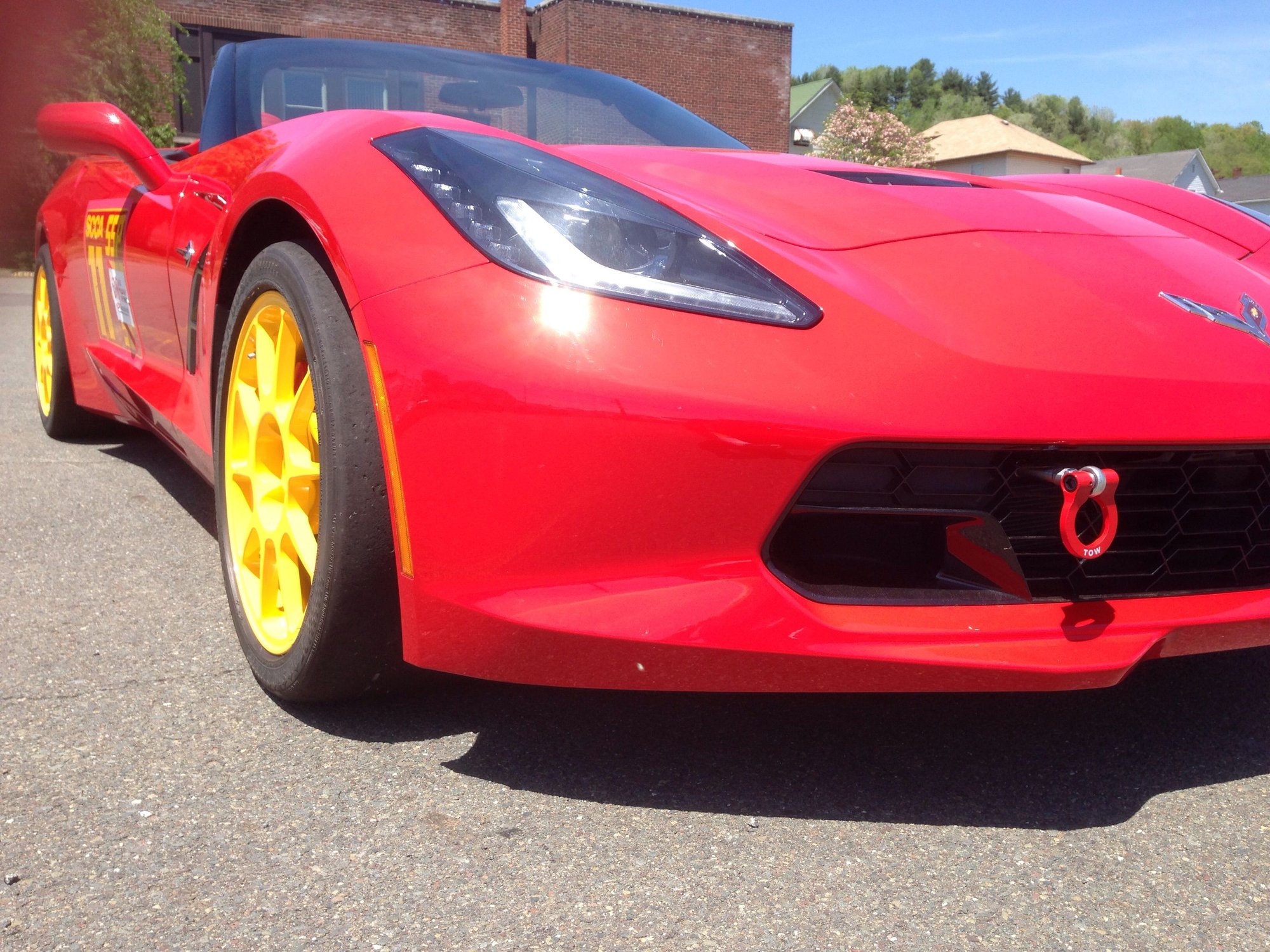

Here are some 18"s front and back that fit
