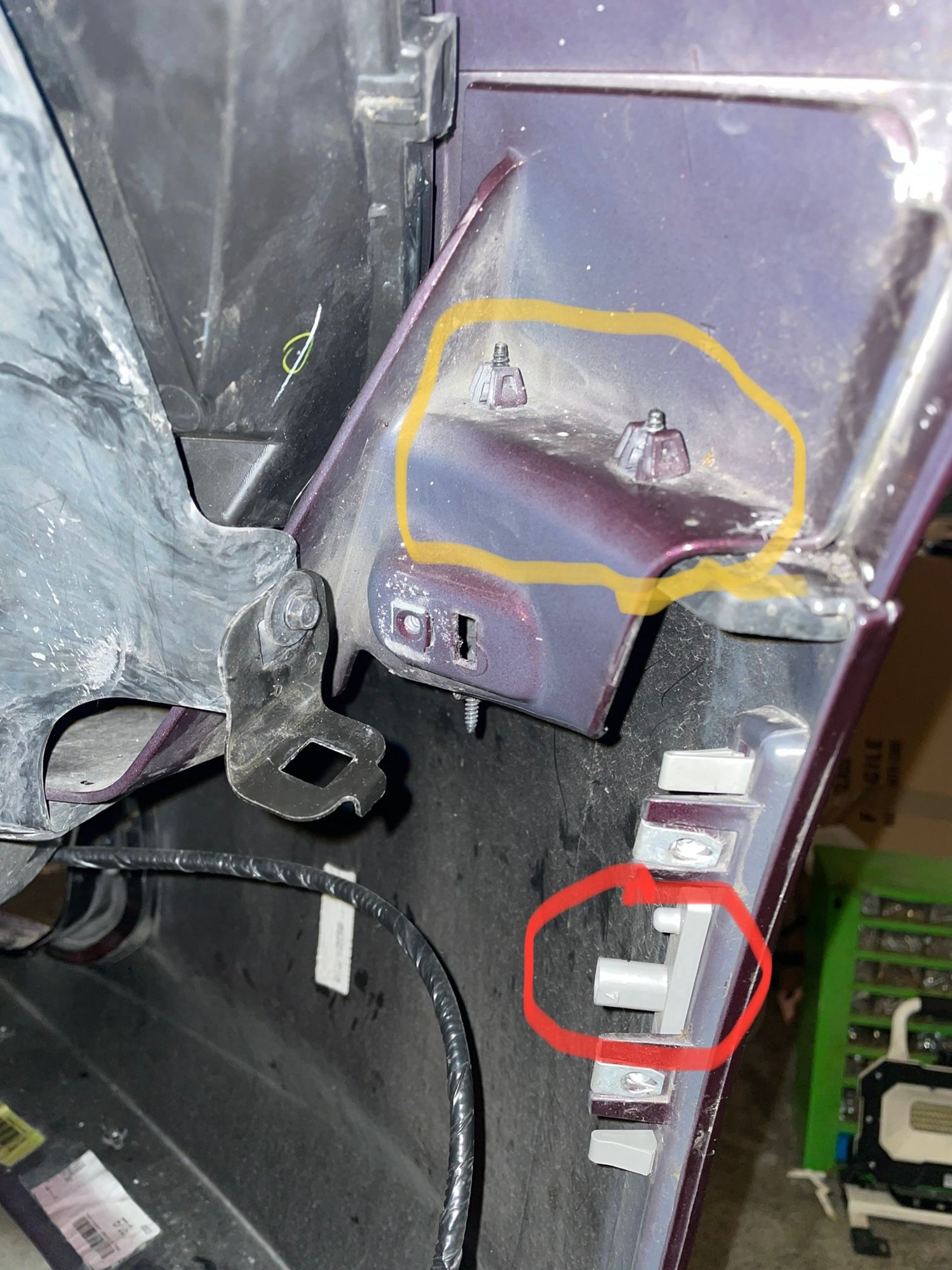

I blew my engine and need to remove the oil tank for cleaning (2017 Z06). I have the GM service manual and have read a lot of post. To get it out you need to remove the front right fender which requires you to remove the front bumper cover/Faicia (sp). There are two screws that appear to be connect the bumper cover to the front right fender. These seem impossible to get at.
I have included a picture to help. Circled in red is the right side side marker electrical connection for reference and circle in yellow are the two screws I am taking about. What am I missing here???
Thanks.

watch the video above and at the 4:10 point you will see what is going on there. you dont remove those screws those screws hold the clip that the notches in the bumper cover fit into. you may have to pull pretty hard to get the cover to come out of that clip but it will pop out.

That did it. Got it off. Thanks everyone.
