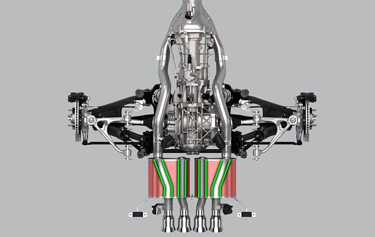

It could be your AFM (4/8 Cylinder activation) valves closing. Are you an automatic? These will activate in any mode. To keep it in V8, slip your shifter into Maunal.
The valves are just ahead of the mufflers and attenuate the flow by about 80% so the car doesn't sound like a fart can eqiipped Honda when activated.
Pic by Theta:
