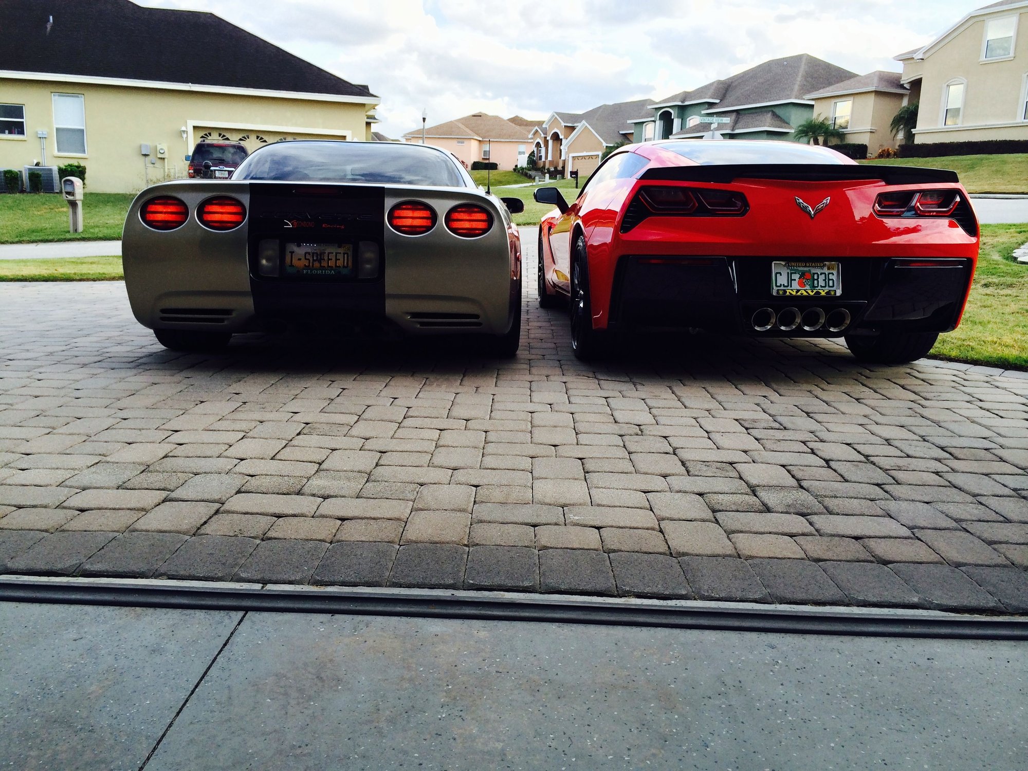

Default lowering, tires, alignment, stock run crap question
I have had the 3LT Z51 Stingray since october.
What is the widest tire size i can go to front and rear?
I am keeping the stock 19 front and 20 rims (stock Z51)
What tires would you recommend?
As far the TPMS, can I just go around magnetize to reset?
I have 8K on the tires, never tracked, what should I ask for the stock tires to sale them on here?
To lower the car, just take pressure of the parts around the tire and counter clock-wise on the stock bolts?
I would prefer a performance tire that's ok in the rain, but I actually drive this vette, Sounds like BS but it will not break the loose, but i hate run craps and that my stock twin turbo BMW has the same size rears...and it looks horrible from the rear.
Will it kill my Z51 tune/cornering ability if I go wider and lower?
Sorry about all the questions, this is my 7th vette, and this forum has helped with everyone.
