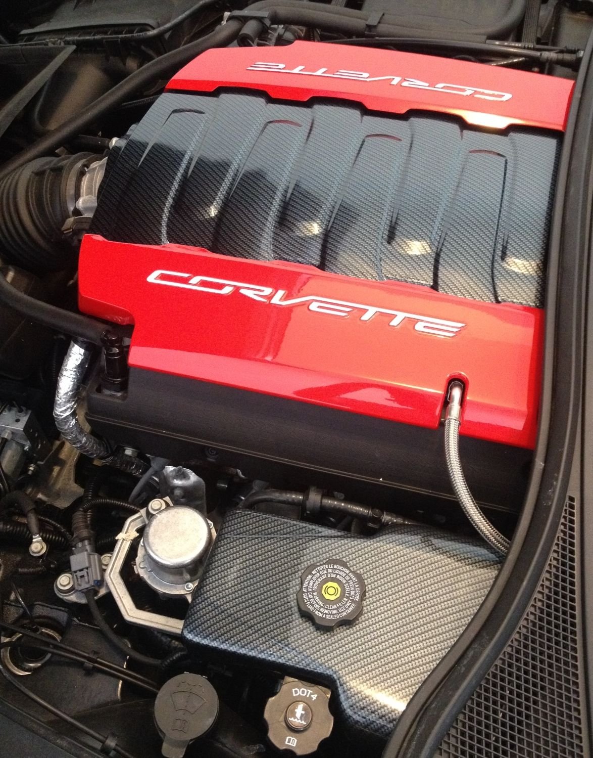

I just pulled with slow even pressure and wiggled a bit. It does take quite a bit of strength without a tool though. They all came out without damage. As for #2, I didn't mess with that as I didn't have lower covers.
Here is mine completed:
