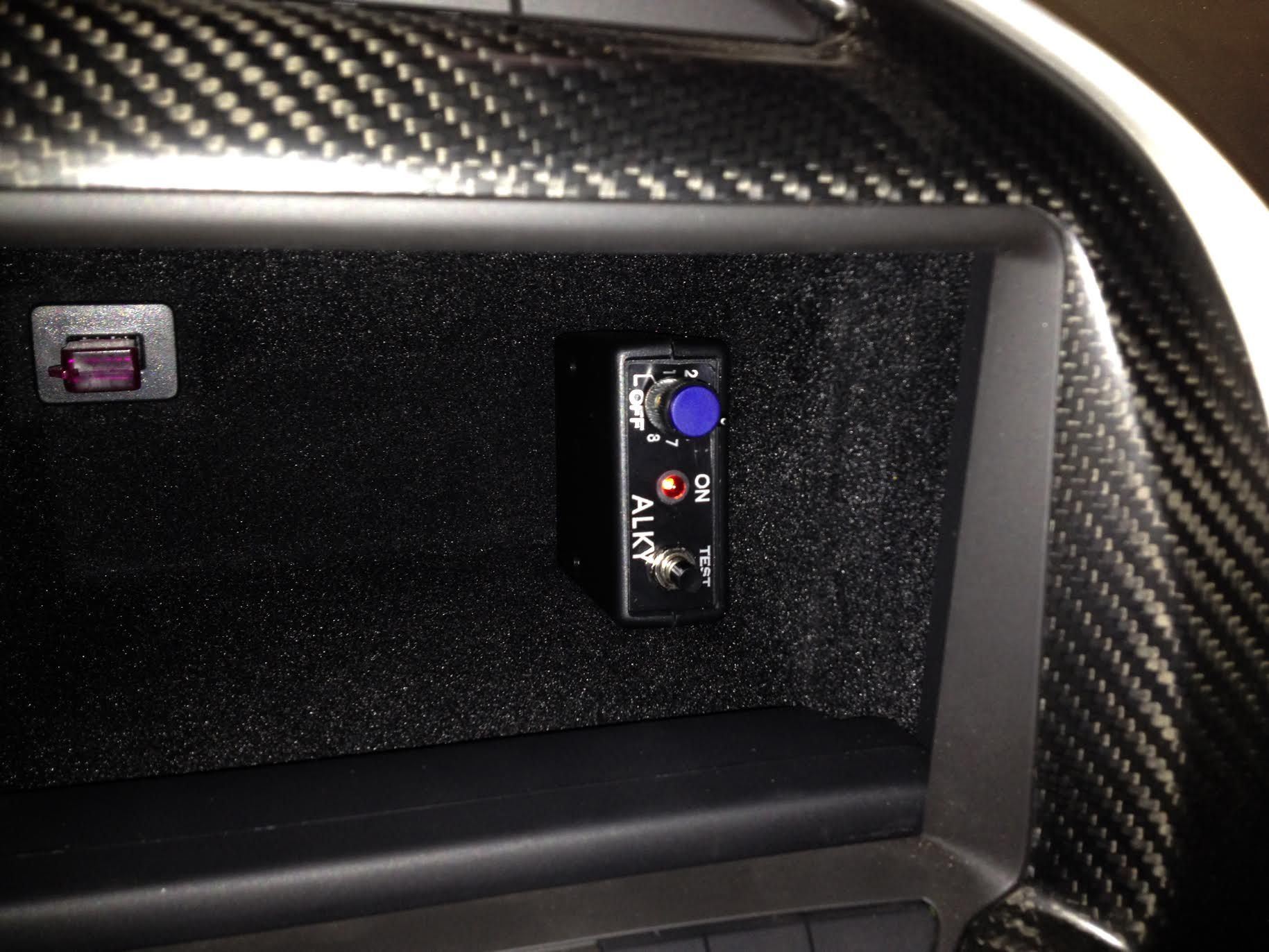

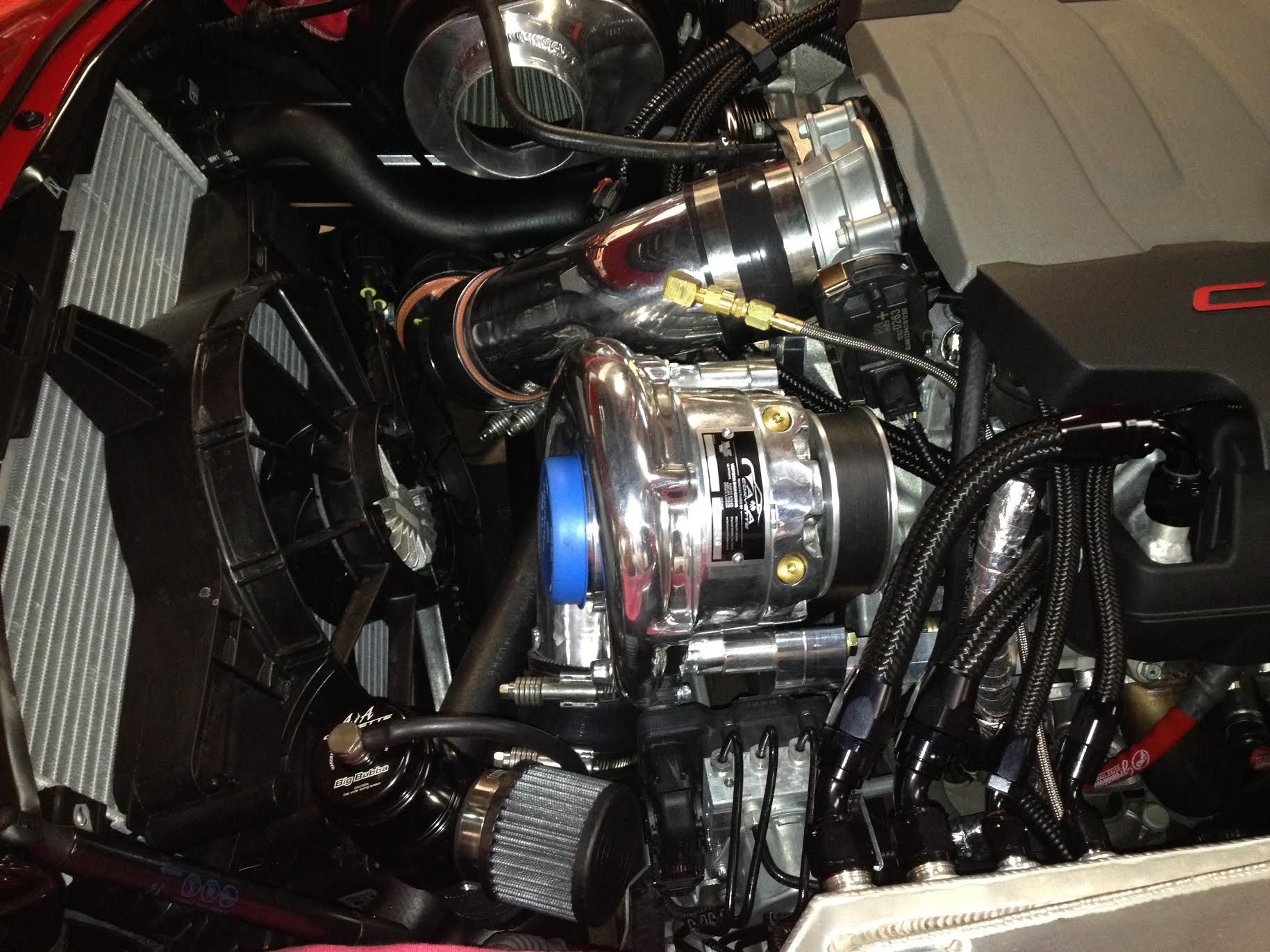

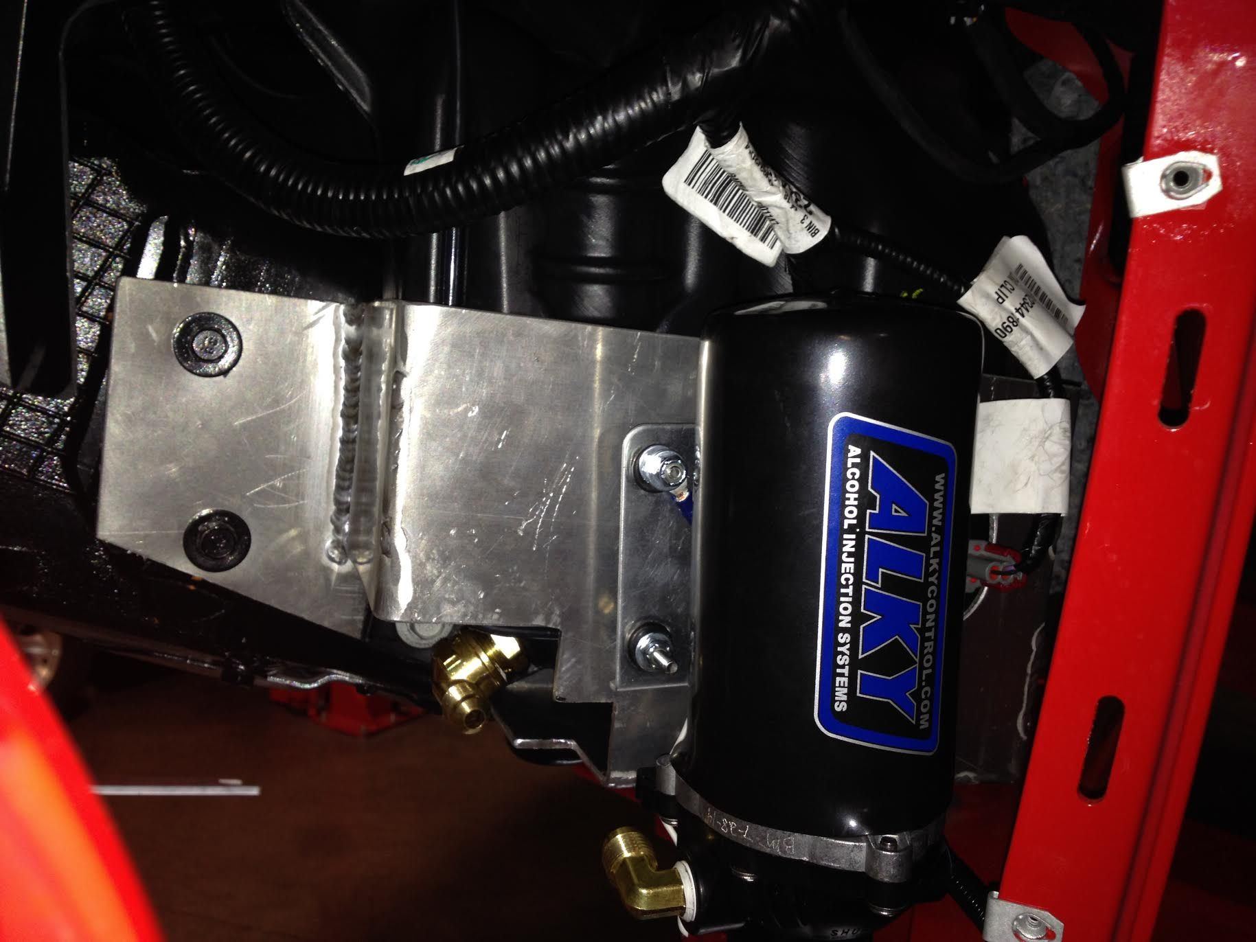

Some installation progress images showing the application nozzle, location of the controller in the "secret squirrel" compartment and custom mount for the pump/tank caddy for a more durable solution (vs attaching the pump directly to the vehicles composite structure)..

Sweet mount, how much did that cost you?

Where is your iat sensor in the charge pipe?

Not sure yet what the bracket/mount runs (bill to follow) ;-)
Installation isnt complete, sensor install, balance of wiring will go in today. Most of the electronics will be hidden under the passenger side comparment.
