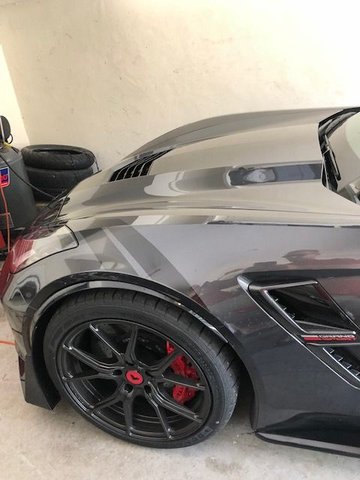

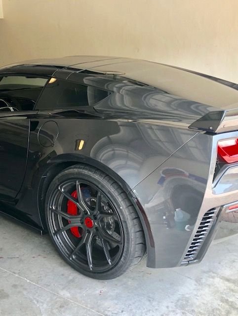

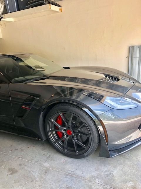

I ran 265/35/19 front and 305/30/20 rear Dunlop Sport Maxx Race on my GS. They fit and rode great, a little taller, but narrower than stock widebody tires. Those sizes should be great for 19x9.5 and 20x11
I still have the tires if someone wants to make me an offer, 5 -6/32 of tread left.

Are you guys lowered with these bigger sizes? Would love to see some good pics
