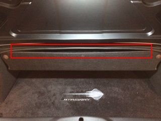

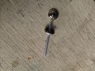

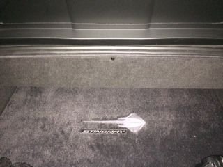

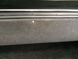

Those of you with convertibles have surely noticed the sagging trunk covers. While these covers play an important role in covering up the convertible mechanism the engineers could have provided a better solution for securing it to car. Below is a simple solution for securing the cover by adding a snap to the center of the cover. The snap kit, rivet gun and other items were purchased at Lowes for just a few dollars. The pictures are self-explanatory for installation.
