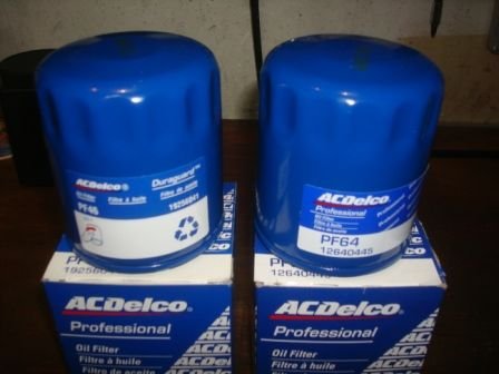

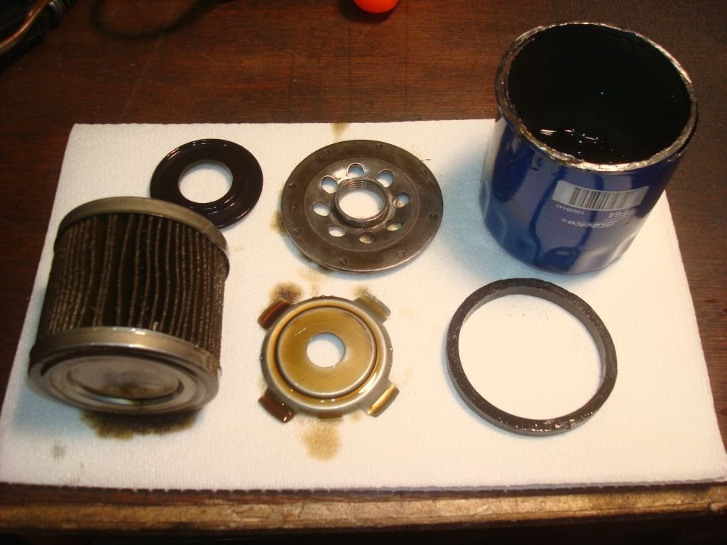

I was wondering what the inside of a PF64 looked like – and the likely hood off metal debris being trapped inside.
PF46 from a Non-Z51 car with about 1000 miles on it.

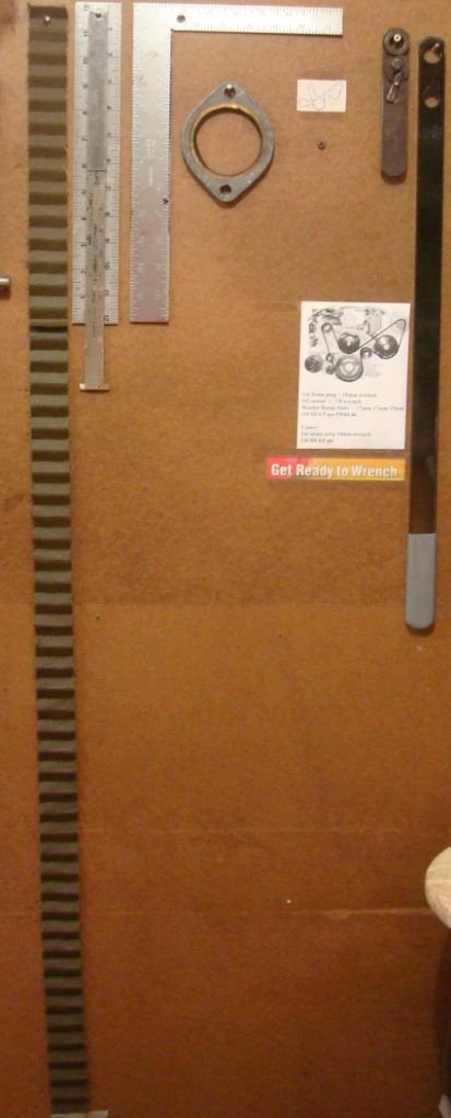

The filter media was about 4 feet long and 1.75 inches wide.
Just clean oil in this one, no traces of metal – but I didn’t send out a sample to Blackstone.
sorry about the large images...

Just a quick correction. The filter is a PF64, not a 46. I see the correct filter in the pics, but somebody might see this thread and think they are using the wrong filter.
S.

THANKS!!
I will see if the mods can change the title. I had 46 on the brain from the C5.
They are very similar......
