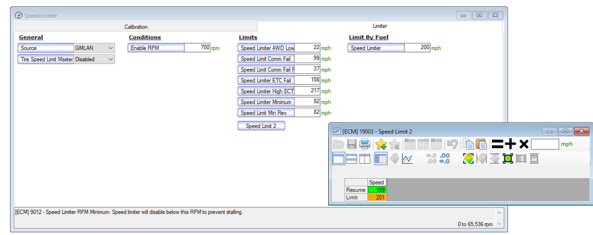

My friend had his 2014 base convertible tuned by an experienced Corvette tuner that he has used for years. He had more than 500 miles on the car. The tuner told him there was a factory installed speed limit of 135 mph in the factory setup. He changed the limit to a much higher number.
Three months later the first car was rear ended and totaled. He bought another 2014 base convertible. The tuner found the same speed limiter in the tuning for the second car.
I have never heard of this limit before. I am expecting to take delivery on a 2015 Z51 in a few weeks. After break in I will be running way over 135 mph in HPDE and open road events. I do not want to get to the race and find out I can't go over 135 mph.
Has anyone else experienced a limit setting like this?

There are parameters that can limit the speed to 135 but I believe there are also controls in the BCM or CCM that tuners do not have access to.
Under normal operating circumstances, it appears these limiters do not affect top speed. However, they can still be disabled in the tune.
