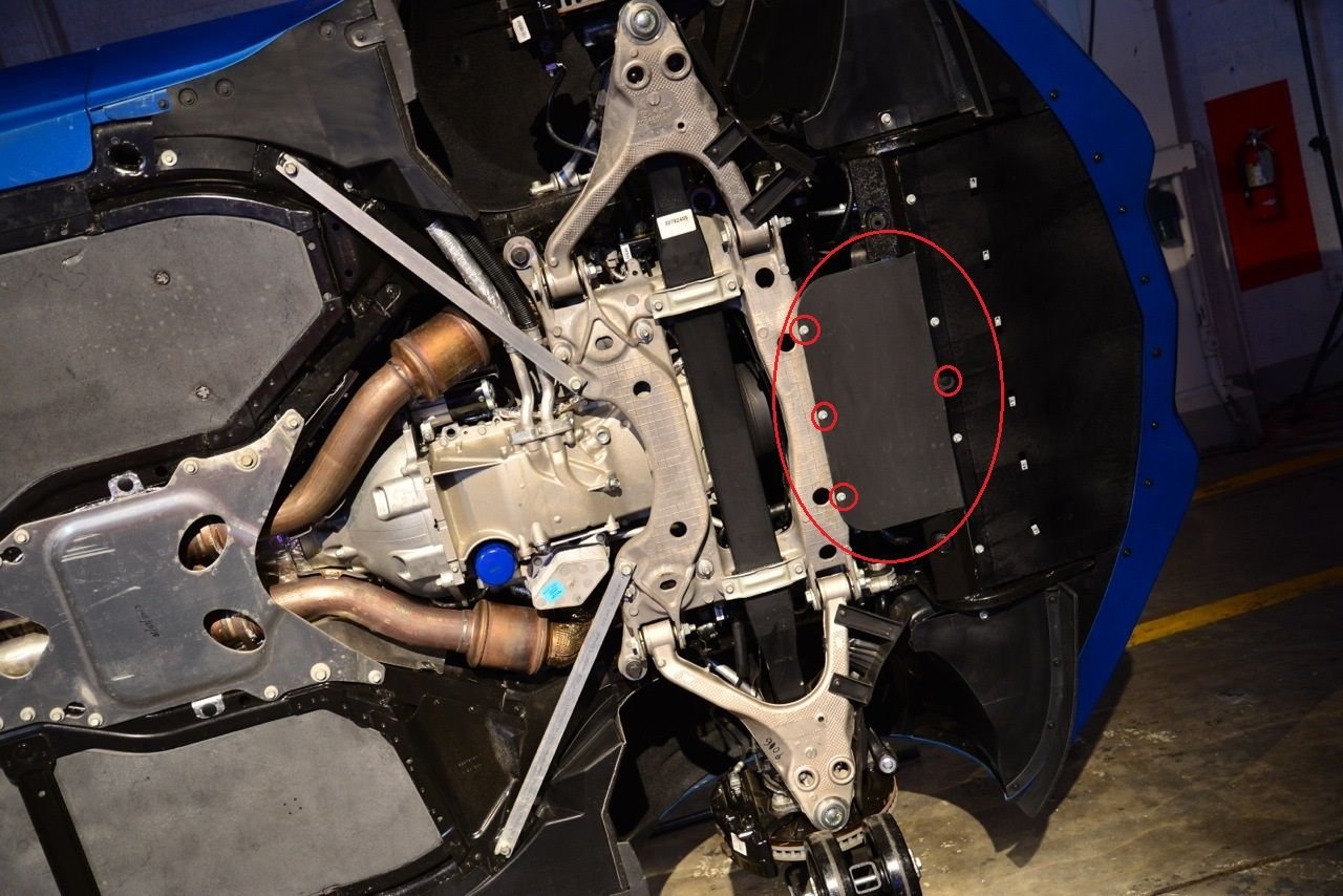

So in the process of disassembling I noticed that the center deflector doesn't appear to have ever been installed along with the hardware that would have held it on. Here is a car with it.
The missing piece plus the 4 missing fasteners.

Back to the missing central deflector, I contacted the local dealer and was told I should have spotted that upon delivery, and it would not be covered under the warranty, I suppressed the urge to flip the desk over and calmly walked to the parts department to be told it would be $150 before tax to get the deflector and fasteners. So I contacted the original salesman that sold me the car to give him the chance to make things right, I'm waiting on a return phone call. If that option fails I'll be getting a hold of Chevy directly, $65,000 cars shouldn't have missing pieces. Anyone else with have this problem?
